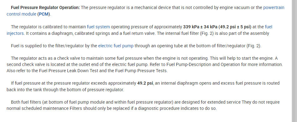

Rough idle, sluggish when accelerating, bogs down.
Trying to replace this myself just need to know what to do.
Jun 12, 2021 at 6:51 AM

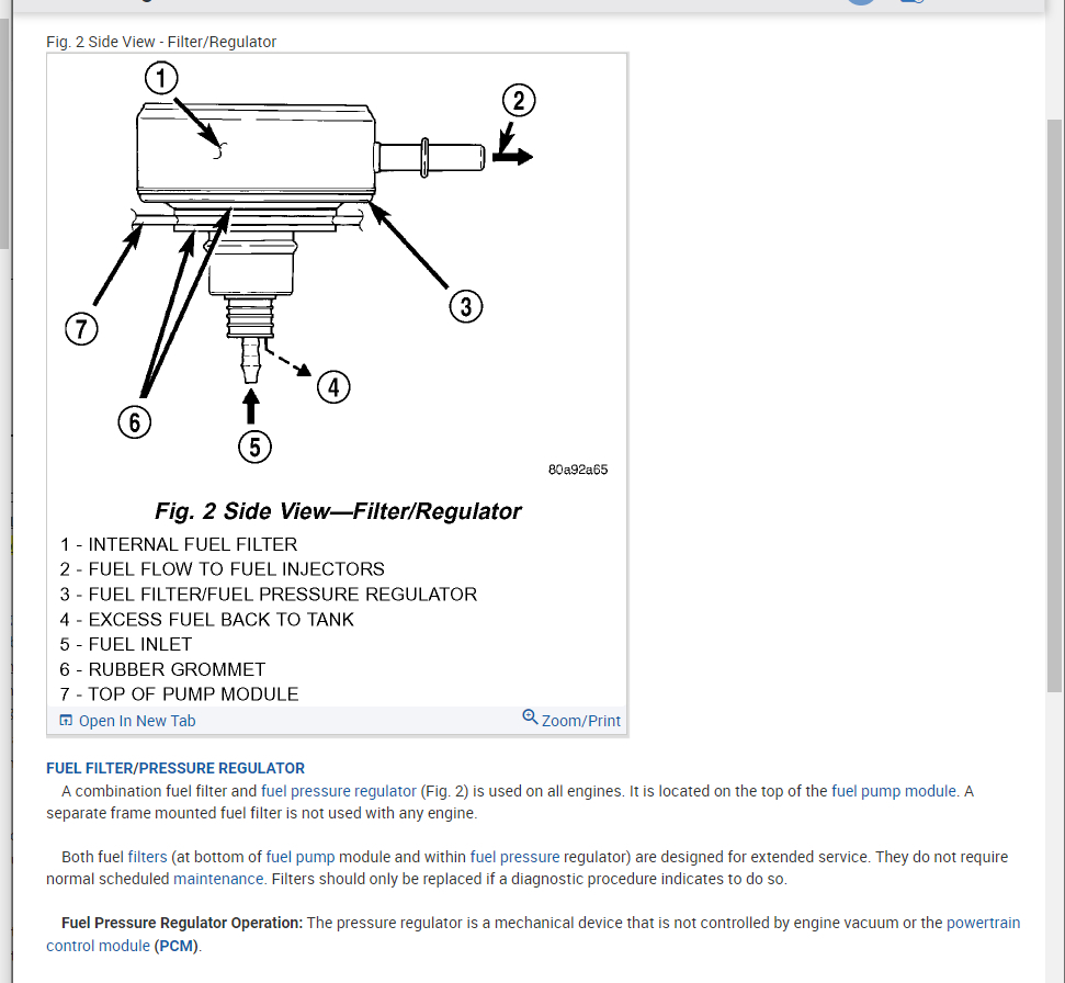

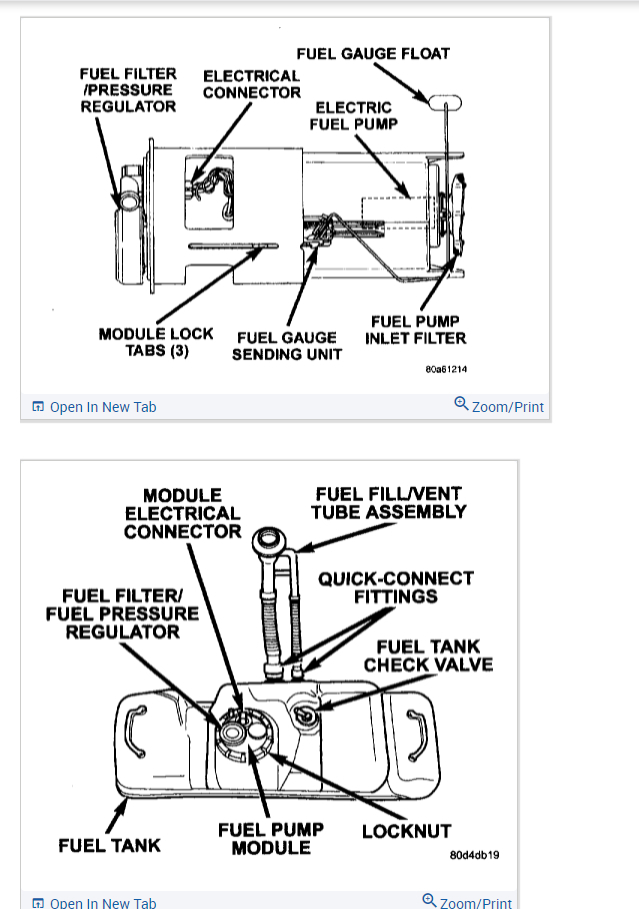

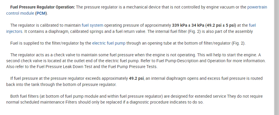

This truck does not have an inline fuel filter. It actually has two filters but not a traditional inline filter.
It has a strainer on the pump and then a filter in the regulator. I attached the info below on all of this.
However, you could be correct that this is a fuel issue so we need to start with checking the pressure.
Here is a guide that will help with this:
Please run through this material and let us know if you have other questions and what you find. Thanks
