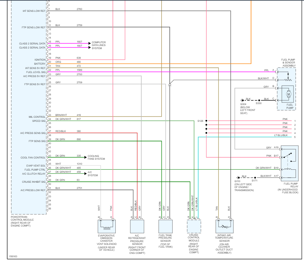

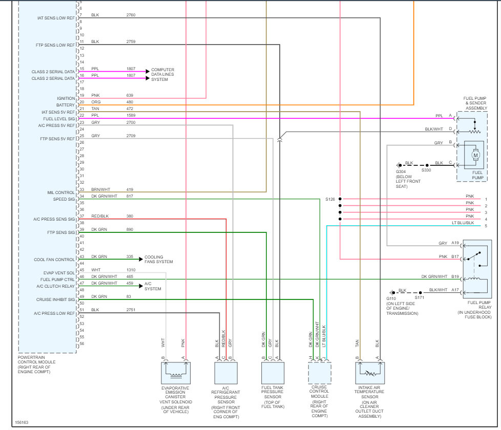

I read that you answered about the wiring at the relay, specifically the green with white tracer. It should get power while cranking. You said it's the signal wire to the PCM. My question is, why would that wire get power all the time?
Feb 11, 2023 at 12:18 AM
  • 55,740 POSTS

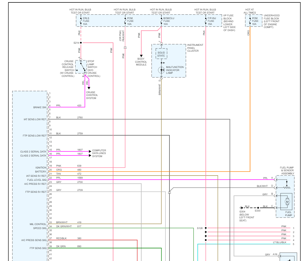

The green/white wire should have power for about 5 seconds when the key is turned on and then hot all the time the engine is running. Here are the wiring diagrams below so you can see how the system works. Let me know if you need anything else.
