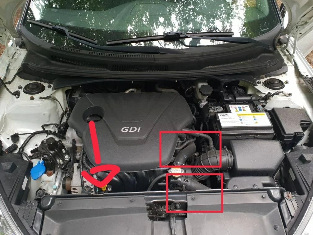

Thank you very much Alex for keeping up with me. Regarding the thermostat I did read your message and went to test the thermostat.
What I did is this the car is overnight cold I did top up a little bit of the coolant in the tank less than 30ml. I started the car and let it warm up without moving the hoses get hard as usual. I will attach a picture of the hoses the ones with a rectangle are hard and hot after some time the one down with the arrow it's down where the thermostat is connected is hard, but not hot. i lit the car warm up to temperature up to 83c on the obd2 scanner and still the the houses with the rectangle hard and hot and the one down hard but not hot. i did move with the car for a test drive for 3 minutes and parked check the hoses the ones with the rectangle are still hard and hot the one down are hard and hot now. so I don't know but this means the thermostat did open right? And the coolant is flowing right? But still the houses are hard. Let's say that the thermostat is bad or something wouldn't I have a overheating issues? I don't at all after I changed the thermostat and did the flush and changed the coolant and changed the cap I don't have issues with overheating.

SCGRANTURISMO
  • 4,897 POSTS
Okay, let's start from the beginning. Is your vehicle overheating?

I'm not sure what it means when it turns blue, but given the fact that it didn't turn yellow and that your vehicle's age isn't that old, you don't have a blown head gasket or cracked cylinder head or block. So you can rule those out. If your vehicle isn't overheating, then this is probably normal behavior for your vehicle.
