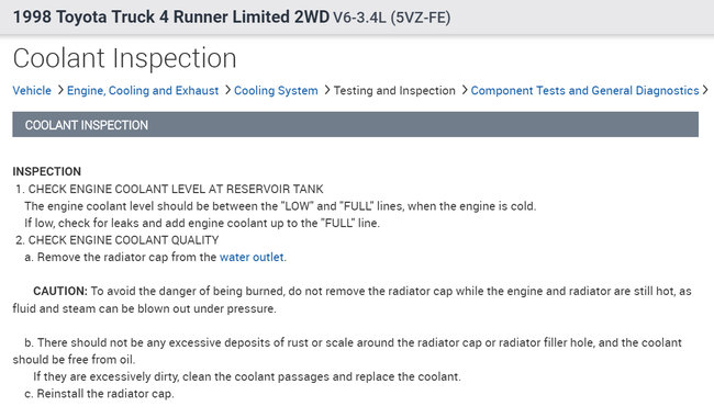

I recently know noticed that my radiator cap was leaking when my fluid got to warmer when I stop the vehicle. I've been driving for approximately a year without any problems. I tried to drain my radiator fluid and replace my cap with a new cap but the pressure buildup blew off one of my radiator hoses. I reconnect the hose and put the old leaky cap back on it runs fine, it doesn't overheat. there's nothing in my oil, but there's still a problem. could you please help me? thank you

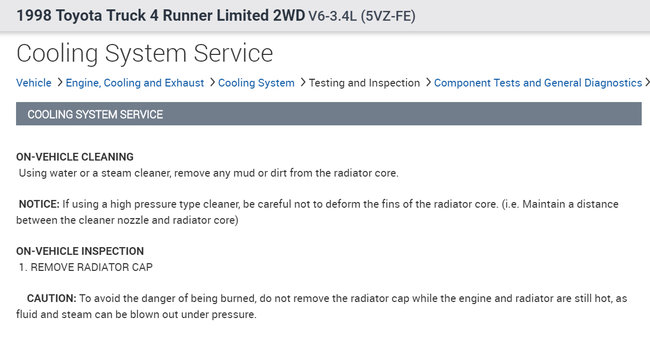

Make sure that you are using anti freeze in your cooling system, if not some times you can have steam build up in your system causing problems like this. I have included Cooling System diagnostics from the vehicle manufacturer in the diagrams below. Let us know if there is anything else we can help you with.
Thanks,
Alex
