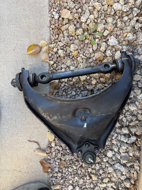

Pic
Sep 14, 2026 at 12:50 PM
FLOATR925
  • 163 POSTS
I tried to load pics but had trouble.
I have access to a vice to use.I tried a different C clamp but can't position it evenly, with that middle mount bar in the way..

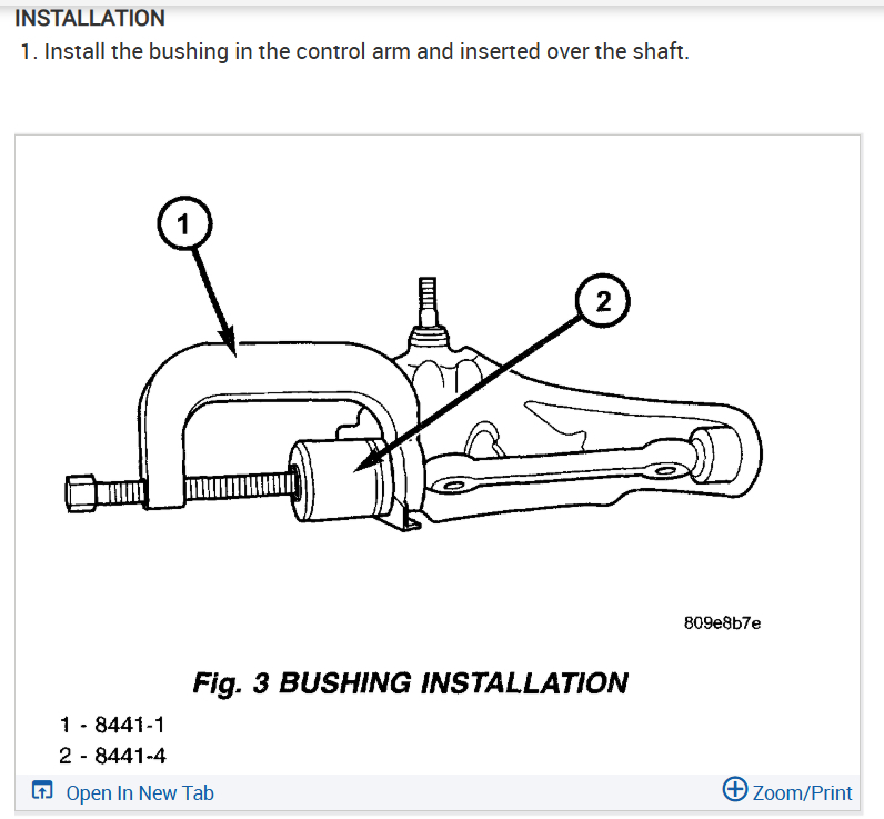

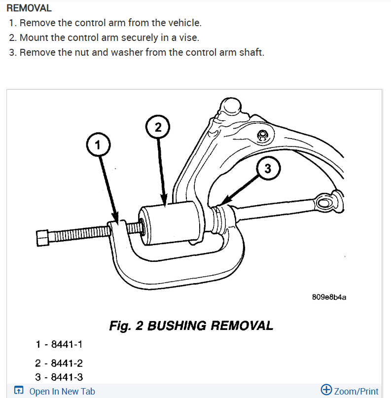

The image upload works okay, it would help if I can see what you are doing. I would not use a puller. Most of the time they sell the upper arm complete FYI. Here is how the manual tells you how to do the job.

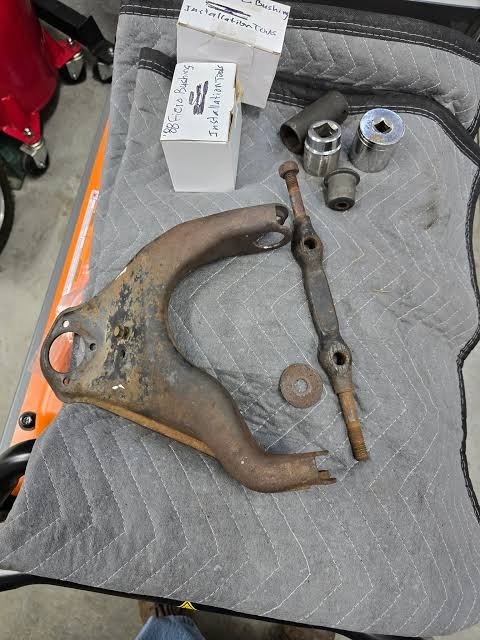

Yes that tool has a C shaped top ..all the ones you rent have a O full circular top an can't get down in the inside where that bar is.
Ill get pics

FLOATR925
  • 163 POSTS
Still trying to load pic

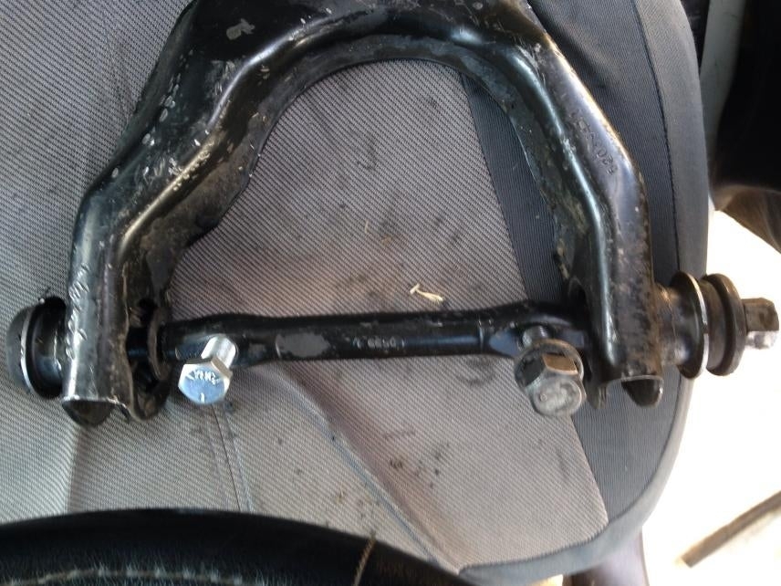

FLOATR925
  • 163 POSTS
Sep 15, 2026 at 1:14 PM
FLOATR925
  • 163 POSTS
..I got mine on a vice to hold it too.

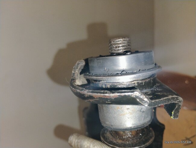

FLOATR925
  • 163 POSTS
Before pic
Sep 19, 2026 at 8:18 AM
  • 55,770 POSTS
The new bushing looks like it is in a bind (crooked), this is why it is not going together correctly.

FLOATR925
  • 163 POSTS
There was no way to stay fully in the center so it did 1 side more than the other but I turned it to opposite an repressed...
