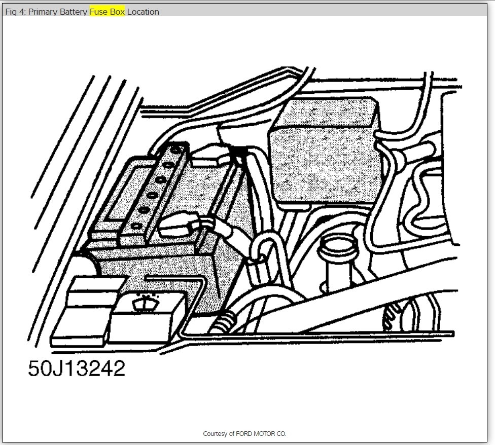

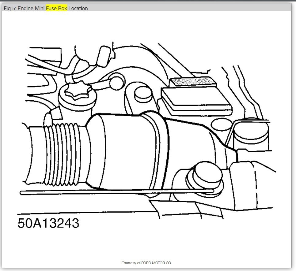

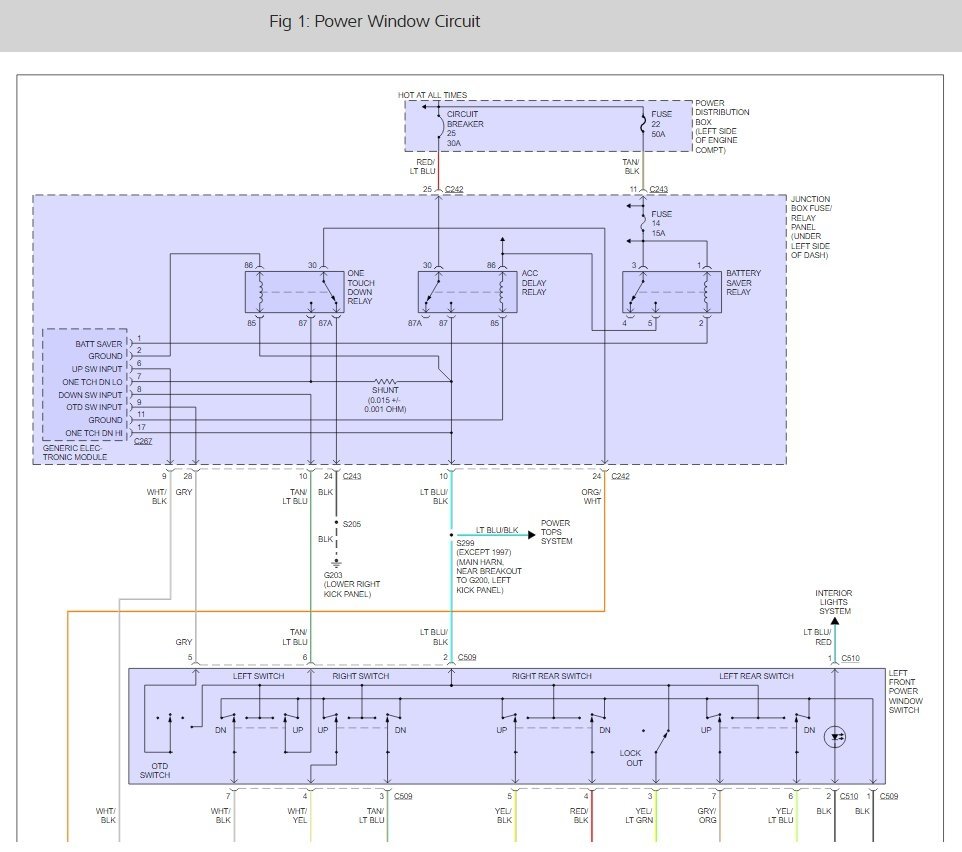

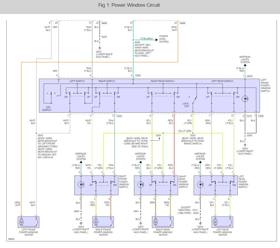

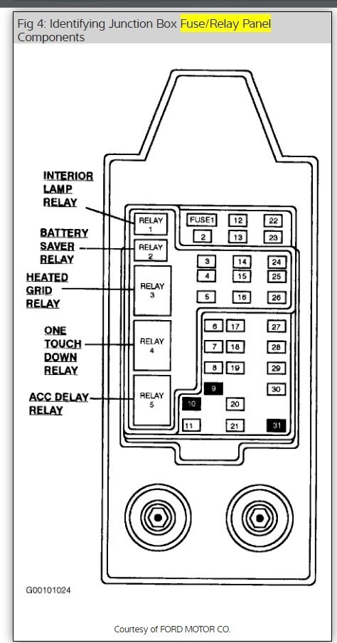

None of my power windows work. where is the fuse for power windows located?
Jun 27, 2017 at 4:11 AM
  • 55,441 POSTS

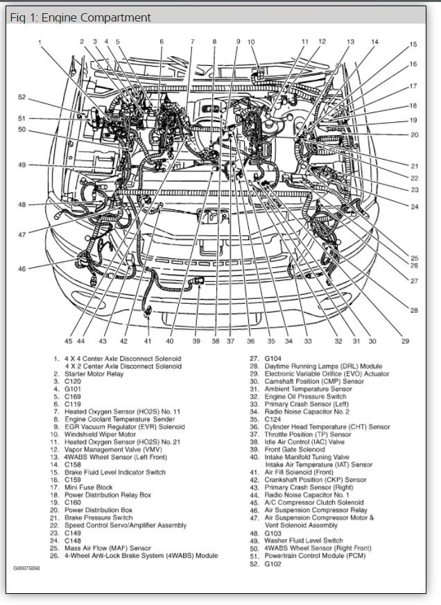

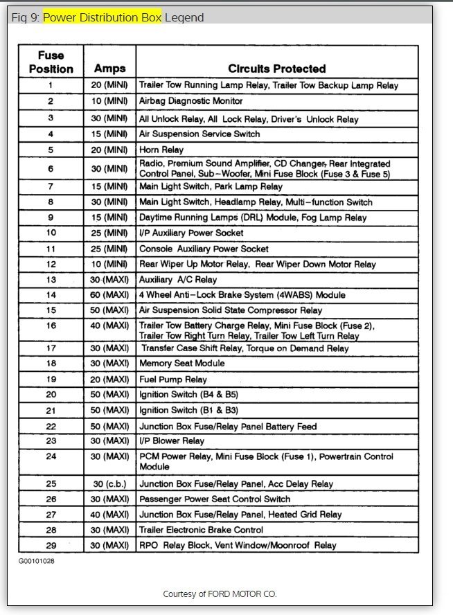

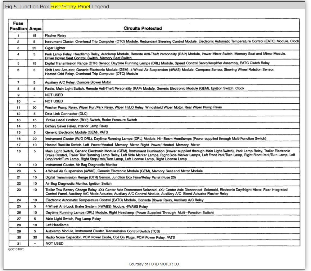

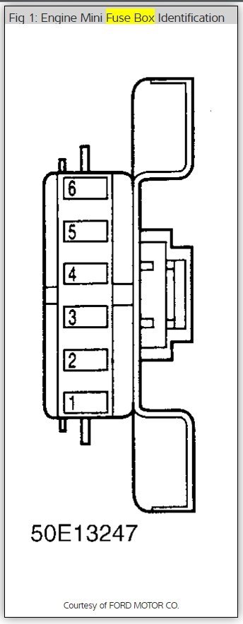

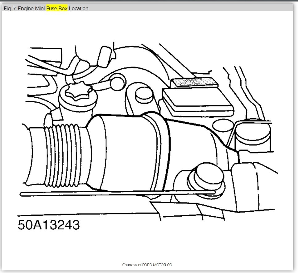

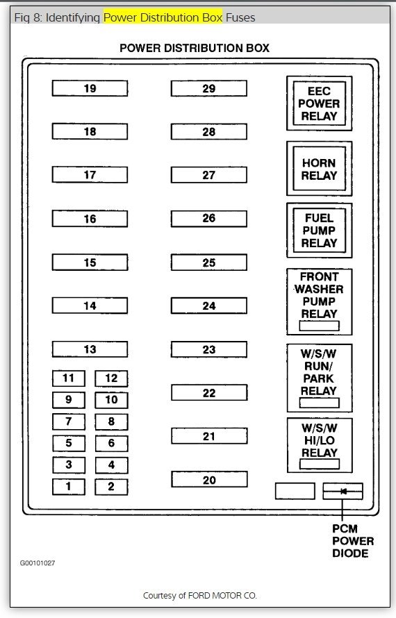

There are a couple of fuses and some relays that run the system. Here are some guides and diagrams (below) to help you do some testing to figure out whats going on.
and
and
1 - 5 Amp Powertrain Control Module
2 - 20 Amp Trailer Tow Stop/Turn Lamps
3 - 10 Amp Audio Rear Integrated Control Panel, Compact Disc Changer, Radio
4 - 10 Amp Running Board Lamps
5 - 20 Amp Amplifier, Subwoofer Amplifier
6 - Not Used
Please run some tests and get back to us we are interested to see what it is.
