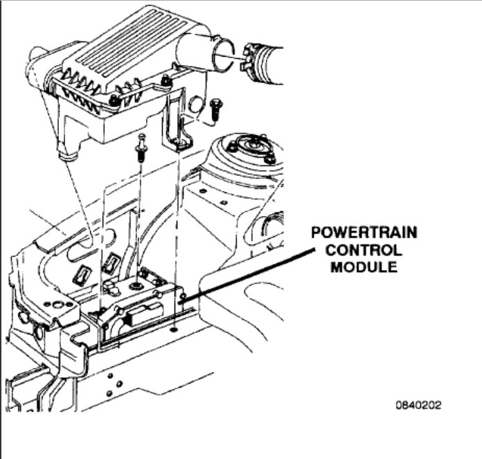

BREEZY WARREN
I know where to purchase this. I need a diagram to locate it on the car.
May 11, 2018 at 5:51 AM
  • 55,224 POSTS
It looks like the PCM is located under the air box here is a diagram to show you (below).

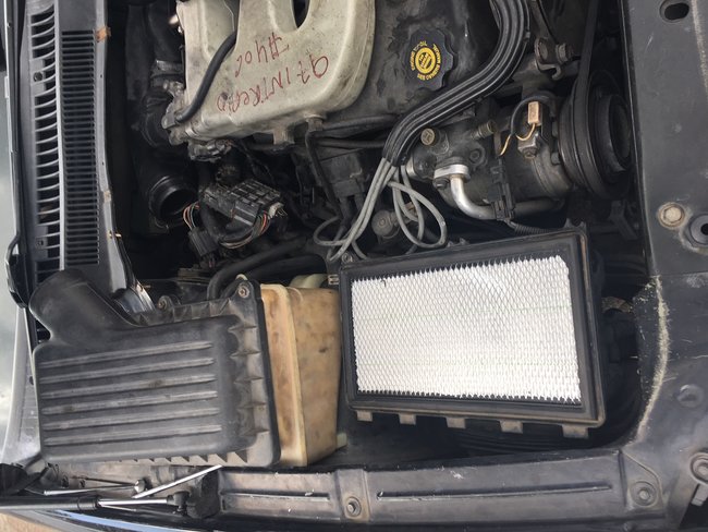

BREEZY WARREN
Here is the image of my intake:

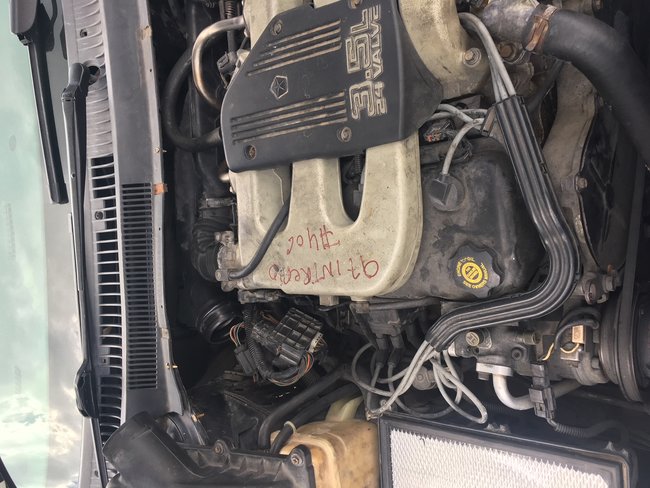

BREEZY WARREN
This another one.

CARADIODOC
  • 34,367 POSTS
For years, Chrysler put their engine computers on the left side, (driver's side), on the inner fender, beside the battery. By the 1997 model year, they were on the right side, as shown in the drawing, on Intrepid's and Concorde's. You might have a mid-year model that was built as a 1995 or a 1997, so check both places. We had a 1994 Intrepid that was used to test a new assembly line, then Chrysler donated it to my community college. That one had the computer on the driver's side. I built a lot of electrical "bugs" into that car and I was very familiar with it. Some parts of that car were built as a 1995 model.

BREEZY WARREN
Well I talk someone today they said the PCM was under the airbag and the ECM is by the battery on the right side by the fuse box.
May 13, 2018 at 3:34 AM
  • 55,224 POSTS
Did you remove the air cleaner housing it is under that.
