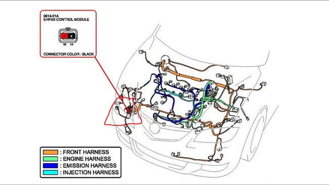

I just installed 2006 Mazda 2.0 engine into my 2007 Mazda 3i 2.0.
I replaced rack and pinion and bled the system and installed a filter in the line in case there was anything foreign in then existing system, I started the car it fired up immediately and the yellow steering wheel light came on, I added more fluid ad I continued bleeding the system , I had the cap off and turned wheel partial one way to other way as the manual specified. I've tried PILKINGTON fuse and negative terminals to reset the computer, I pulled both sides off battery ,hit the brake pedal 5 times and waited 15 minutes as another person had done in the past but I got nothing. my power steering doesn't want to work until your moving, turning around there is no assist. if you have any answers that will help I greatly appreciate it.
Jun 15, 2020 at 6:30 AM
  • 110,244 POSTS
When you reinstalled the new engine, was the EHPAS (electro hydraulic power assist steering) module reconnected? If it was, do me a favor. Disconnect it and see if there is any difference in the assist.
I attached a pic to help you locate it.
Jun 15, 2020 at 1:34 PM

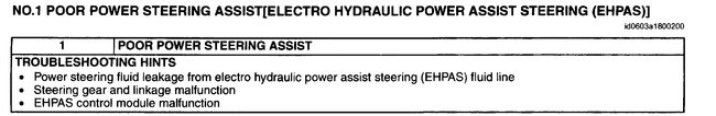

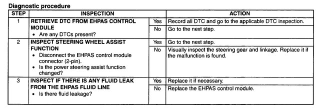

Sorry to ask this, but I need you to have the computer scanned for diagnostic codes. When I check simply under poor assist, here is what it gives me. See the two pics attached.
_____________________
2007 Mazda 3 L4-2.0L
No.1 Poor Power Steering Assist Electro Hydraulic Power Assist Steering (EHPAS)
Vehicle Steering and Suspension Steering Testing and Inspection Symptom Related Diagnostic Procedures No.1 Poor Power Steering Assist Electro Hydraulic Power Assist Steering (EHPAS)
NO.1 POOR POWER STEERING ASSIST ELECTRO HYDRAULIC POWER ASSIST STEERING (EHPAS)
NO.1 POOR POWER STEERING ASSIST [ELECTRO HYDRAULIC POWER ASSIST STEERING (EHPAS)]
No.1 Poor Power Steering Assist [Electro Hydraulic Power Assist Steering (EHPAS)]
Pic 1
Diagnostic procedure
Step 1-Step 3
pic 2
__________________________________________

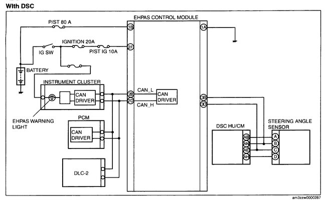

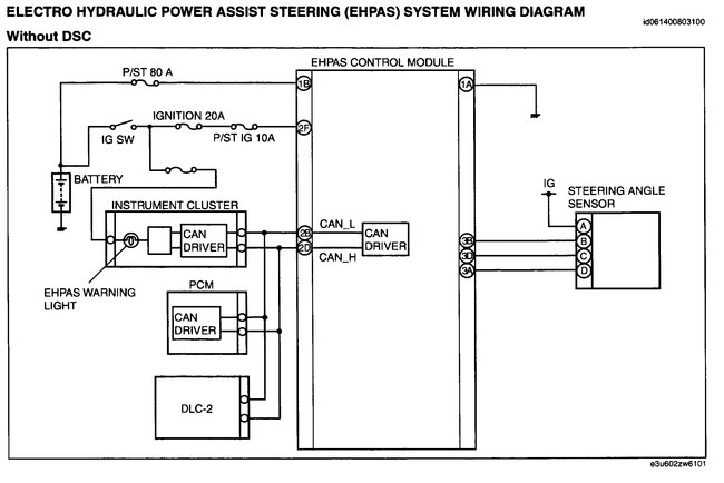

However, there are several codes that correlate with this system. What I can tell you is that the EHPAS is part of the can system in the vehicle, so anything could have happened. If you look at pics 3 and 4, it shows the wiring schematics and how it's tied into the CAN system. In this case, either you need to have the EHPAS module scanned or better yet, the CAN bus system scanned. Here is a video showing how that is done:
https://youtu.be/InIlnsjOVFA
Do you have access to a scan tool that can interface with the module or scan the CAN bus system?
