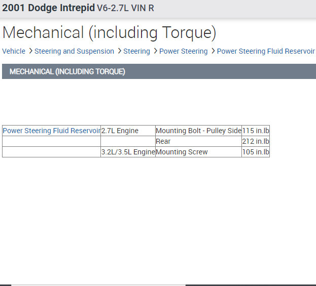

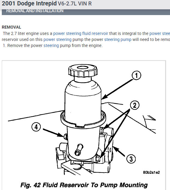

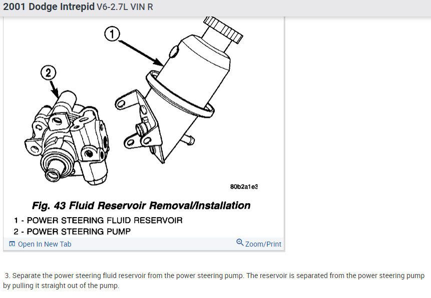

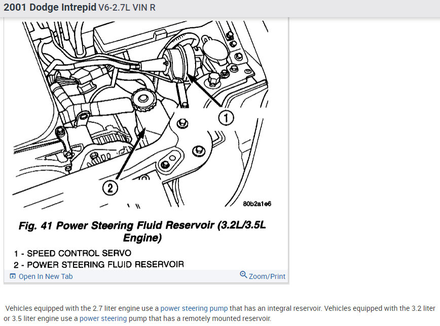

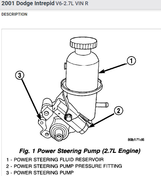

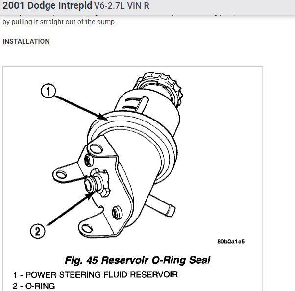

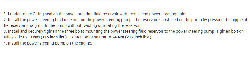

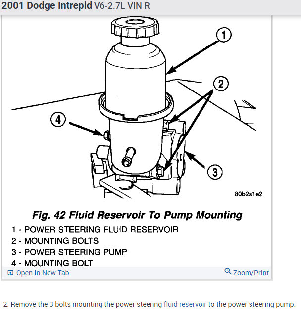

I need instructions on how to remove the reservoir.
Wednesday, July 21st, 2021 AT 1:40 PM
SQM
  • 6,383 POSTS
The power steering pump reservoir removal is fairly easy process.
Just make sure to siphon out any fluid form the reservoir, this will help you keep down the amount of fluid might get spilled. After replacing the reservoir be sure to add fluid as the car runs. You might want to turn the steering wheel back and forth to help cycling of fluid.
https://www.2carpros.com/articles/power-steering-fluid-flush
https://www.2carpros.com/articles/power-steering-problems
I have attached the replacement procedures below.
