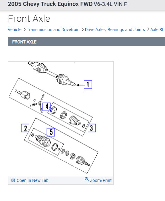

While driving I'll hear a clicking sound and then my steering is stiff, then I'll hear another clicking sound and my steering is back to normal.
Dec 27, 2021 at 9:09 PM
SQM
  • 6,383 POSTS
Clicking sounds while turning typically points to a faulty CV axle.
When the CV boot fails, it allows dirt and debris to enter the joint. Which creates noise along with other issues.
Usually, a leaking boot will have grease coming out of it. And it will likely be on other suspension components.
Inspecting the CV axle would be a good place to start.
Here is a helpful guide:
https://www.2carpros.com/articles/clicking-sound
Please let me know what you find.
