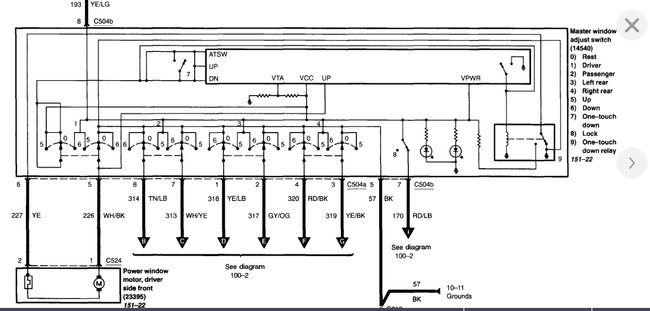

The driver's door power window is not responding. No noise or anything.
I checked the switch (even replaced it) and I am getting 12 volts when I operate the switch. I replaced the motor, but still not working. I pulled the pigtail from the motor and I am getting 12 volts when I operate the switch as well.
Help!

When you got 12 to the motor, did you check to see if it had a ground as well?
It very well may be a bad motor itself.
Also, did you try tapping the motor with a hammer to see if it will run?

How do I check to see if it had a ground? Using a voltmeter, I put the positive on one lead and the negative on the other and then worked the switch. I got +12 volts one way and -12 volts the other.
Can I test the motor by applying ground to the body and power to one of the leads?
Aug 17, 2018 at 12:38 AM
Okay, you did it right with the leads. You have power and ground or you would not show system voltage.
You need a window motor based on those results.
