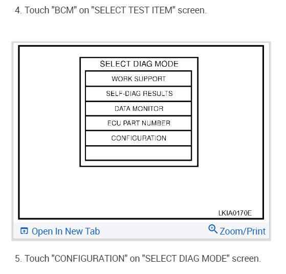

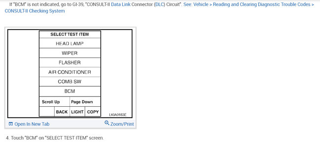

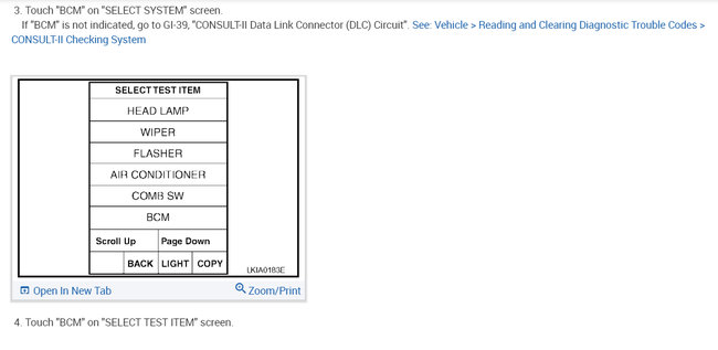

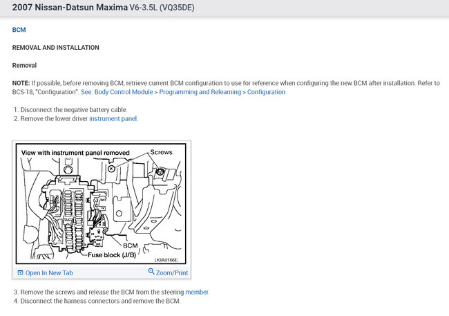

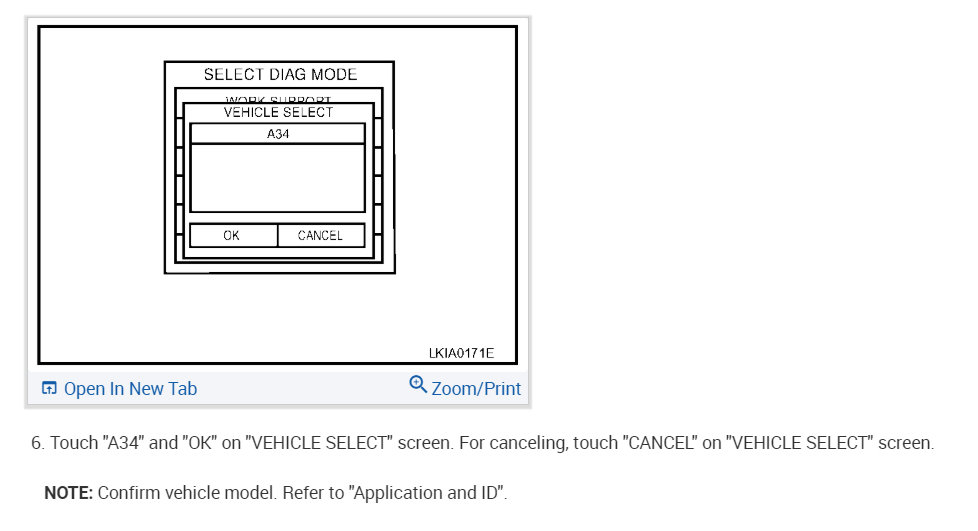

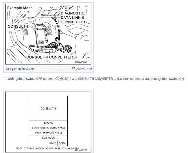

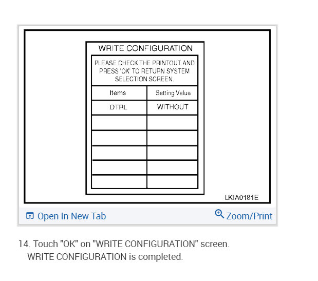

I just bought the car listed above that the two front power windows automatically roll down after I shut off the engine. I've tested the key-less remote and that's fine.
Sep 5, 2019 at 10:24 AM
  • 55,694 POSTS

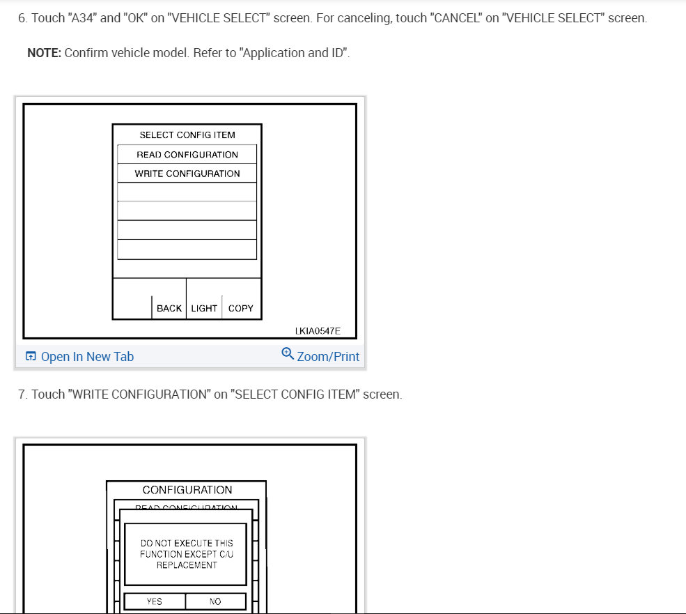

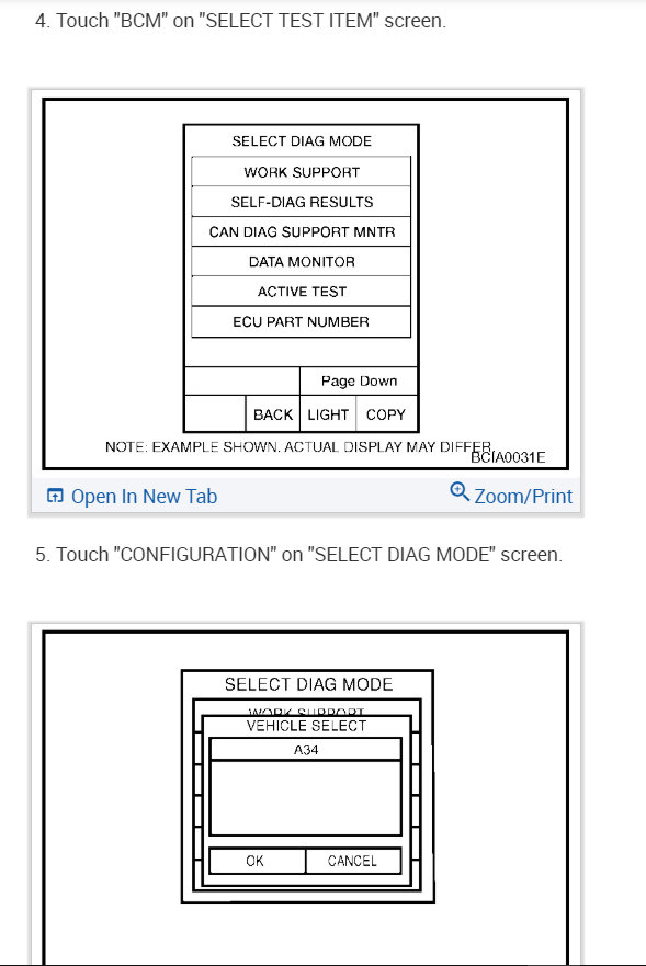

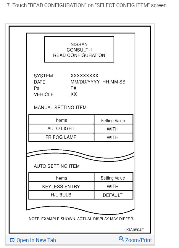

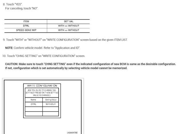

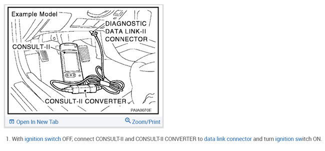

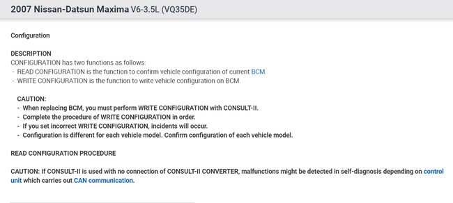

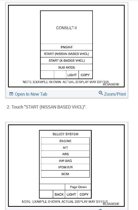

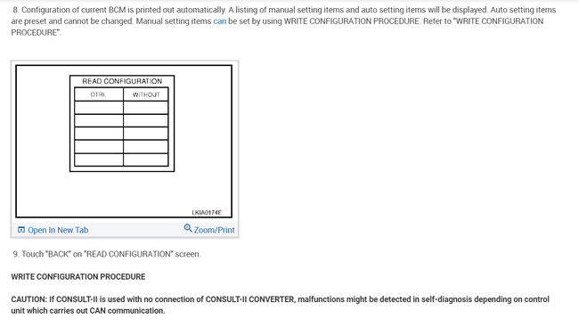

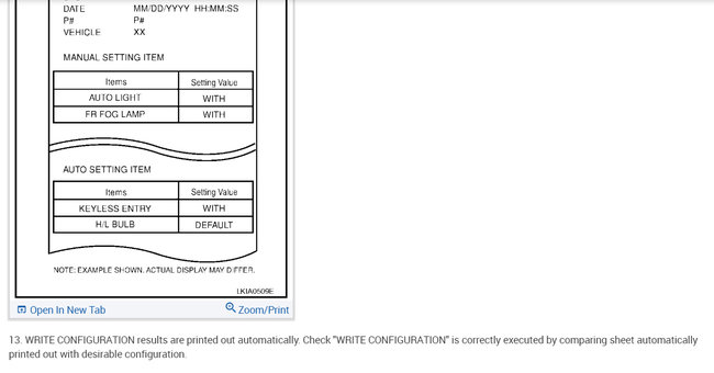

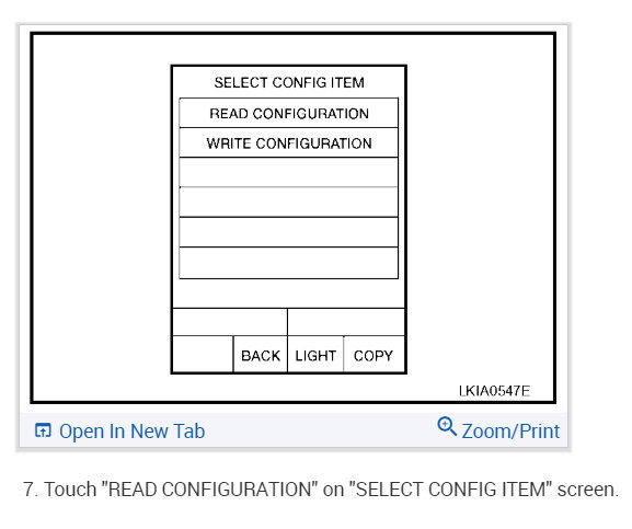

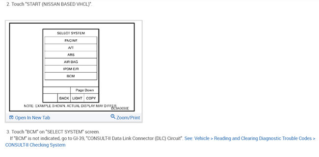

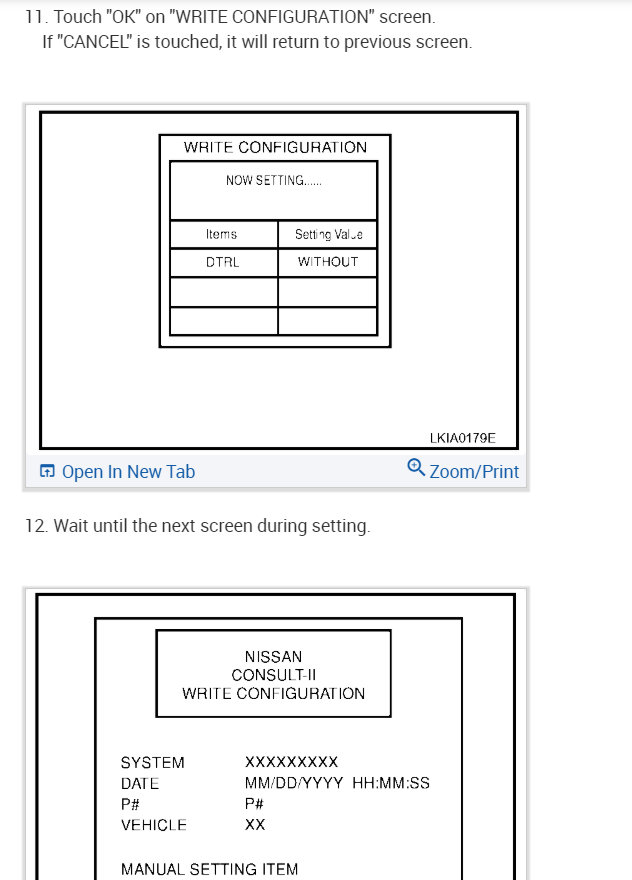

This sounds like the BCM has gone out. To be sure this video will show you how to scan the CAN with instructions in the diagrams below to show you how to replace the BCM for your car.
https://youtu.be/InIlnsjOVFA
