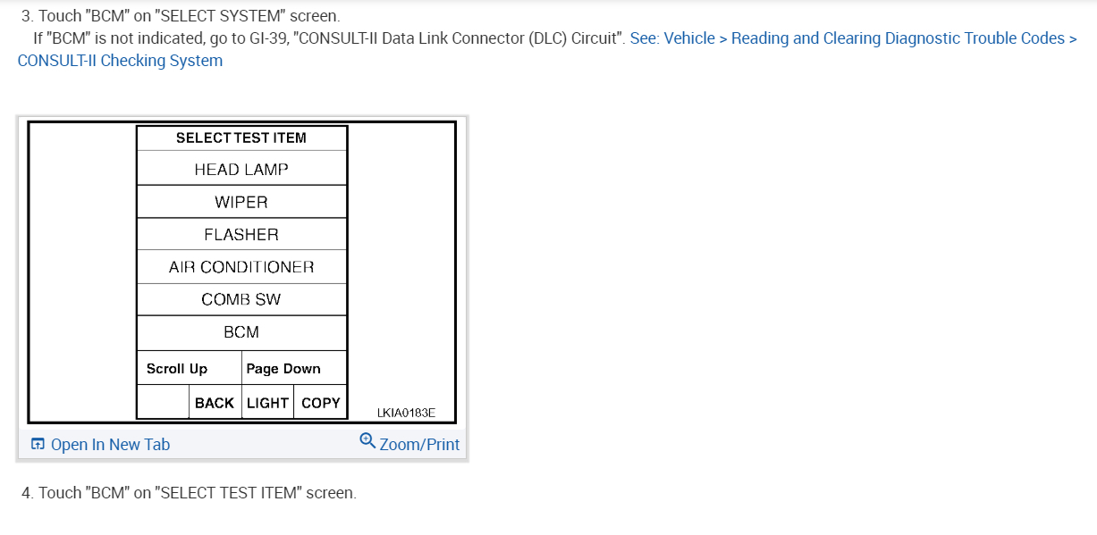

Power windows automatically roll down after I shut off the engine
2007 NISSAN MAXIMA
147,000 MILES • 3.5L • 6 CYL • 2WD • AUTOMATIC
JAVIERP713

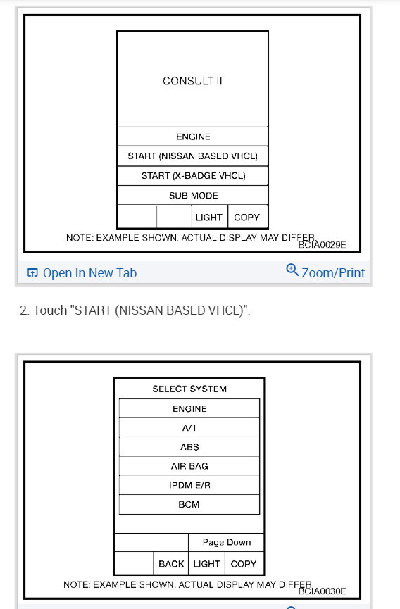

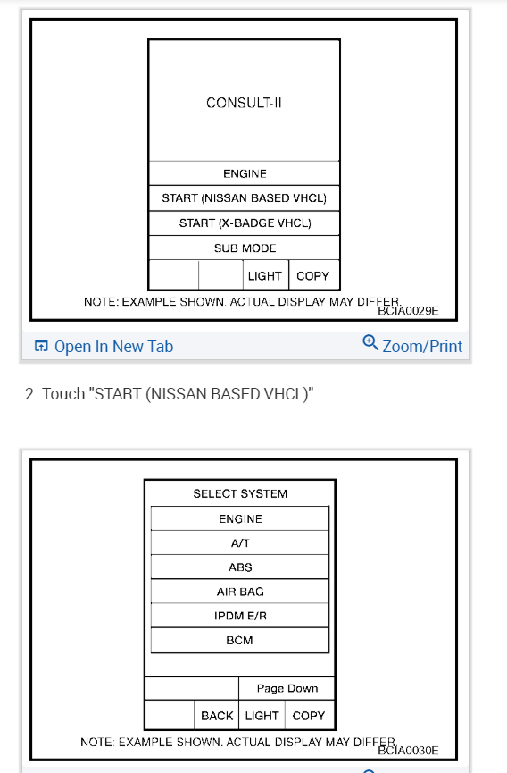

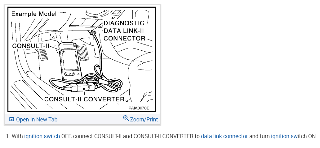

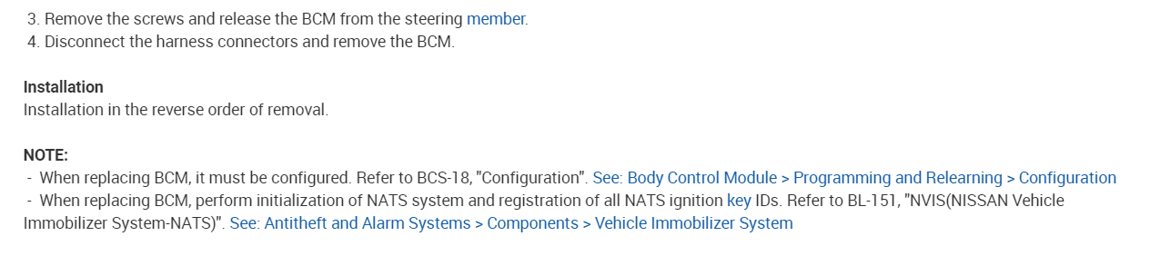

I just bought the car listed above that the two front power windows automatically roll down after I shut off the engine. I've tested the key-less remote and that's fine.
Sep 5, 2019 at 10:24 AM
  • 55,412 POSTS

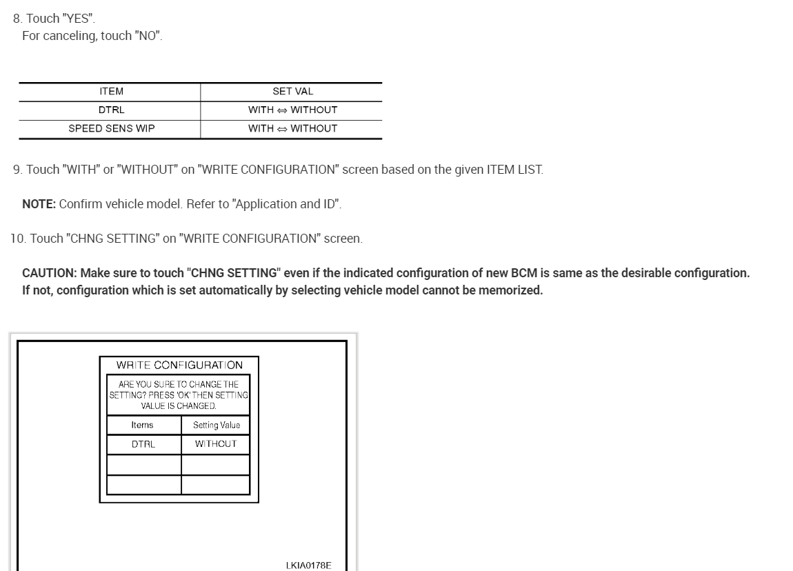

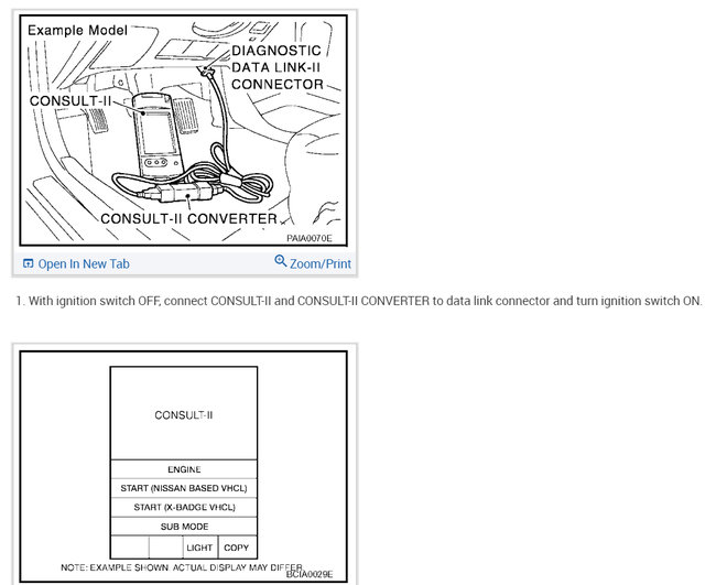

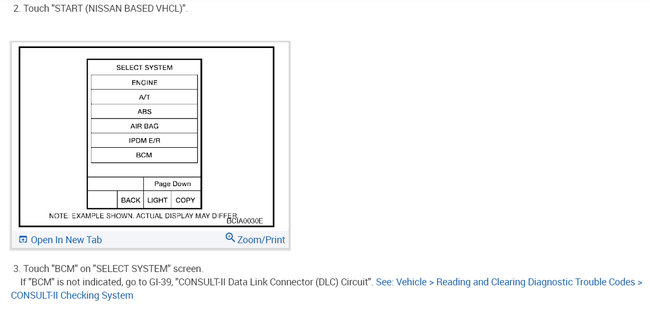

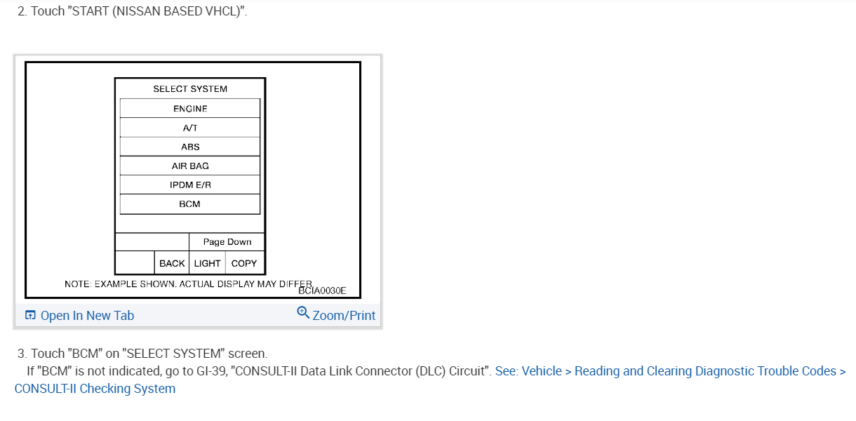

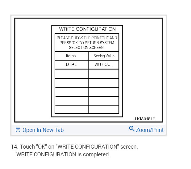

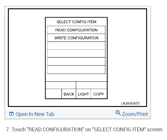

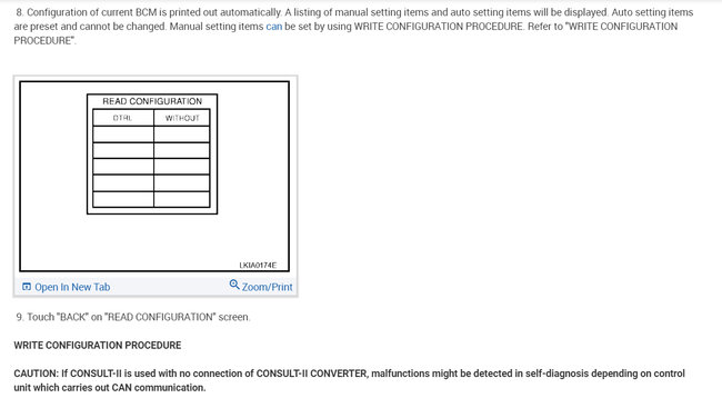

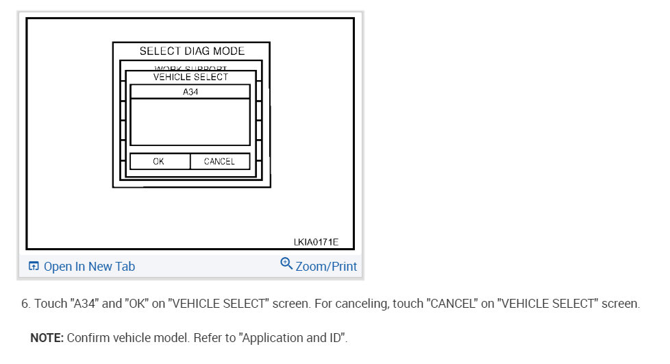

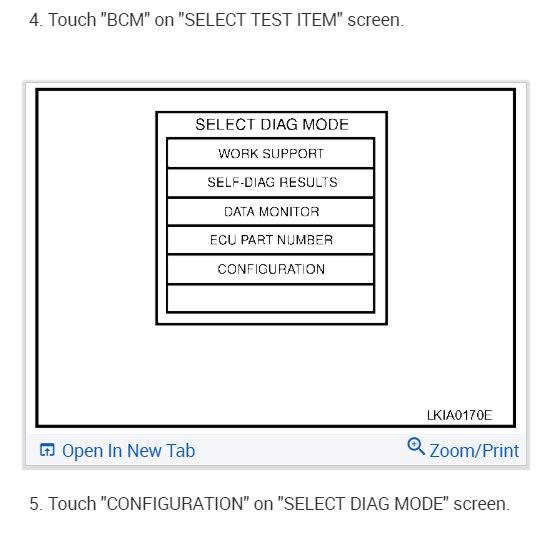

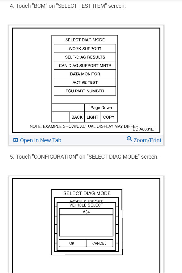

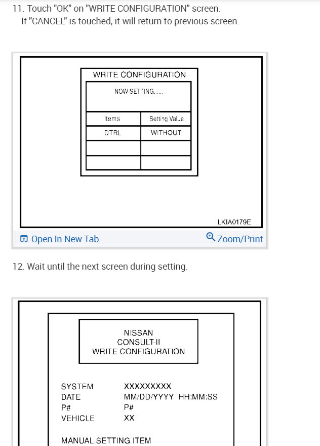

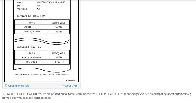

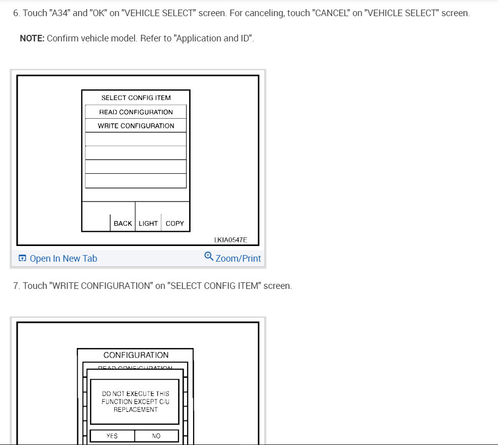

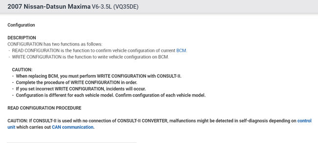

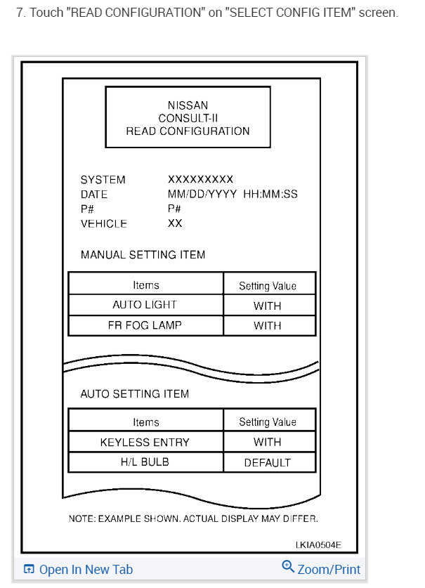

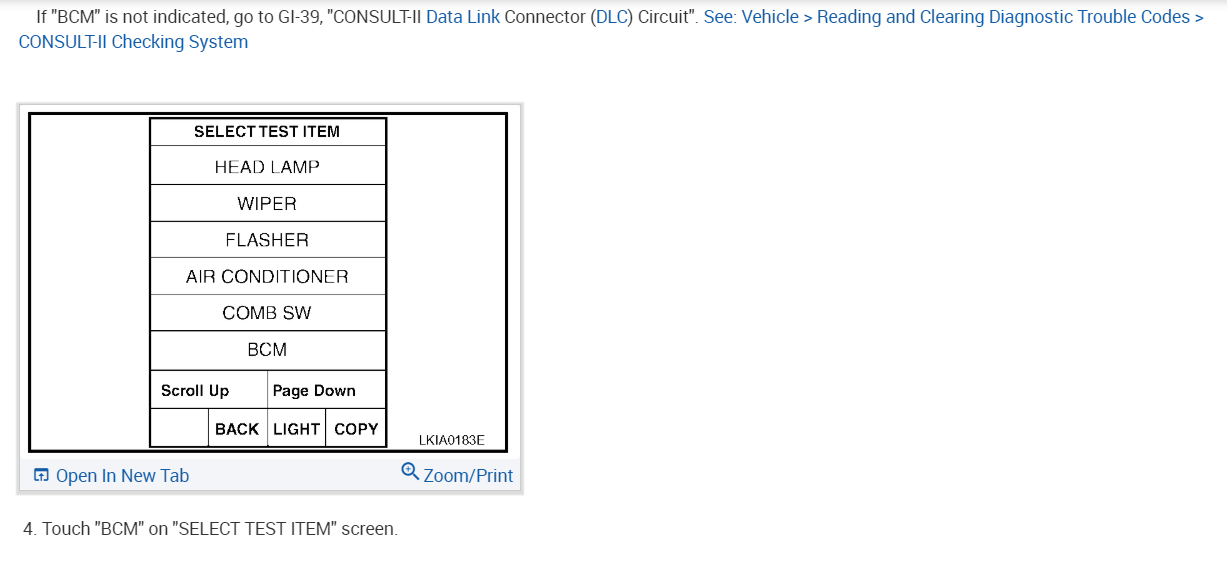

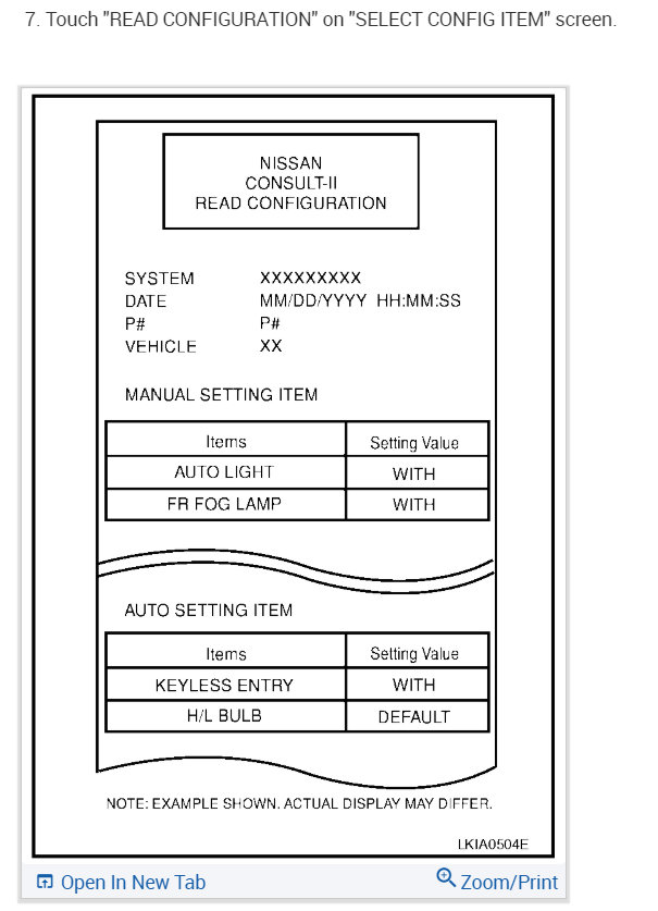

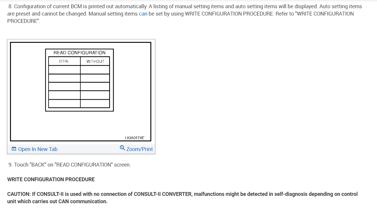

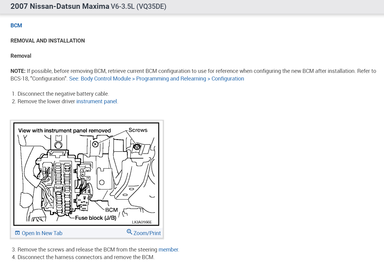

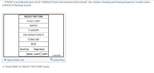

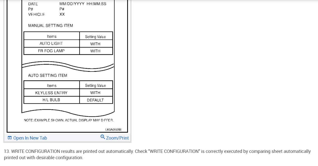

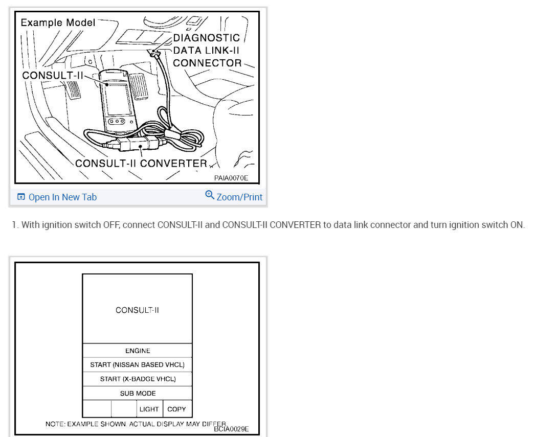

This sounds like the BCM has gone out. To be sure this video will show you how to scan the CAN with instructions in the diagrams below to show you how to replace the BCM for your car.
https://youtu.be/InIlnsjOVFA
Sep 7, 2019 at 6:59 AM
