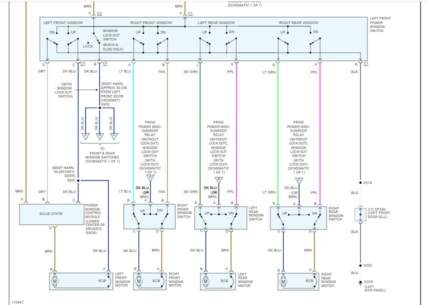

None of the window's work. They quit. Where do I start? Fuses, relays, etc... One motor on the rear driver side is dead, has been for quite some time so it does not matter.
Aug 30, 2024 at 3:20 PM
  • 110,194 POSTS
To get you started, I attached the wiring schematic below. Also, there is a power window relay that is involved here as well as a circuit breaker and a traditional fuse.

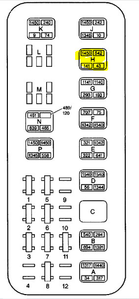

Since this uses a circuit breaker, the easiest thing to do is remove the relay (relay H), and check pin 30 for power.

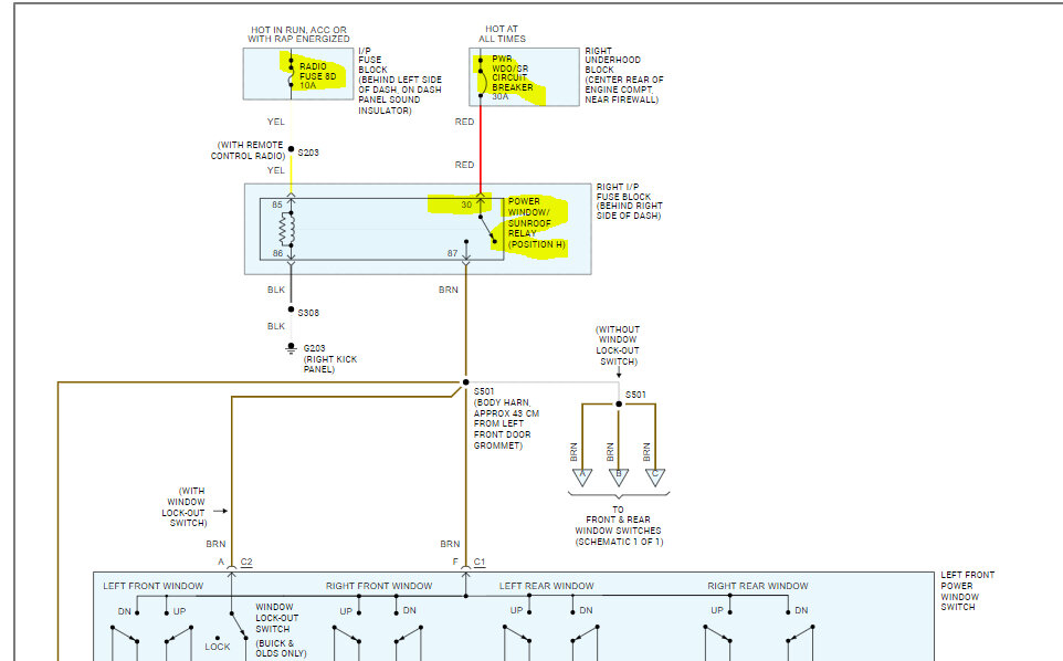

If you look at pic 3 below, it is an enlarged pic of the relay (right side of dash relay box). Note there are 4 numbers indicated. When you remove the relay, it will have numbers on it the same as indicated in the picture. Determine which is pin 30 and using a test light, see if there is power present with the key in the run position (engine off).
If you can't identify the pin, probe one connector at a time where the relay connects. Two pins will have power and two won't. I need you to confirm that is what is happening.

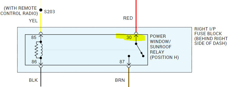

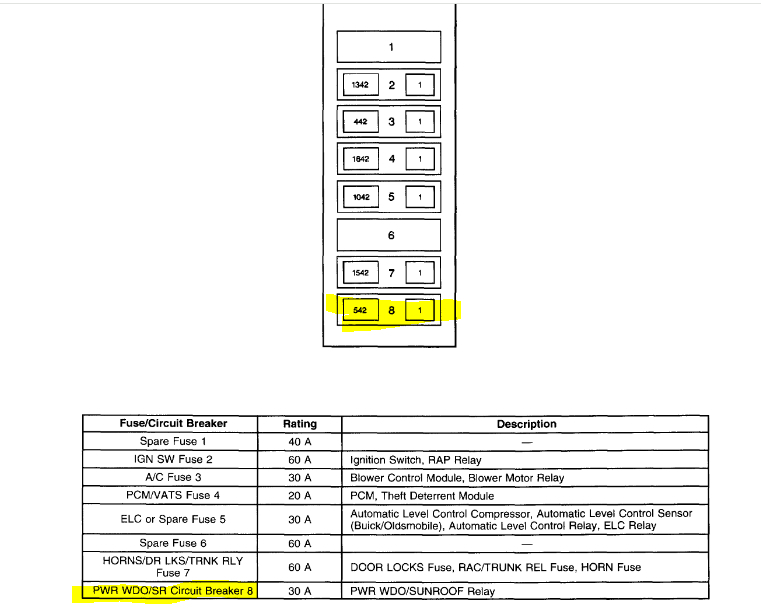

Pic 4 shows the relay's position. The 5th pic below shows the radio fuse that needs to be checked as well. That powers the primary side of the relay. When you check it, make sure there is power to and from it.
One last thought. The circuit breaker for the windows is located in the fuse box under the hood on the passenger side of the vehicle. See if you can find a different one having the same part number and switch them to confirm it is good. See last pic below for location.

I have replaced the two under the dashboard, and found the one under the hood. Maybe once I get that replaced I will have working windows again. It is near impossible to find that circuit breaker around here.

The circuit breaker tested okay, the fuses all tested okay, the relays are brand new. There is no power to the main switch on the driver side nor the switch on the passenger side, tested with a test light.
Sep 5, 2024 at 7:37 PM
  • 110,194 POSTS
If you aren't getting power to the switch and the circuit breaker is good, there has to be an open in the wiring between the two. How deep did you dig into the wiring?
