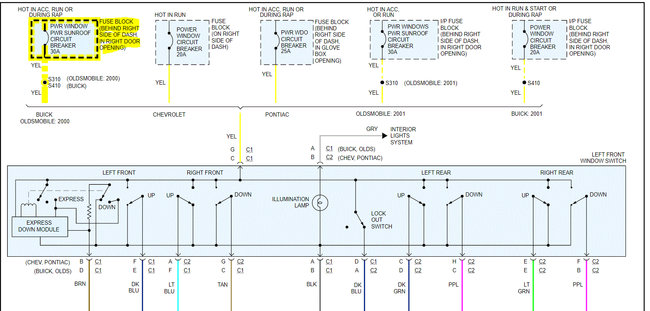

Hi all , 4 power windows quit. not the fuse or the switch. thanks, Dan
Feb 14, 2021 at 6:27 AM
  • 110,248 POSTS
The power supply is via a circuit breaker. Are you certain there is power out from it? Check at the switch.
I attached two pics below. First is a portion of the wiring schematic. I highlighted the circuit breaker. Pic 2 is of the fuse box in the vehicle. Check to make sure the circuit breaker is allowing power out. Also, confirm there is power to the main switch. It will be a yellow wire. If there is power, it is likely related to the switch.
