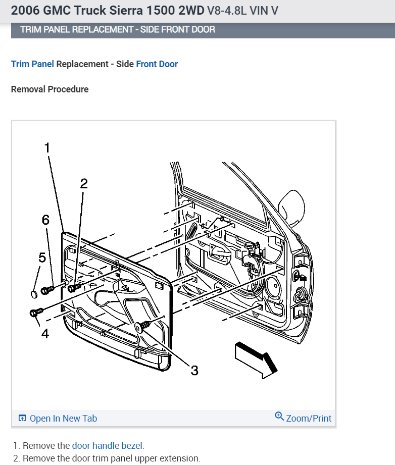

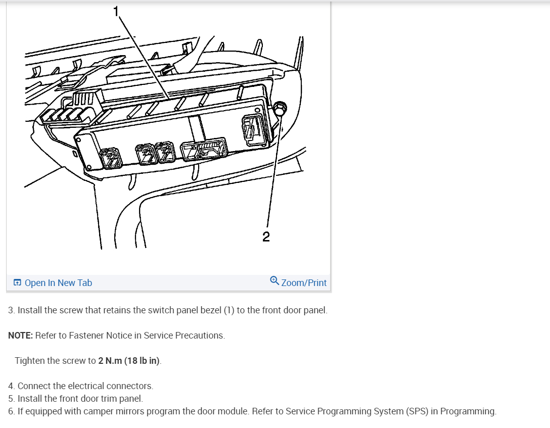

Cannot roll down passenger side window from passenger side window controls or driver side window controls.
Aug 7, 2022 at 10:44 AM
  • 55,627 POSTS

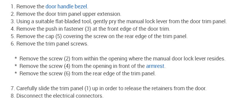

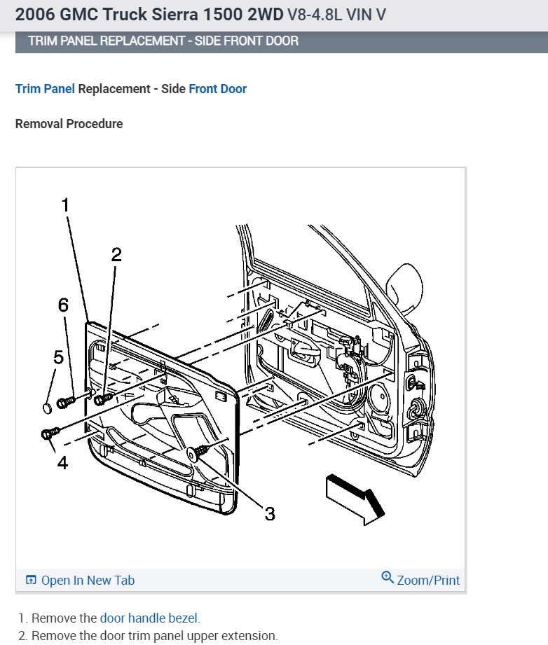

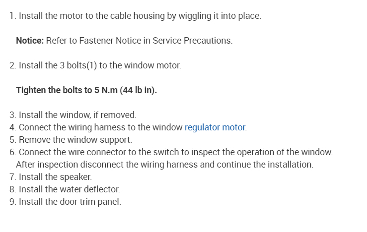

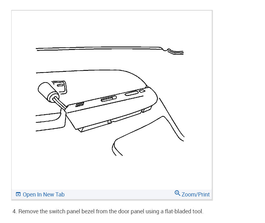

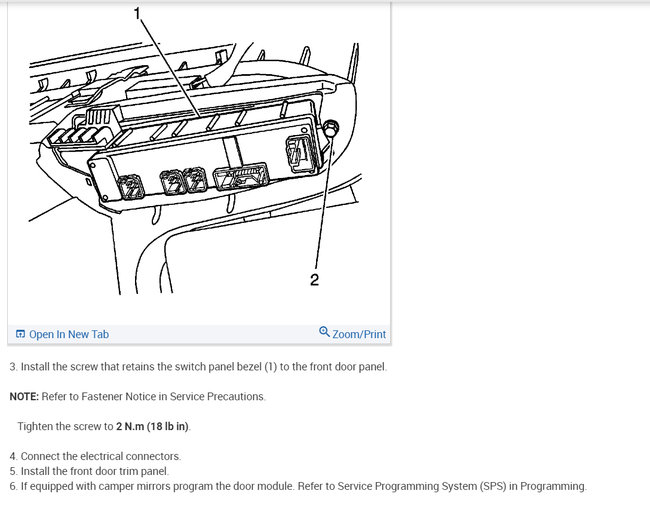

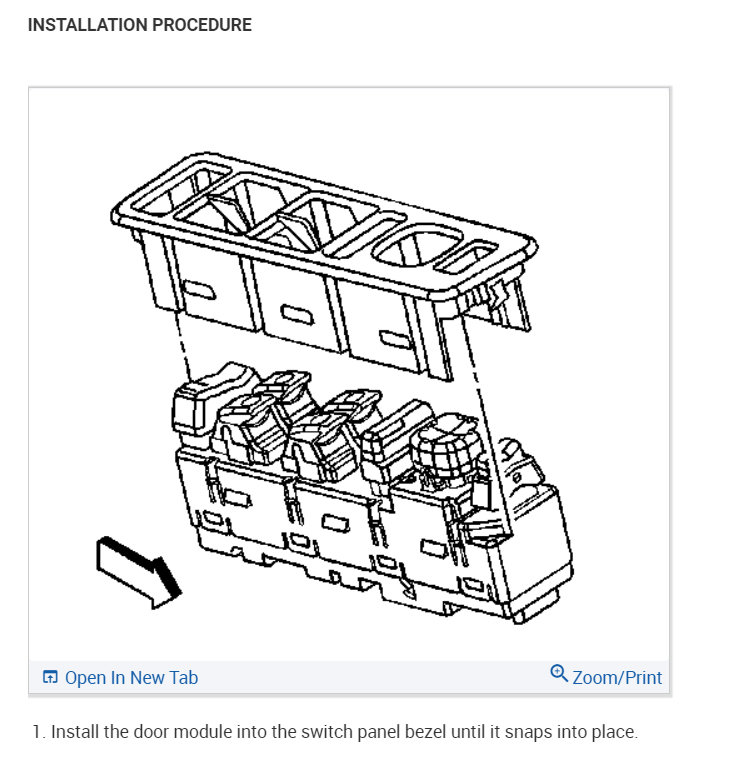

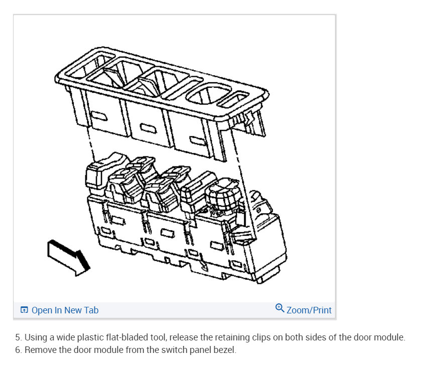

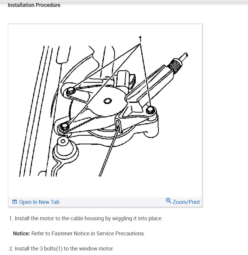

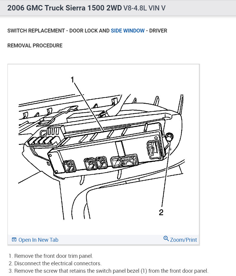

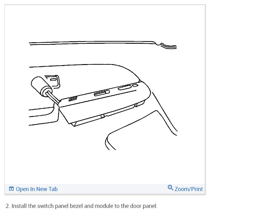

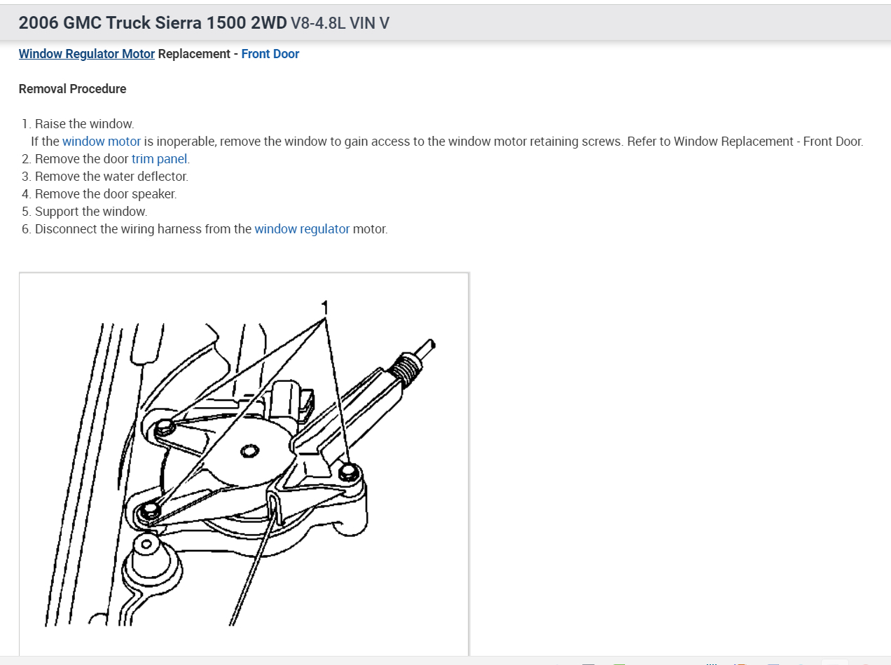

This happens when the master switch goes out or you have a window motor that is not working, to be sure on which one has failed you will need to remove the main switch or door panel and do some testing.
This guide can help:
https://www.2carpros.com/articles/electric-window-repair
and
Use a test light to see if the window motor is getting power. Here is how to remove the main control switch and door panel in the diagrams below. Check out the diagrams (below). Please let us know what you find. We are interested to see what it is.
