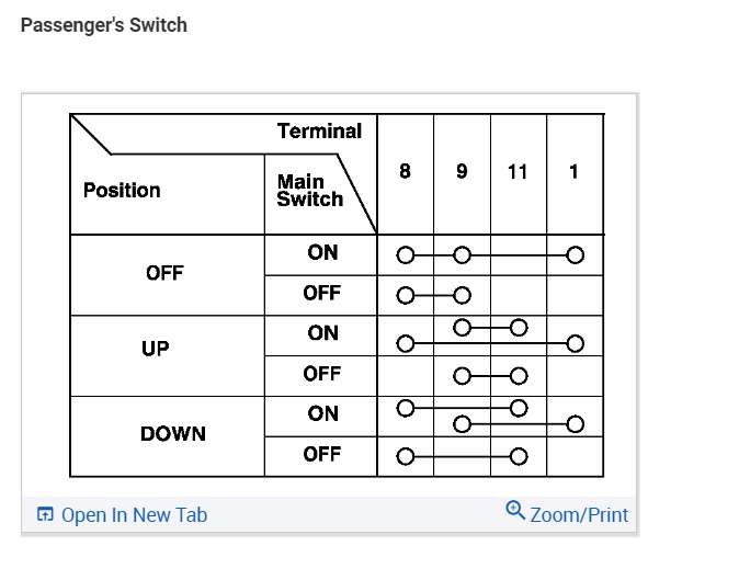

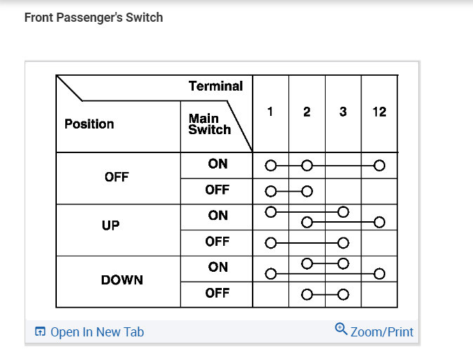

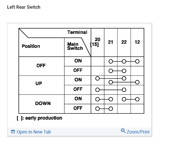

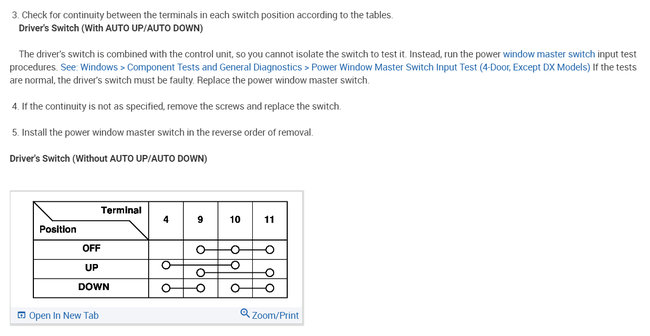

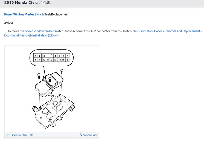

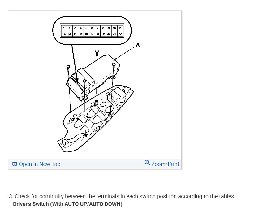

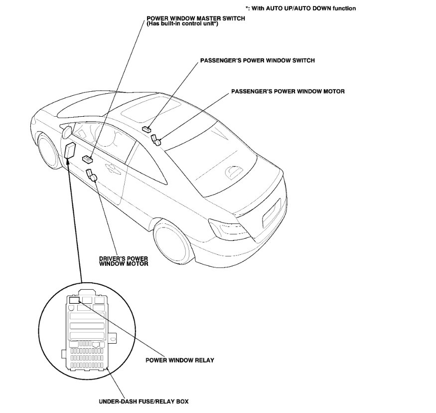

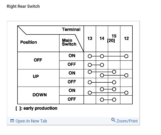

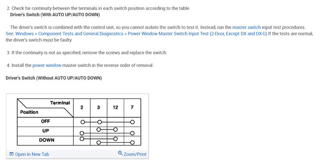

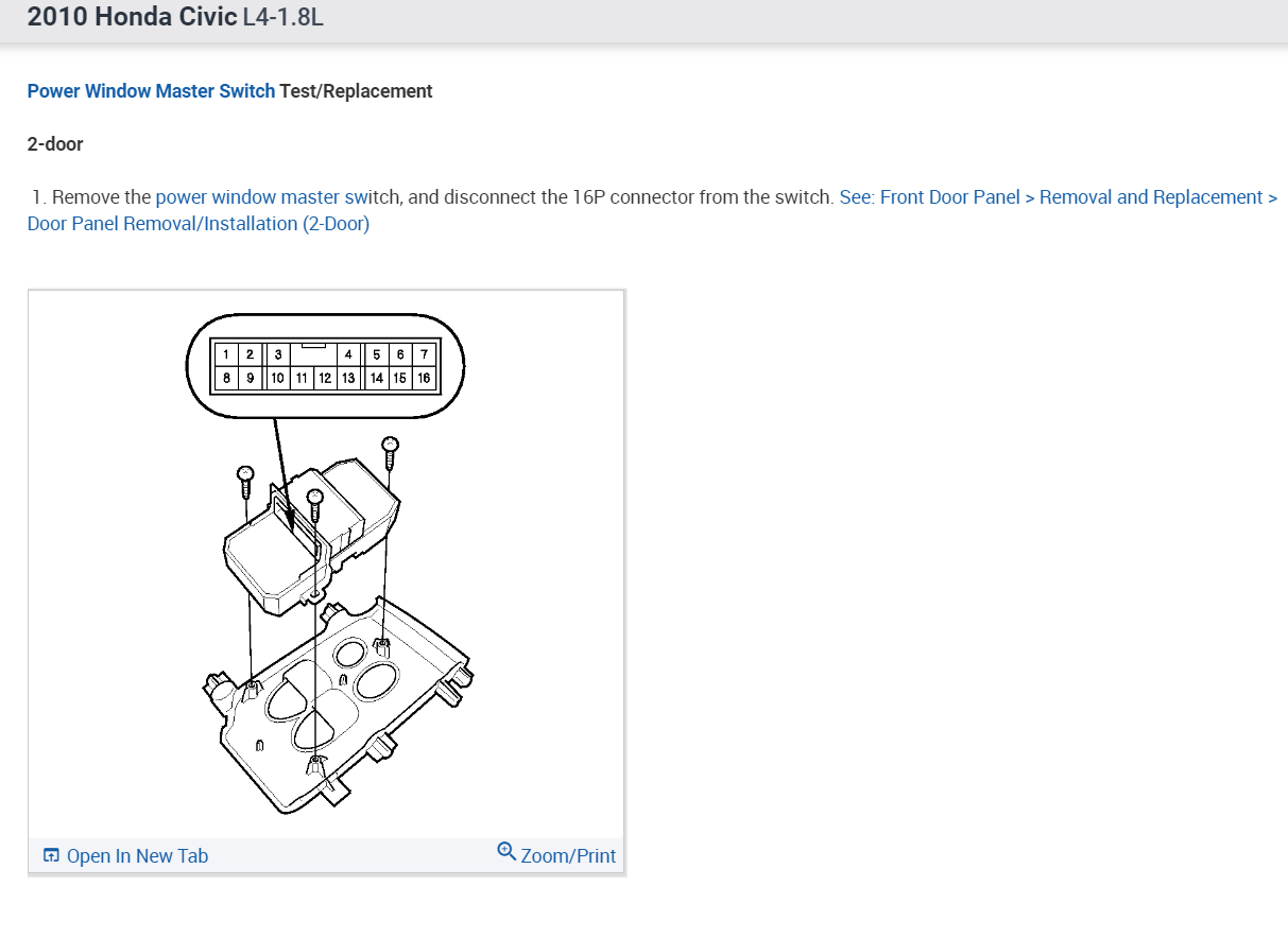

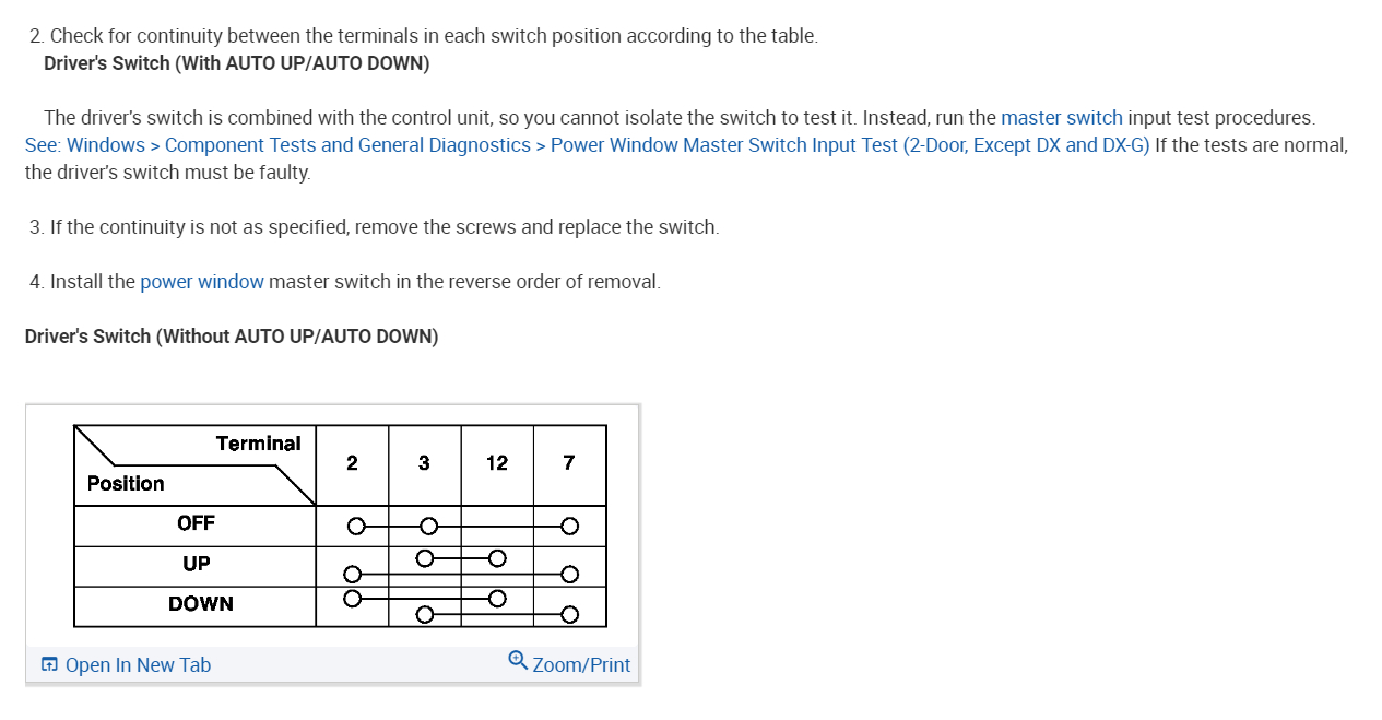

It sounds like the power window relay is going out or the main window switch is having a problem with the microprocessor inside the switch. I would start with the relay. I have a guide here you can help run tests with and the relay location in the diagrams below:

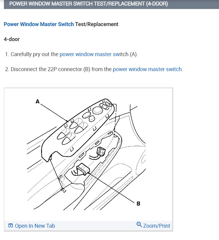

Also included the master window switch testing and replacement instructions in the diagrams below. Check out the diagrams (below). Let us know what happens and please upload pictures or videos of the problem.

Hi Ken. Thanks for the quick response. I'm sorry I didn't ask 2 or 4 door. My car is a 4 door EX. I have one questions, correct me if I'm wrong. If the relay was bad wouldn't all the windows not work? When one or more of the windows don't work the others do. If you could please send me the troubleshooting charts for the 4-door ex circuit ans master switch. I will double check the relay now. Thanks for your help and time. It's appreciated!
Neil
Jun 29, 2022 at 6:29 PM
NEIL2002CIVIC
  • 119 POSTS
Hi Ken, the relay appears to be working properly when the working windows work. I wasn't sure if there's another one, I could exchange just to try in its place. I just need the troubleshooting chart for that Master window switch please. (4 door ex) I suspect a bad master switch or possible broken wire in the harness leading to the main switch. As I said I have replaced the switch before. Although not original mainly because the price of a new original is $200.00. The vendor where I bought the aftermarket switch has a lifetime warranty and is also willing to send me a new Switch no charge. I still would like to double-check in the switch itself so I know what the switch in the car is doing compared to the new one I will be getting. As always thanks for everything you do. You guys are always great and informative. I appreciate the help getting me in the right direction to isolate my problem. Have a great day and stay healthy.

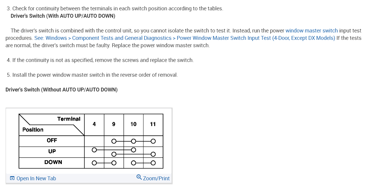

Yep, I have seen the wiring at the driver door break at the door jam. Here are the four-door switch testing, the main window switches go out which is common. You are right on the relay, my bad. Check out the diagrams (below). Please let us know what happens.

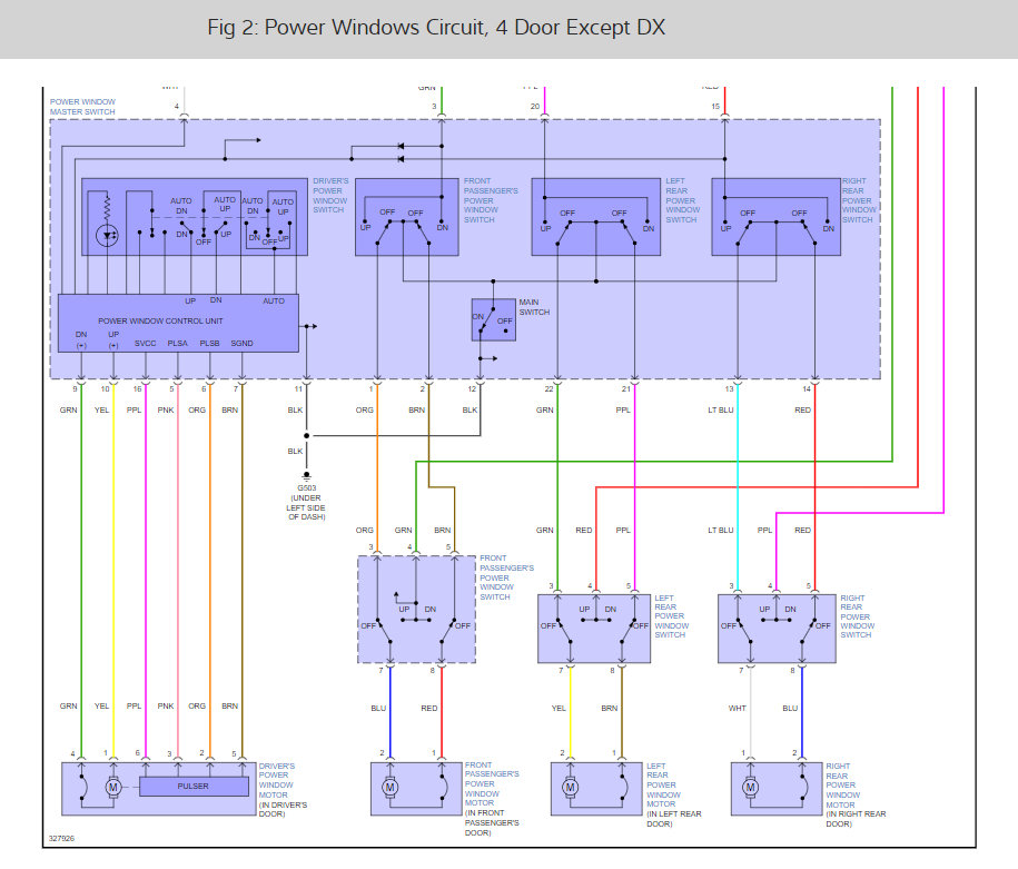

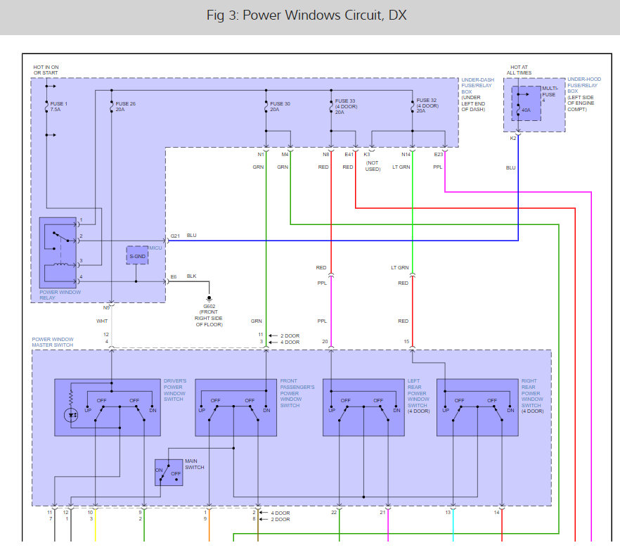

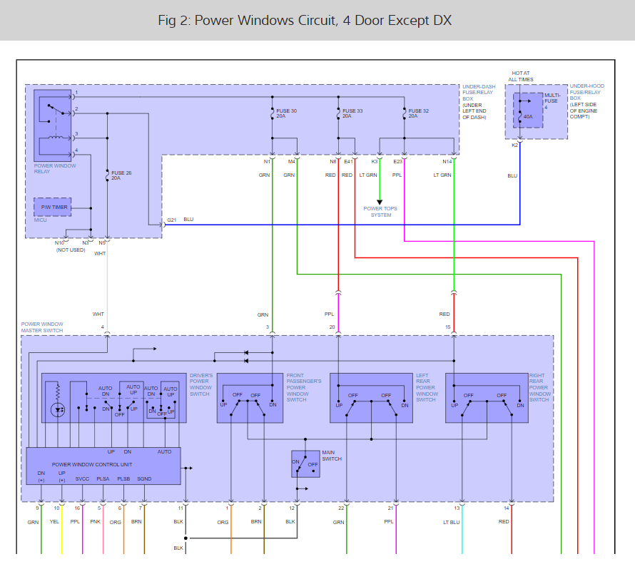

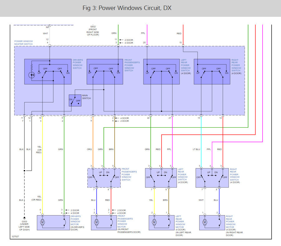

It's not the switch. Do you have a power window wiring schematic for this car? 4 Door EX. No broken wires visible and nothing when wiggled. It is both rear windows not working, front work only. There is a connector that joins the door to the rest of the car. I haven't taken it apart yet. I have seen these connectors break or deteriorate. I'm going to remove the complete driver's front door panel and hope i see something. (Only arm rest removed for switch)
Please help me identify the wire/wires (colors) that links the rear windows together that might account for my rear windows not working. Unless i see an obvious problem. I will need to check for continuity.
This will be greatly appreciated!

Hi Neil,

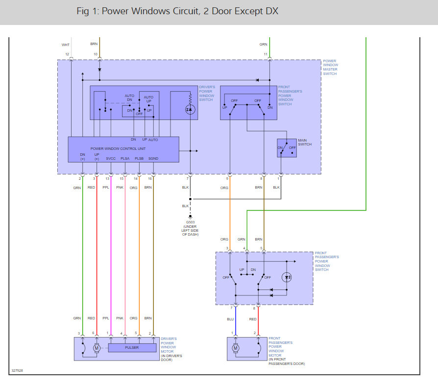

Yep, back surgery is no fun at all, I hope you feel better soon. My 4th was good, my dogs don't like it though. :/ Here are the four door wiring diagrams so you can test and see how the system works.

Hi sorry for the late response...There was a broken wire at the drivers front door connector. Thanks for your help.
