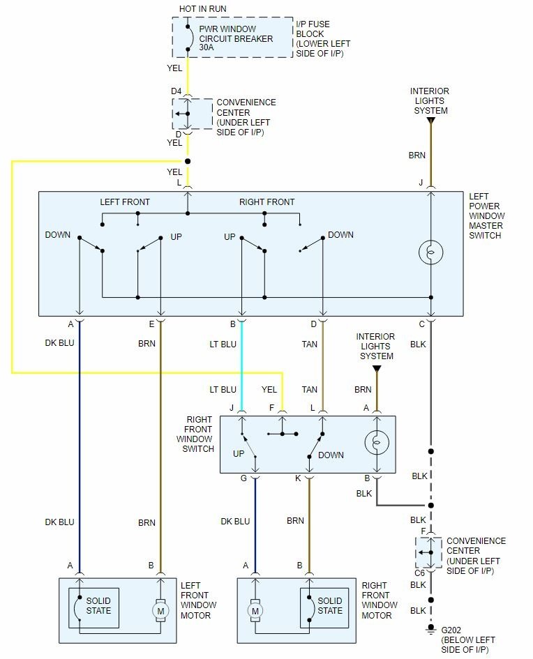

Very likely the drop damaged the drivers side switch or harness. The passenger window gets its power from the drivers side switch through the yellow wire. They also share a common ground that is switched to make the window go up/down. The ground is easier to check, turn on the interior lights, if the window switches light up, the ground to the switch and motor are okay. Can you control the window from the drivers side at all?

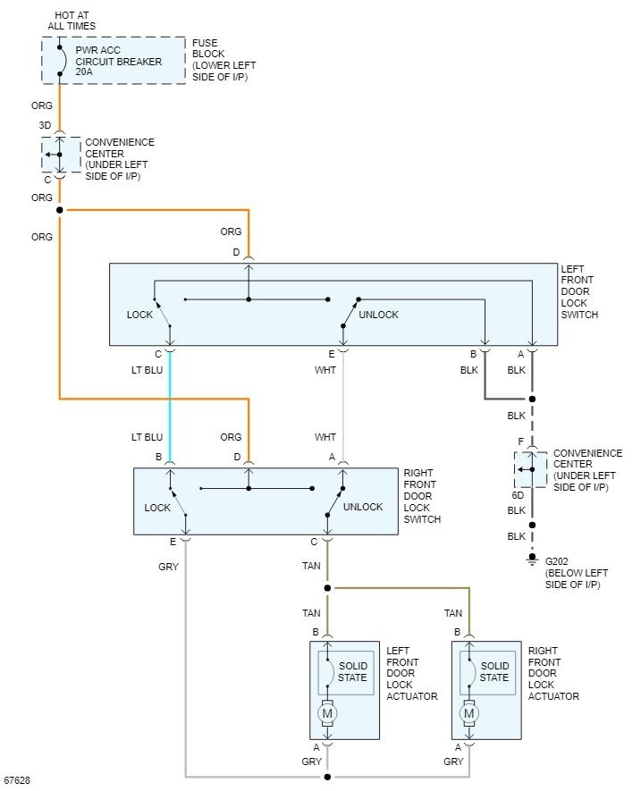

Hmm, wiring shows power locks have an orange power feed for the two door. Attached diagram.
You could try jumpering power, that was the last part of the earlier post, that would let you check if power applied at the passenger side yellow showed at the other side, same with the ground. Just be sure to use a fused jumper wire in case it is shorted for some reason.

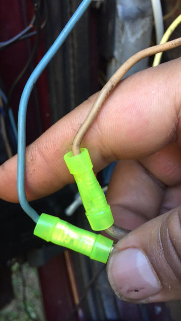

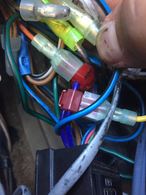

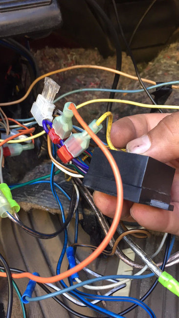

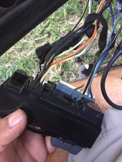

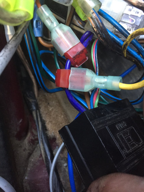

Added some pictures
I got my multi-meter working and was getting 10.2 volts at the brown and blue connector which is of course the reason it is not working.
The yellow wire has two splices to it, the orange one leads back to the switch and into the power lock clip and the purple maybe my alarm. I checked the voltage right at the yellow and it was up to 13. So is the orange supplying the power?
I did not get a chance to try jumping the ground off the battery yet to see if maybe that will help.
Sep 21, 2018 at 12:02 PM
  • 55,594 POSTS
Yes, the yellow/orange wire supplies the power. I would try following this guide is can show you how to see what is going on.
https://www.2carpros.com/articles/electric-window-repair
Sep 24, 2018 at 6:08 AM

Everything shows ground and power at the switch, but the volts are low at the blue and brown connector showing (10.2 volts).
I checked the volts are the orange splice and it showed 22 volts ( is that high for that wire) and where the black/purple and yellow wire splice it shows 22 volts. Also, the orange wire shows 22 volts at the connector. (I did notice the second orange wire which should be the power lock for the drivers side.)
So I moved the wires around and no breaks than I have not repaired (ground was torn and the tan wire was tearing a bit).

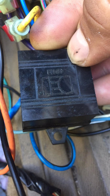

What is all that wiring too? Aftermarket alarm? I would take that out I have had nothing but problems with them.

Yeah, should be the alarm the black/purple but so far no issues with that.
The volts where not as high as 22 volts the previous times I checked them, it read 22 volts at the wire splice and at the connector (orange wire) yesterday. I think I was getting 13 volts the other day

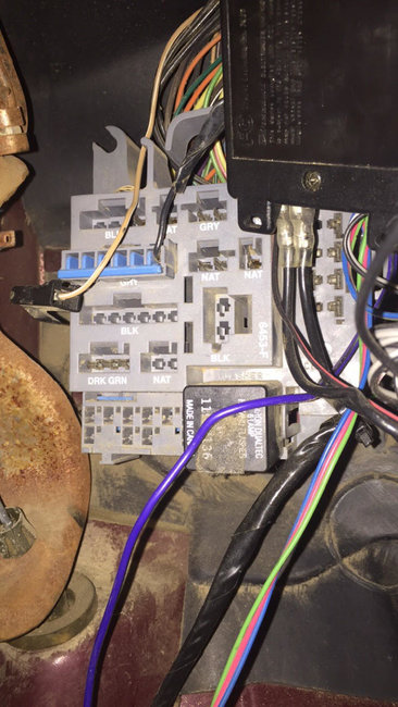

I am going to start looking at the convenience center (D4) spot to see what the volts read there. Thanks for the help so far guys.

Can you wire the alarm out of the system to see if the problem goes away?

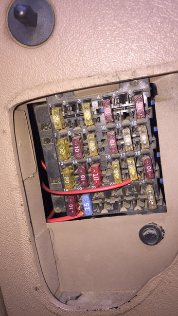

I checked the power at the convenience center and it shows 10.2V at that D6 wire. It looks a little bare there from what I have seen in other trucks. Any ideas of where to go from here?
I kept checking all the fuses which are good is there anything there that looks wrong?
This all came from the door falling and pulling the switch from its holder and pulling the terminal from the window motor, not sure how that lead up to this.

It sounds like you have a short in the wiring harness in the door to the body. Can you pull and push on the wiring to see if things change?
