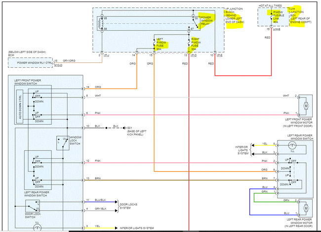

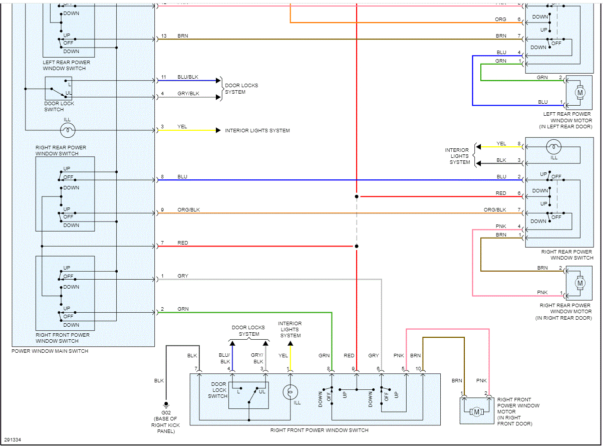

The first two pics below are the wiring schematic for the power windows. I had to cut one page in two to make it readable for you. I did overlap them for you.

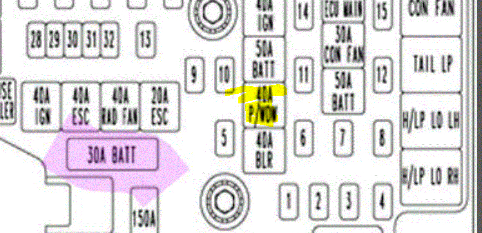

I have checked both fuses 30amp inside with a tester light, I've touched both metal on the fuse and I've removed the fuse and checked where they connect and nothing. I also switched the relay fuse 40 with another and still nothing. I don't think it's getting any power. Can you send me a pic of the fusible link so I can check that out next?

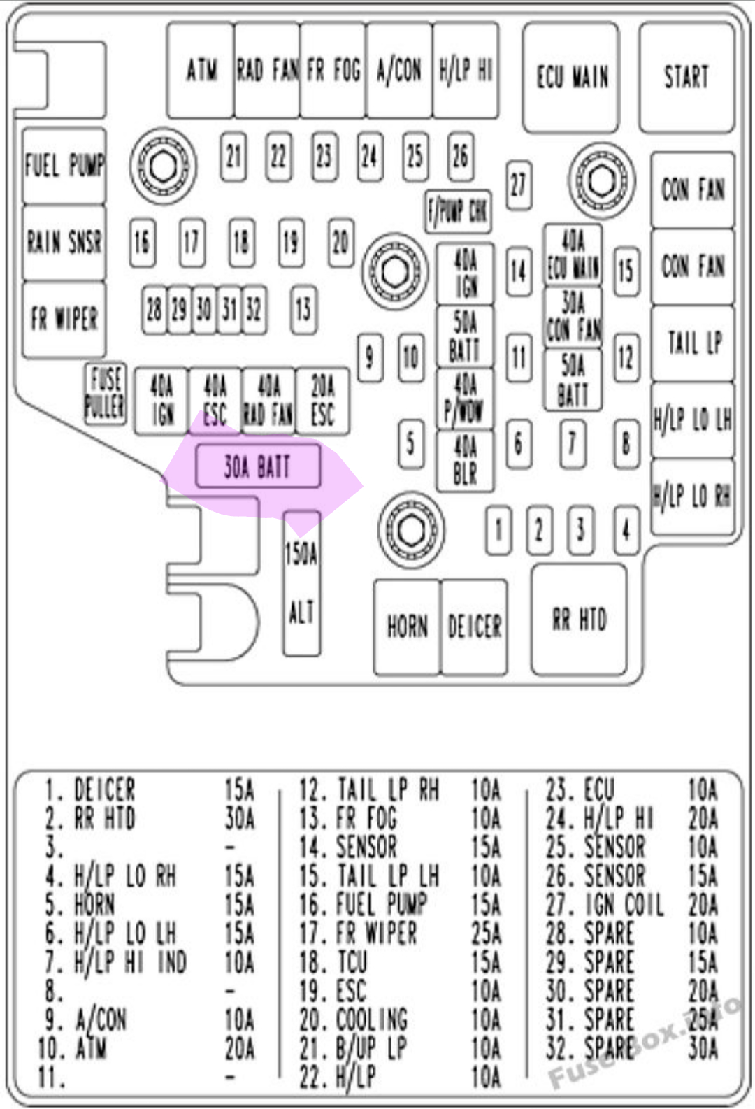

Is this the fusible link you mentioned?

  • 110,244 POSTS
No, that isn't it. Take a look at the pic above. I highlighted it. It is in the under-hood fuse box. I made a copy of your pic and highlighted its location in yellow.
Let me know what you find.
Take care.
