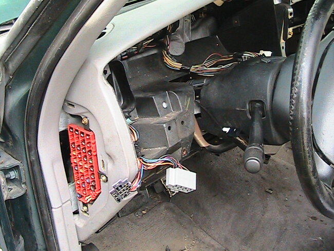

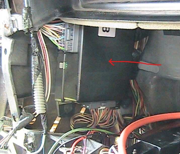

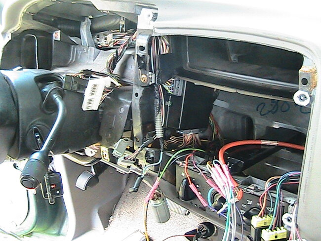

I have no power to the window switches or power to the wiring door plug it is the type that connects them. Interior fuse #25 was blown fuse #26 is ok. I installed another fuse in 25 and it blew right away with a slight smell of burning wire. The under hood #4 power window fuse 30amp is ok. From what I have been reading it might be the battery-saver relay or the GEM relay. And for the best of me, I can seem to locate them I have the radio and the entire front part of the dash off this is a 2000 2-wheel drive Ford Explorer sport.
Aug 13, 2024 at 3:50 AM
  • 55,748 POSTS

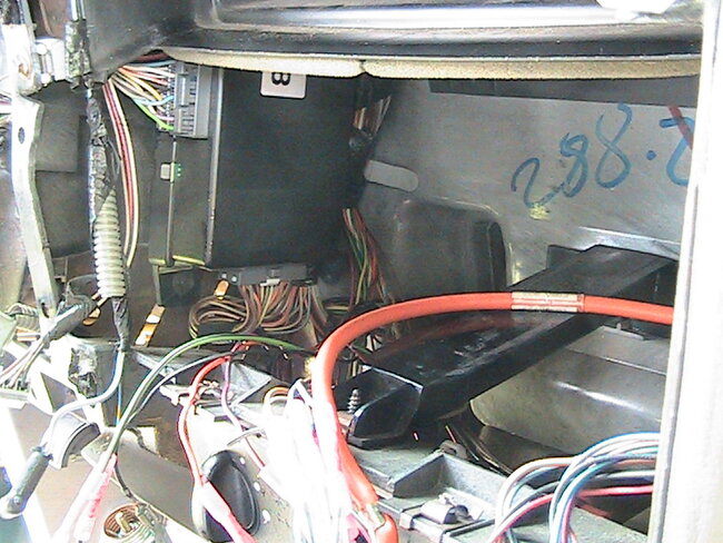

If the fuse #25 was blown it goes to the GEM which I have seen go out. Here is the location of the GEM. I would unplug it to see if the fuse still blows.

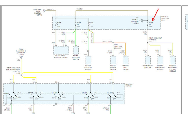

Hi, Ken. I still have not resolved the problem with the windows. I just got done unhooking the GEM from the car and installed a new 7.5 fuse and it blew right away. (Fuse #25Generic Electronic Module (GEM), Instrument Cluster, Securi-Lock.) I didn't get a new/used GEM there was a screw-up in the order. I did take it apart and did some checking and really didn't find any burnt spots or anything wrong with it. Like I said it still blew the fuse with it unhooked. Anyway, I guess I am looking for a wiring diagram for fuse #25 so I can trace the wiring to see maybe where it is shorted out and go from there. Thanks, Jack.
Aug 27, 2024 at 2:00 AM
  • 55,748 POSTS
That fuse goes to the GEM, instrument cluster and the passive anti theft module. Here is the wiring for it so you can see.

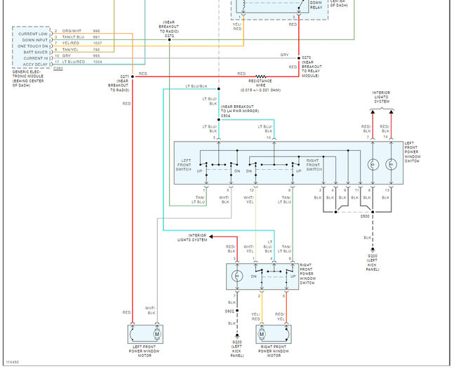

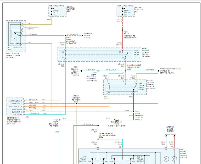

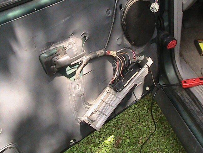

Hi Ken. Thanks for the diagram, it was very helpful. One more request, do you have the wiring diagram for the two-door power windows from the switches through the door and I guess up to the under-hood fuse box, which was my original problem? Thanks Again. Jack.
Aug 27, 2024 at 3:07 AM
  • 55,748 POSTS
Sure, here are the window wiring diagrams and a guide to help you check the connections:
I see the windows go through the GEM so it could be the main switch that is shorted out, I would unplug the switch to see if the fuse still pops. Check out the images (below). Let us know how it goes.

Howdy Ken. Well, I finally figured it out it came down to the Y/W wire that goes into the black plug on the dash. I did a check-and-go as I hooked everything back up to the GEM as I put the connectors on I would check the fuse the last one I hooked up was the black connector that went to the instrument cluster and the fuse blew. I removed the connector and installed a new fuse all was good, and the windows work now also. I found a used instrument cluster on e-bay should be here next week. I hope that is it. Thanks again. Jack.
