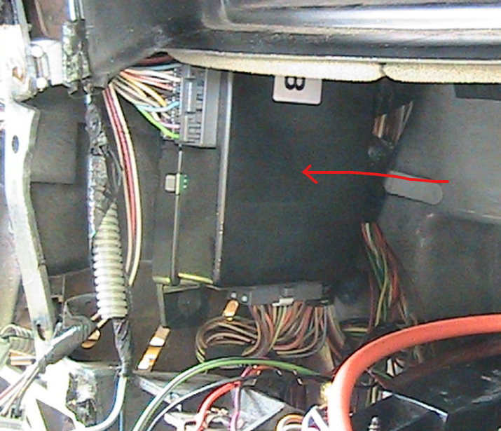

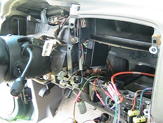

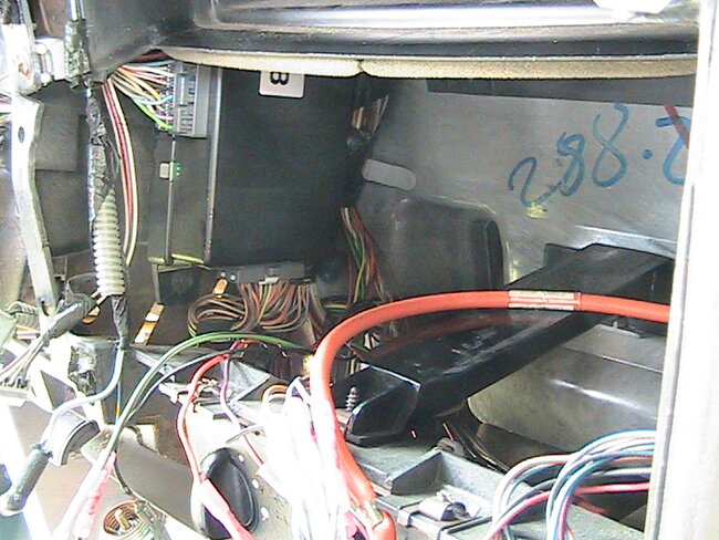

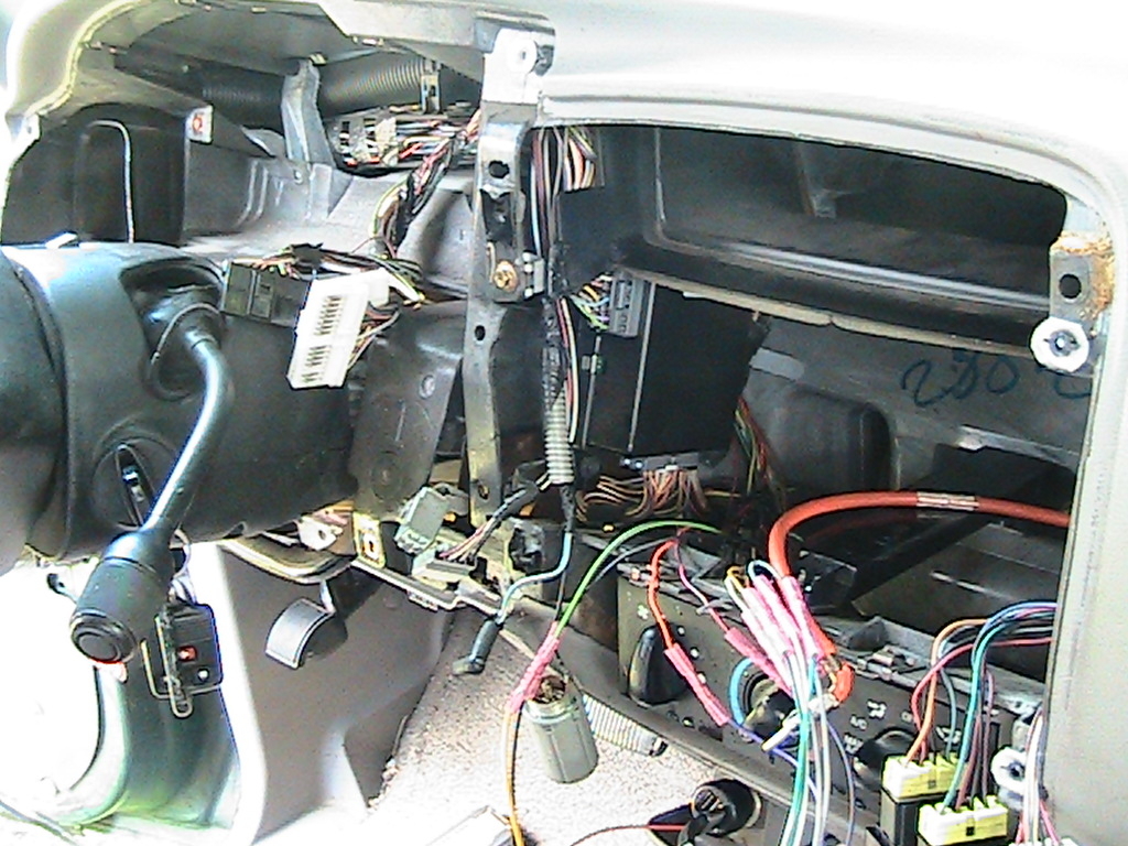

I have no power to the window switches or power to the wiring door plug it is the type that connects them. Interior fuse #25 was blown fuse #26 is ok. I installed another fuse in 25 and it blew right away with a slight smell of burning wire. The under hood #4 power window fuse 30amp is ok. From what I have been reading it might be the battery-saver relay or the GEM relay. And for the best of me, I can seem to locate them I have the radio and the entire front part of the dash off this is a 2000 2-wheel drive Ford Explorer sport.
Aug 13, 2024 at 3:50 AM
  • 55,433 POSTS

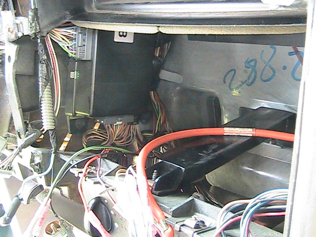

If the fuse #25 was blown it goes to the GEM which I have seen go out. Here is the location of the GEM. I would unplug it to see if the fuse still blows.

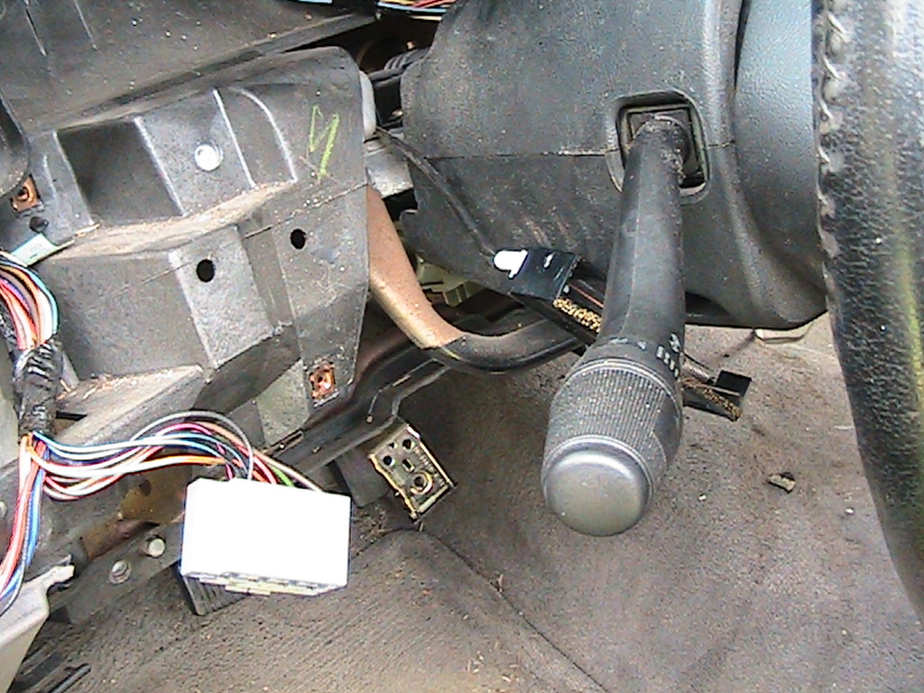

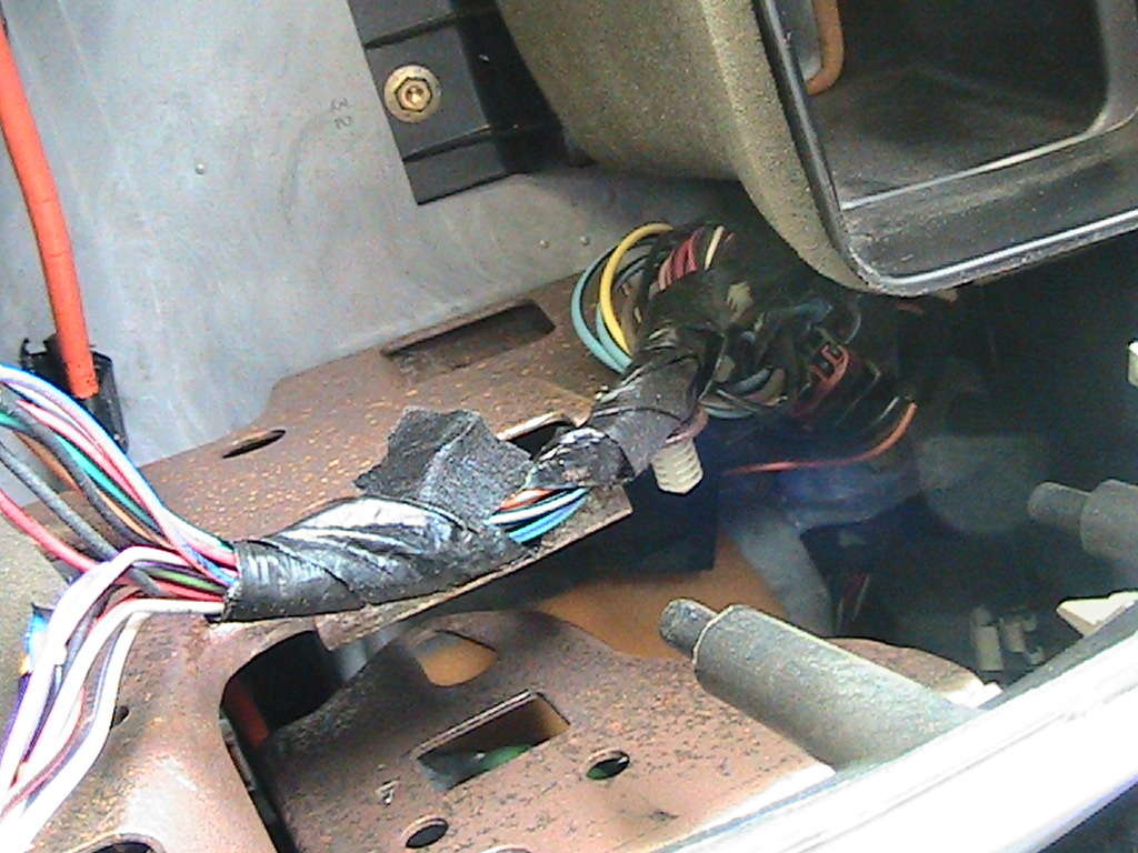

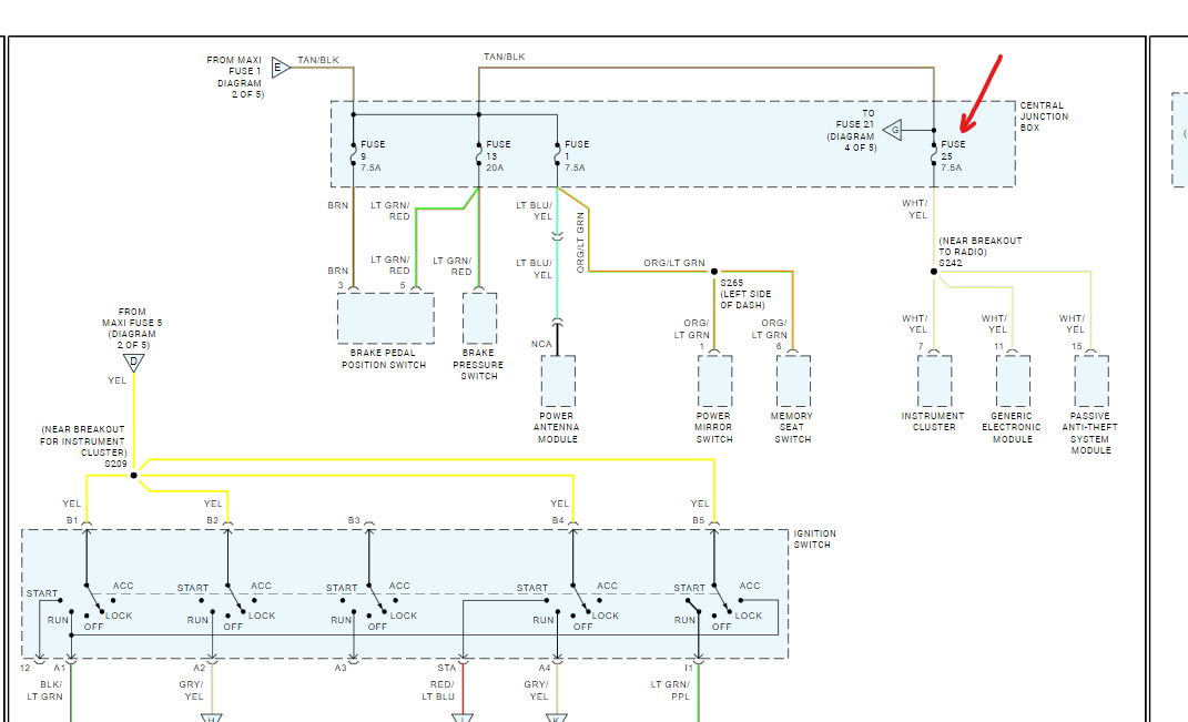

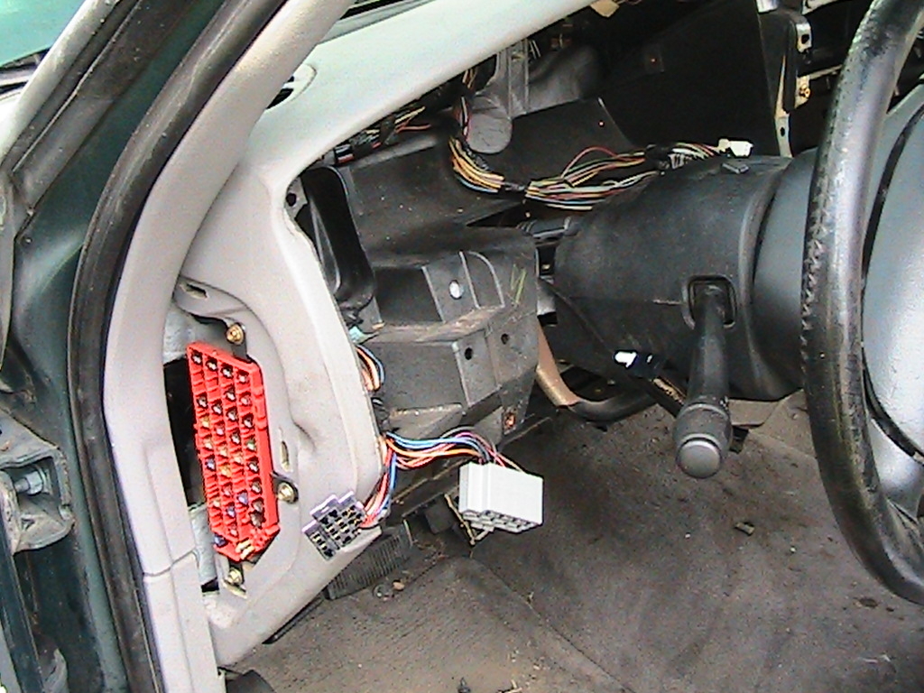

Hi, Ken. I still have not resolved the problem with the windows. I just got done unhooking the GEM from the car and installed a new 7.5 fuse and it blew right away. (Fuse #25Generic Electronic Module (GEM), Instrument Cluster, Securi-Lock.) I didn't get a new/used GEM there was a screw-up in the order. I did take it apart and did some checking and really didn't find any burnt spots or anything wrong with it. Like I said it still blew the fuse with it unhooked. Anyway, I guess I am looking for a wiring diagram for fuse #25 so I can trace the wiring to see maybe where it is shorted out and go from there. Thanks, Jack.
Aug 27, 2024 at 2:00 AM
  • 55,433 POSTS
That fuse goes to the GEM, instrument cluster and the passive anti theft module. Here is the wiring for it so you can see.
Aug 27, 2024 at 2:21 AM
CASTAWAY52
  • 16 POSTS

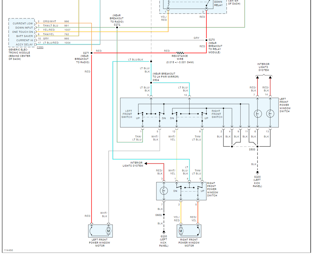

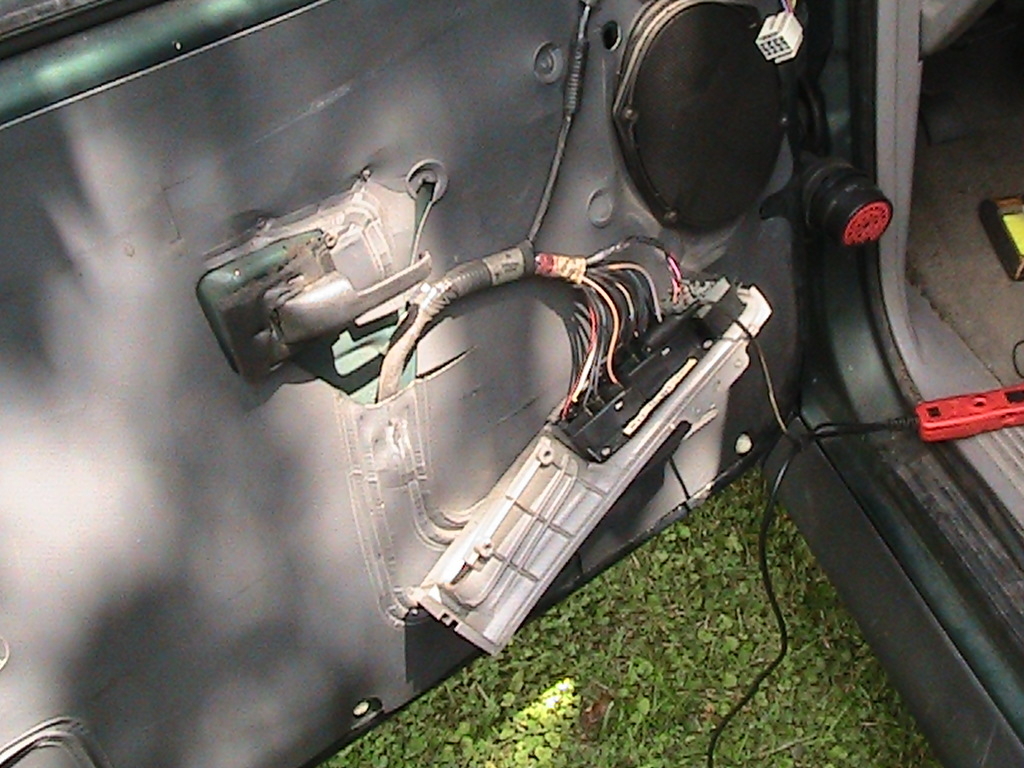

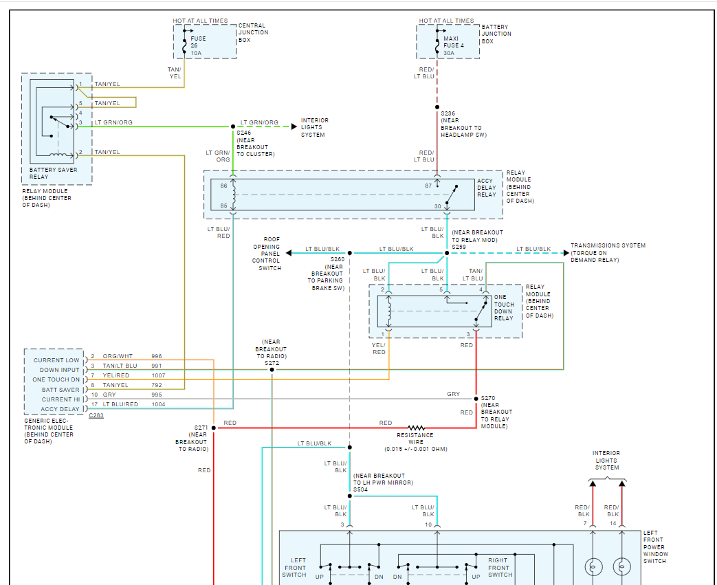

Hi Ken. Thanks for the diagram, it was very helpful. One more request, do you have the wiring diagram for the two-door power windows from the switches through the door and I guess up to the under-hood fuse box, which was my original problem? Thanks Again. Jack.
Aug 27, 2024 at 3:07 AM
  • 55,433 POSTS
Sure, here are the window wiring diagrams and a guide to help you check the connections:
I see the windows go through the GEM so it could be the main switch that is shorted out, I would unplug the switch to see if the fuse still pops. Check out the images (below). Let us know how it goes.

Howdy Ken. Well, I finally figured it out it came down to the Y/W wire that goes into the black plug on the dash. I did a check-and-go as I hooked everything back up to the GEM as I put the connectors on I would check the fuse the last one I hooked up was the black connector that went to the instrument cluster and the fuse blew. I removed the connector and installed a new fuse all was good, and the windows work now also. I found a used instrument cluster on e-bay should be here next week. I hope that is it. Thanks again. Jack.
