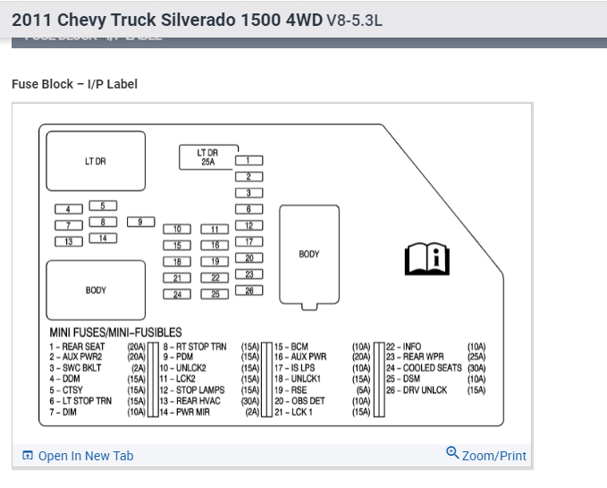

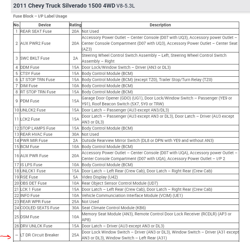

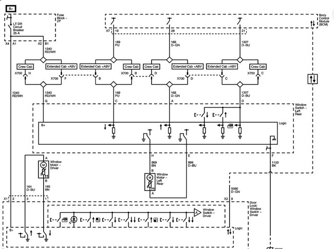

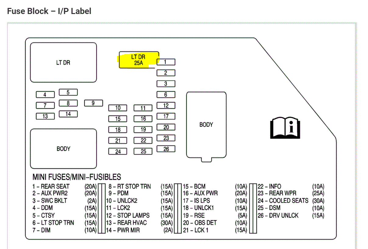

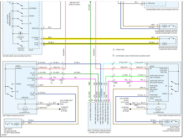

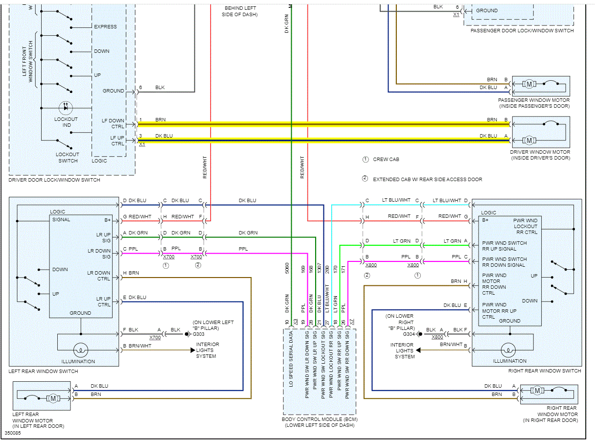

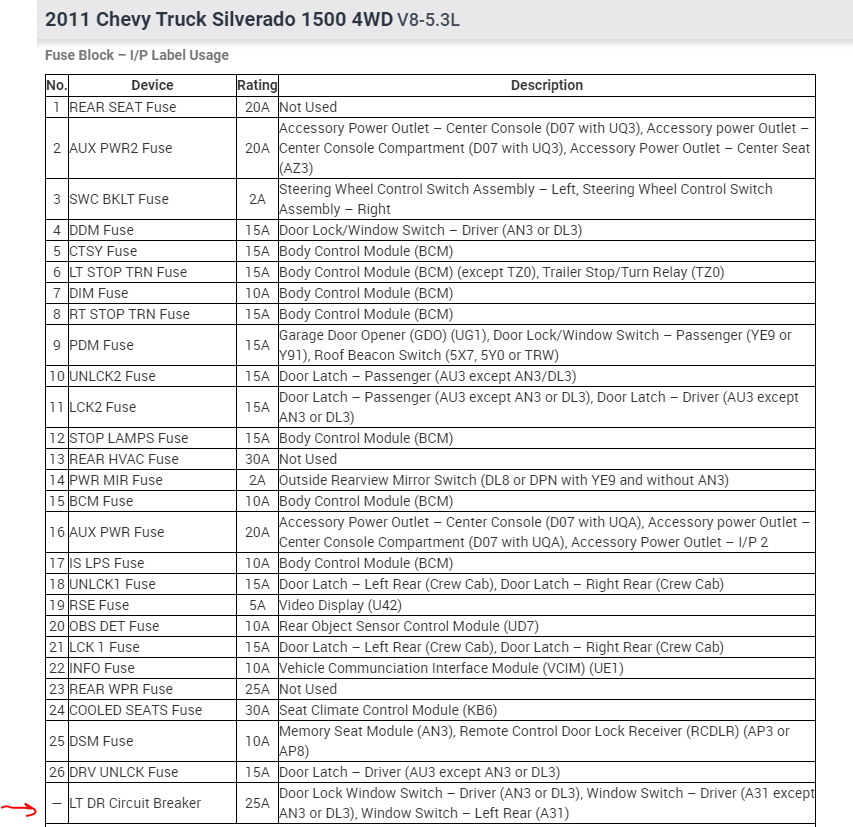

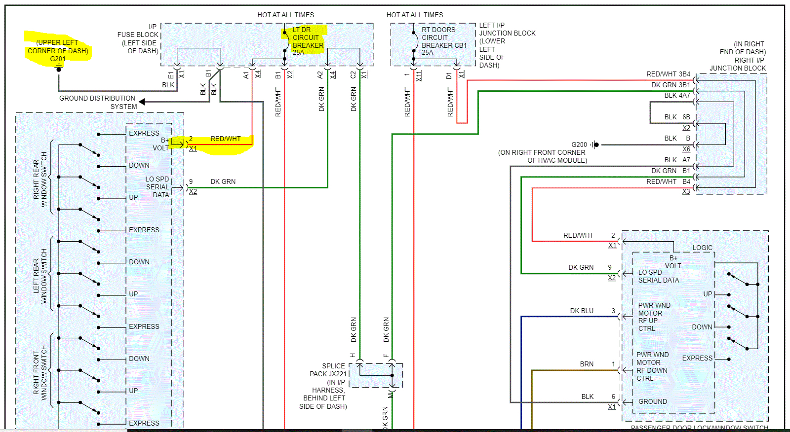

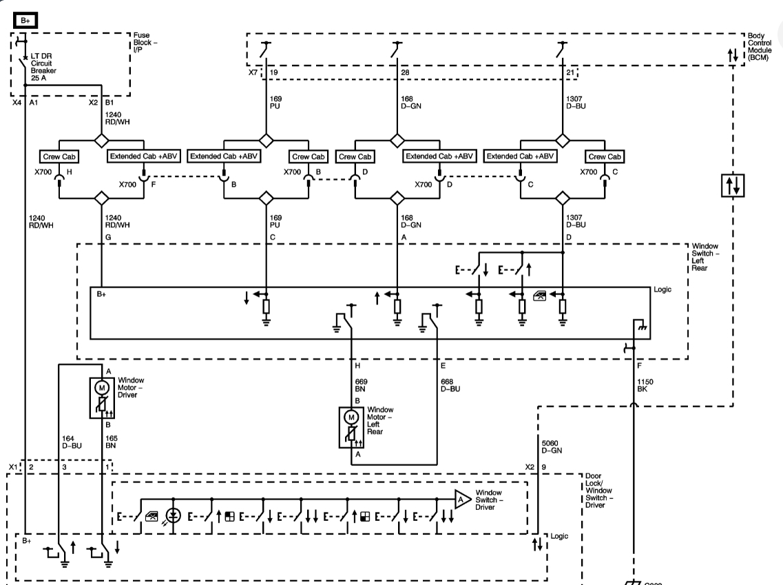

The first thing I need you to do is check for power at the red wire with a white tracer at the driver's door main switch. The power to the switch is supplied via a circuit breaker that may have failed. If there is power, then confirm the black wire at the main switch has continuity to ground. Here is a link that you may find helpful:
If you look at pic 3, it shows the circuit breaker location in the fuse box.
If you find no power at the red/white wire, check the circuit breaker, making sure there is power to it and from it.
See pics below. Note: Pics 1 and 2 are the wiring schematic for the windows. I had to cut them in half to make them readable. I did overlap them.
