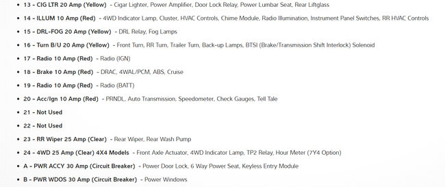

Power windows power locks and mirrors don't work at all none of them. I can't find fuse link nor a assy power fuse on this car. i have checked the fuse box, no bad fuses and when checking power going into under hood box all seem to have power. there is a heavy gauge wire coming and leaving box all have power, but on the fire wall there is what looks like a solenoid with 3 wires and a resistor looking unit with feed. all have power except the bigger red wire going down somewhere. i need help, I'm having a hard time finding any solution. i cant afford to go to GM shop.
Nov 19, 2019 at 9:14 AM
  • 55,433 POSTS

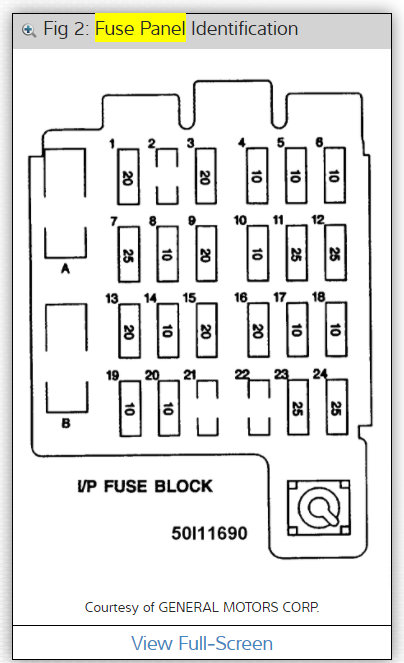

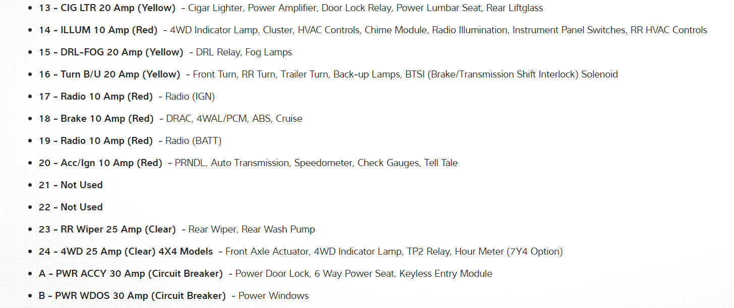

There is a 30 amp circuit breaker in the inside fuse panel I believe has gone out. to be sure here is the location so you can replace it to see if it fixes the problem. Check out the diagrams (below). Please let us know what happens.
