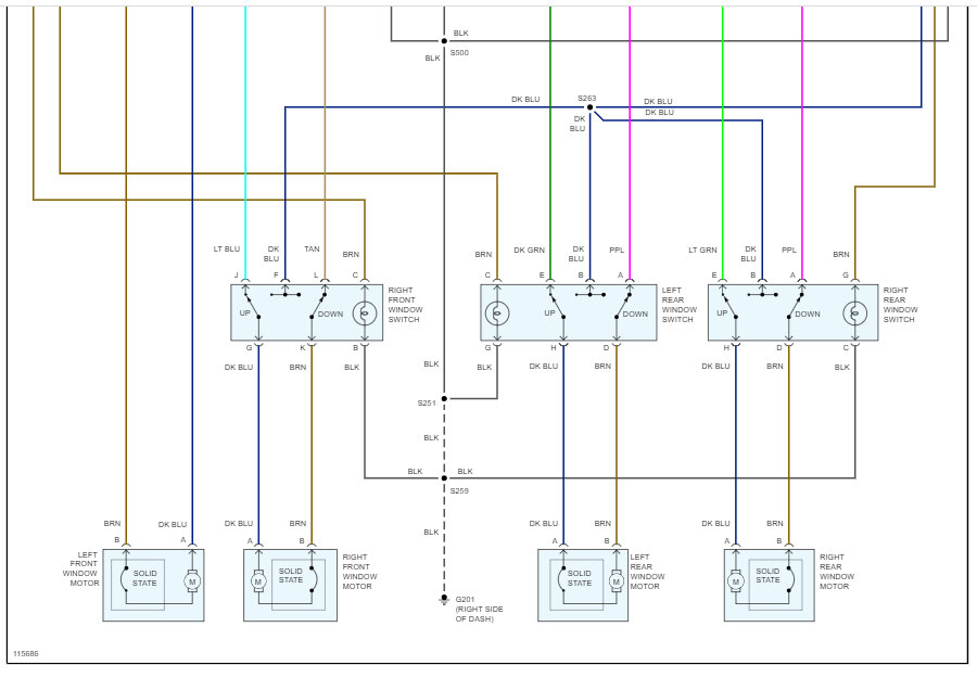

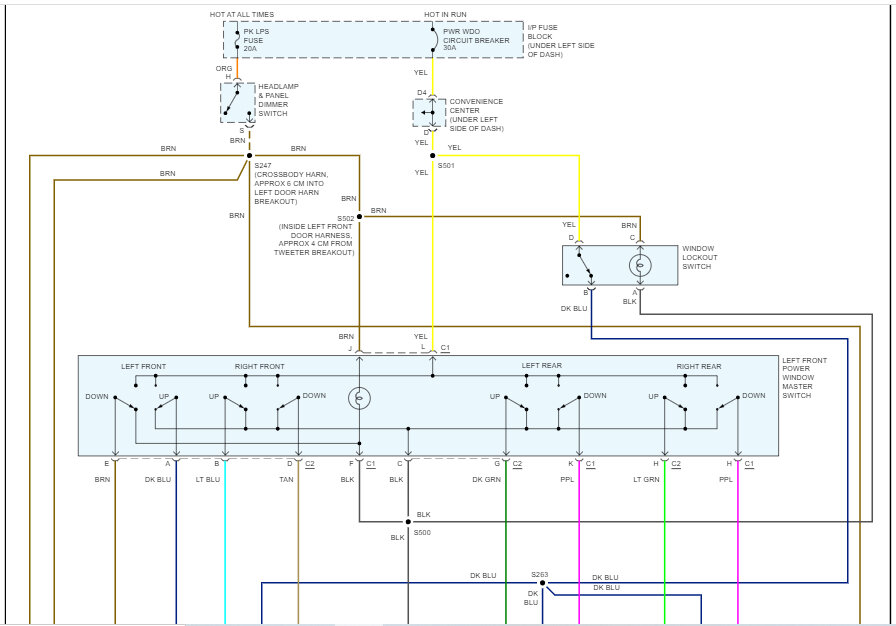

Need wiring diagram for power windows.
Oct 8, 2023 at 7:57 AM
  • 110,244 POSTS
I attached the wiring schematic below for this vehicle. I had to cut the schematic in half to make them readable. I did overlap the two so you can follow from one to the next.
Take a look through them and let me know if you have questions or if I can help.
