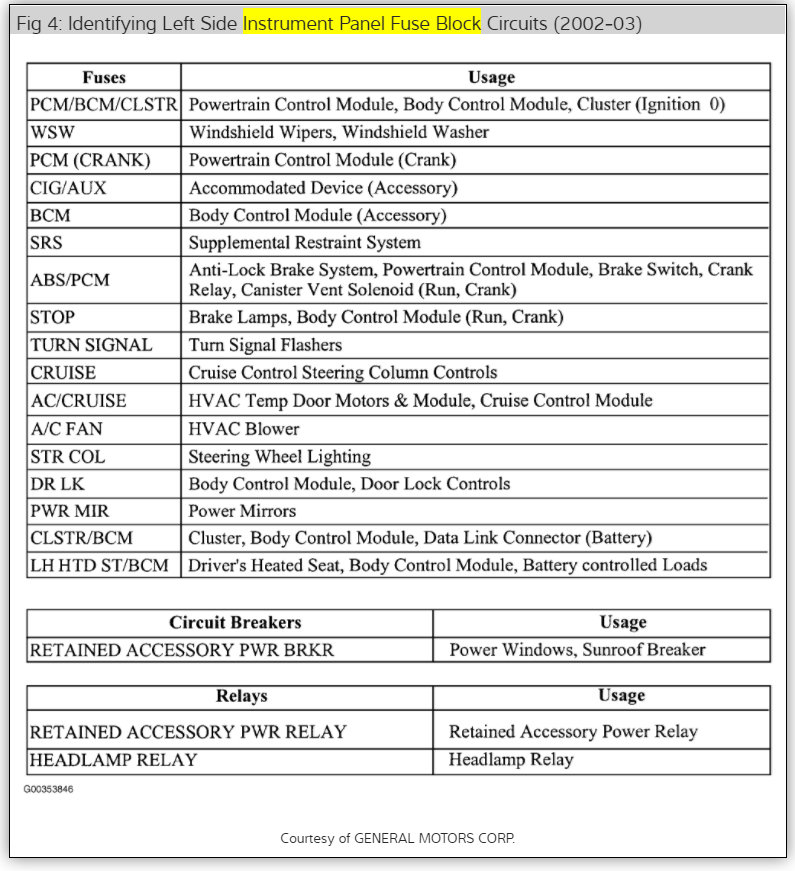

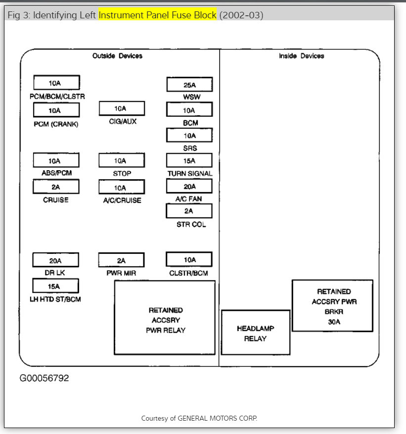

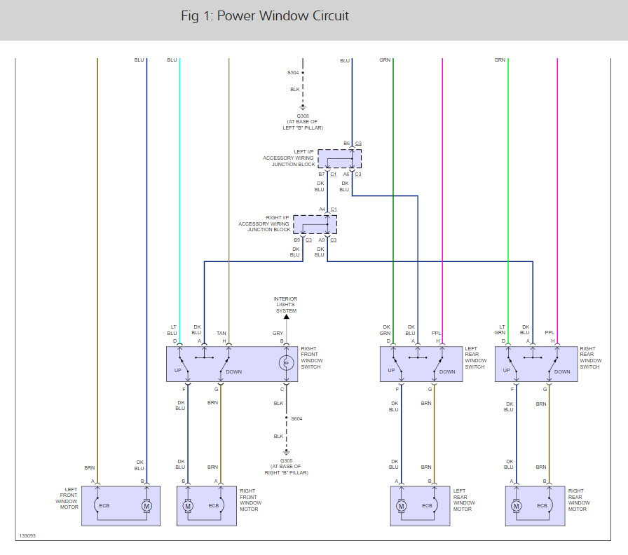

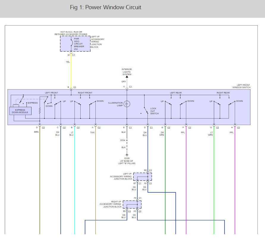

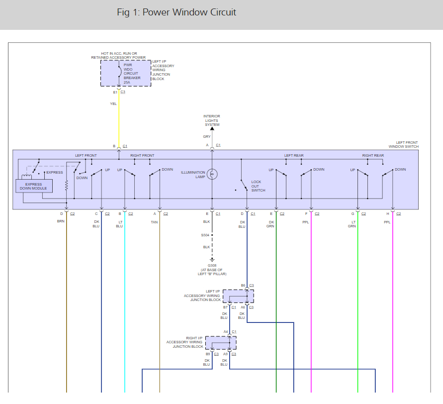

Power windows will not roll up when headlights are on.
Oct 26, 2018 at 2:47 AM
  • 55,746 POSTS
When the headlight are on can you check for power at the retained circuit breaker at the interior fuse panel? Here is a guide and the circuit breaker location along with the window wiring diagrams so you can how the system works.
Check out the diagrams (below). Please let us know what you find.
