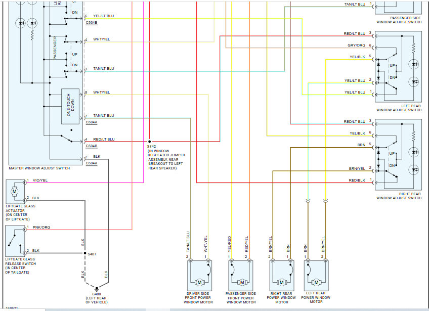

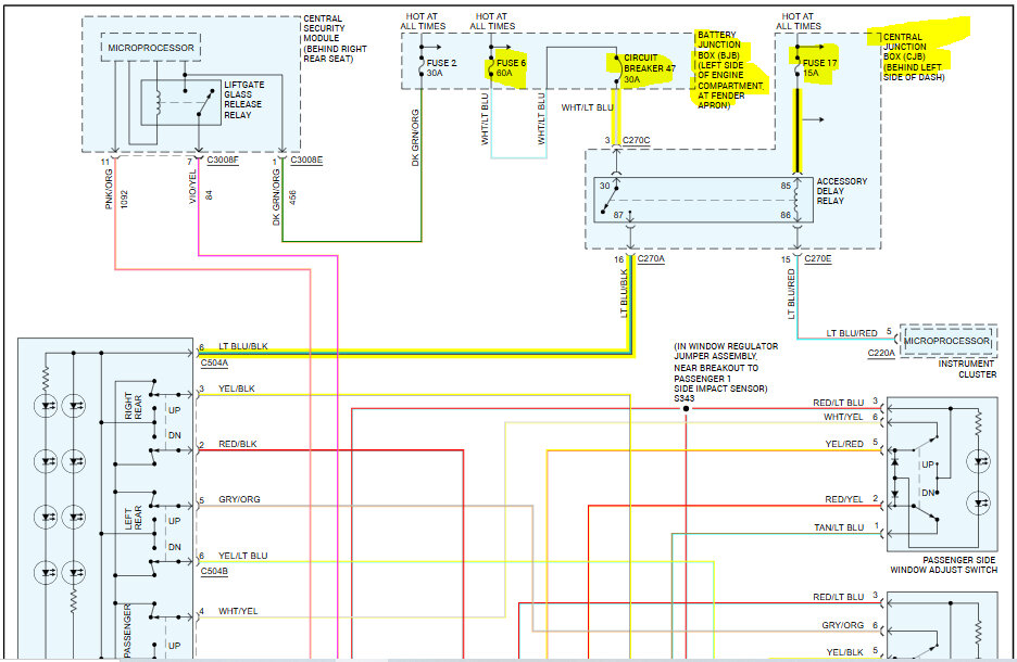

None of the window's work at all.
Dec 21, 2024 at 1:07 PM
  • 110,240 POSTS
There are a couple of fuses/circuit breakers I need checked. I attached the wiring schematic below for your reference. It appears power comes to the switches from the circuit breaker 47 via the accessory delay relay.
I need confirmation that power is present at fuse 6 in the battery junction box and fuse 17 in the central junction box (end of dash). Also, confirm the fuses are good.
Here is a link that you may find helpful:
Check this first. If they are good, I need you to locate a light blue wire with a black tracer located at the main switch (driver's side) and check if it has power.
Let me know what you find.
