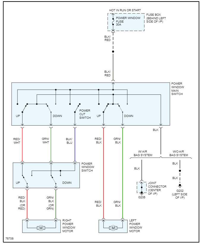

Hello. The 30A fuse appears to be okay. The driver's window went down. The passenger window went down about 1/2” then stopped. Replaced the door Panel switches. No movement at all. Ideas? It would seem to be more than a coincidence that both motors would stop working at the same time. I have a few other questions, but one at a time. This one is the most pressing.

Sorry, we are all over the country but nothing close to Birmingham AL. We need to check for power at the fuse and ground for the system. This guide will help, and I have included the window wiring diagrams so you can see how the system works and which wires to test.
and this guide may help as well:
https://www.2carpros.com/articles/electric-window-repair
