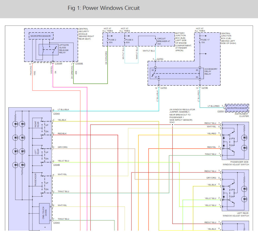

Where is fuse located for power windows? The manual does not indicate.
Mar 1, 2016 at 9:00 PM
HMAC300
  • 48,601 POSTS

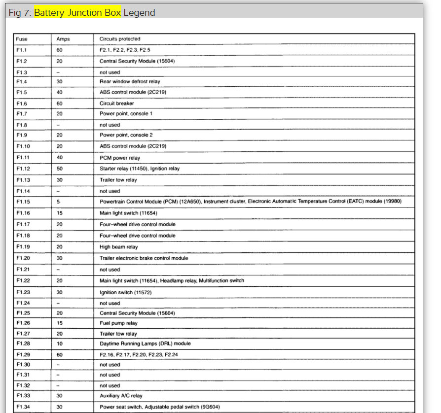

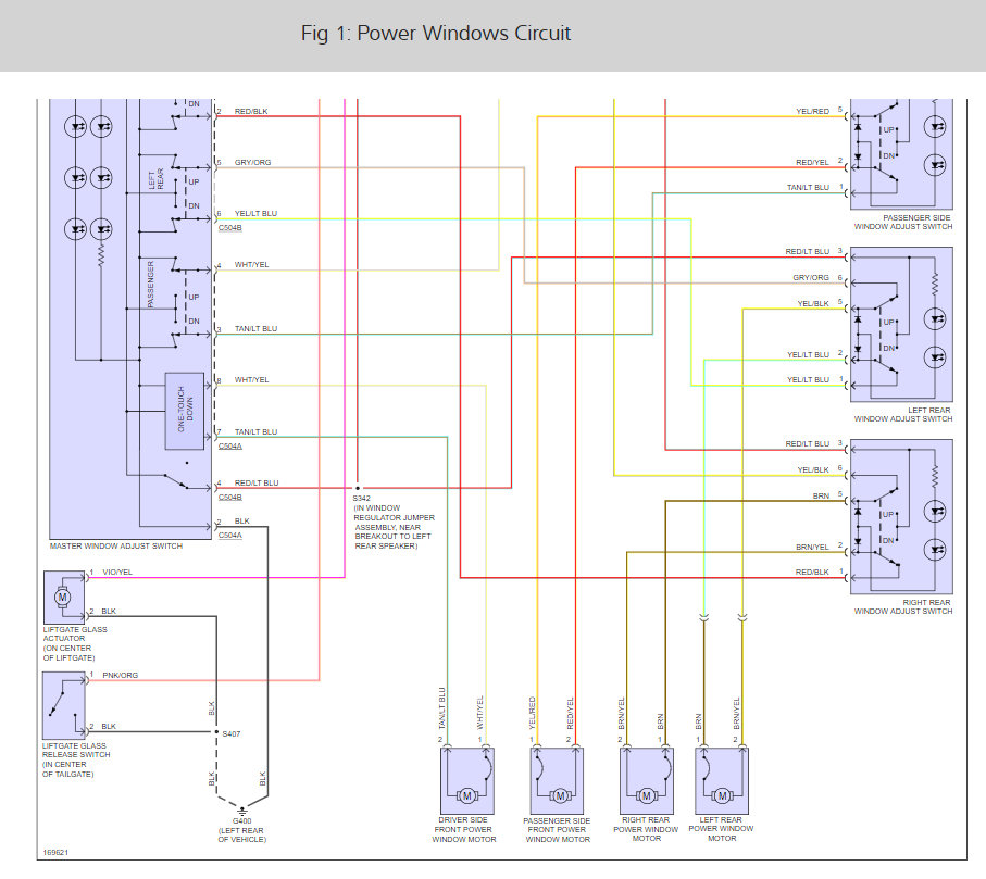

Power windows don't use a fuse, they use a circuit breaker due to the high draw of the motors.The circuit breaker #47 for this and it is in the smart box or under hood fuse box. Here is a guide to help you see where you are losing power and the window wiring diagrams so you can see how the system works:
Check out the diagrams (below). Please run this test and get back to us.

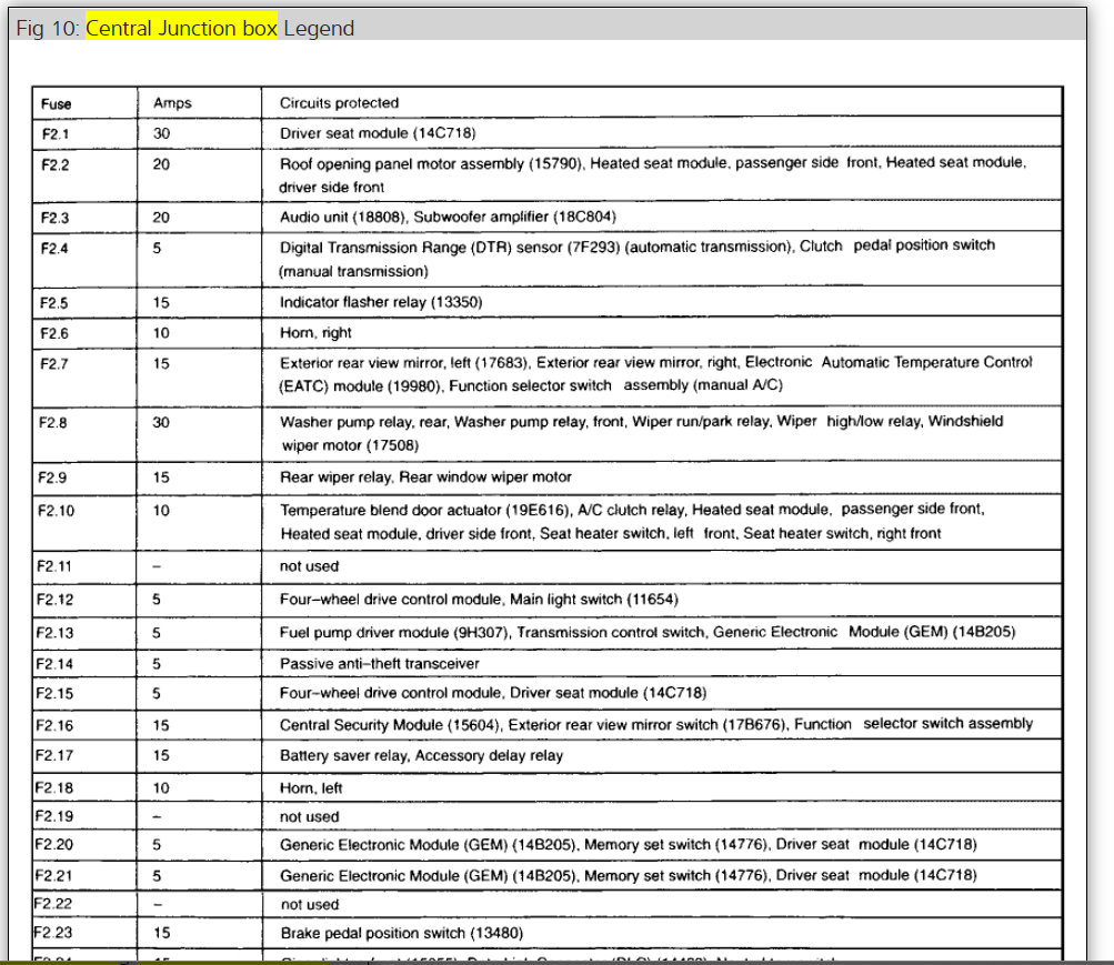

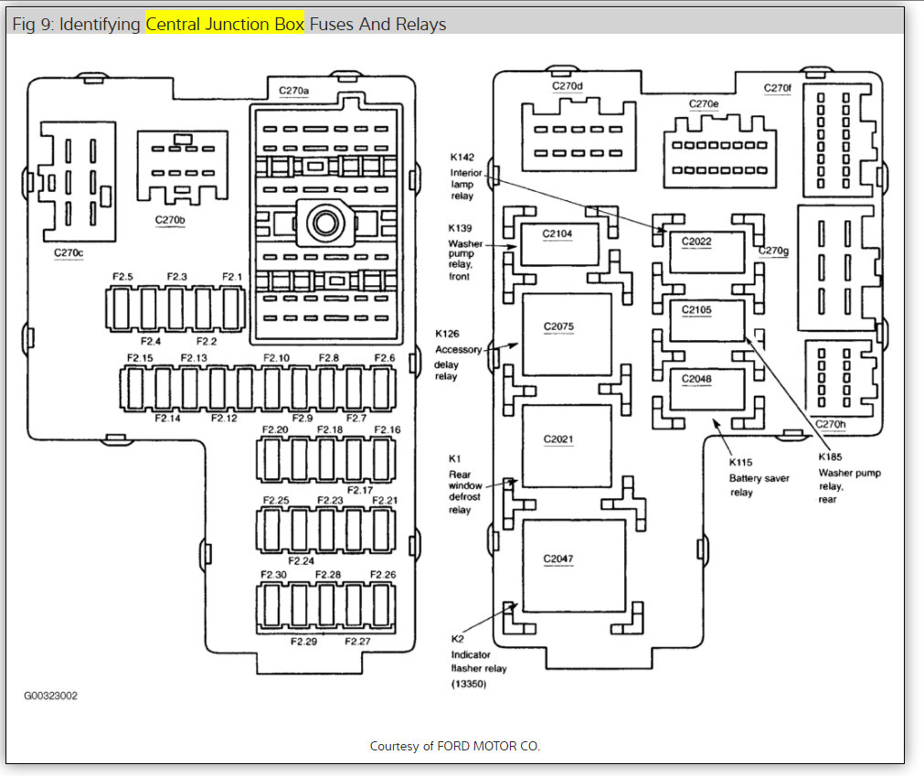

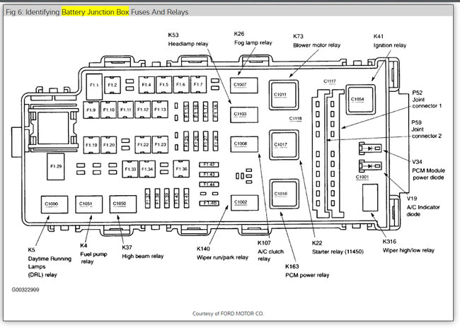

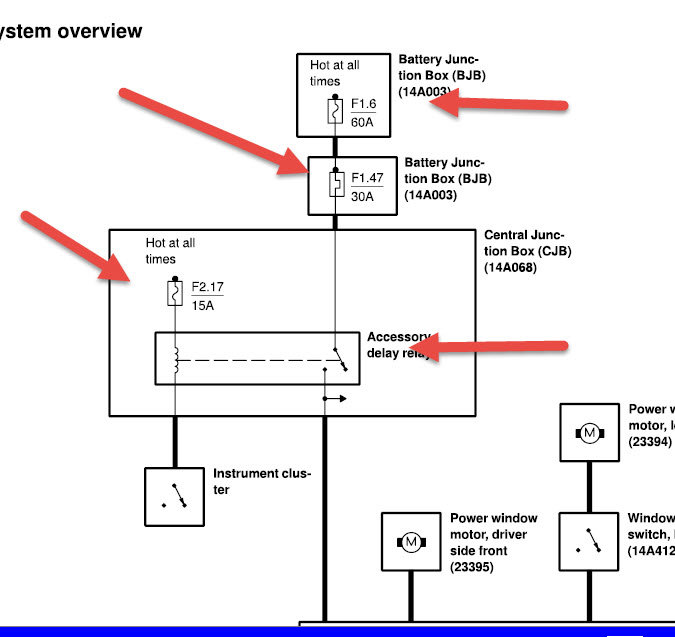

Okay, I went to a Ford manual and got this for you to check. There are three different fuses and a relay to check. See picture.
Mar 2, 2016 at 4:21 AM
HMAC300
  • 48,601 POSTS
It may be that or a wire broken between the door and jamb.
Mar 2, 2016 at 4:22 AM
PAUL.KNOLL1
  • 7 POSTS
Thanks for fuse locations image, I am just going to test all. I will check the wire between the door and jamb.
