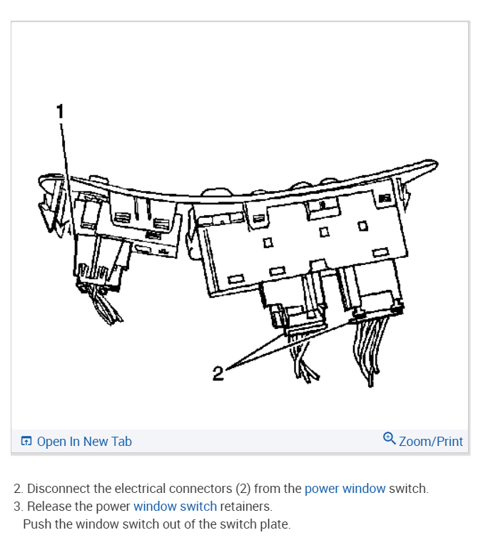

How to hotwire my power windows?
Aug 26, 2023 at 11:24 PM
  • 55,399 POSTS

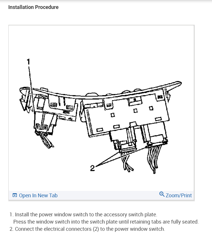

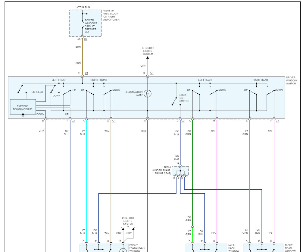

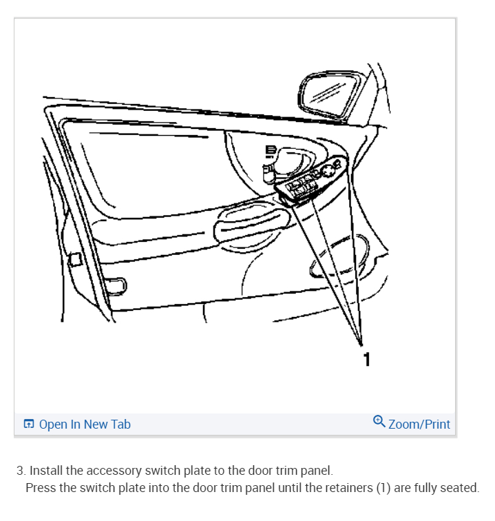

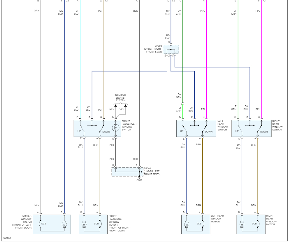

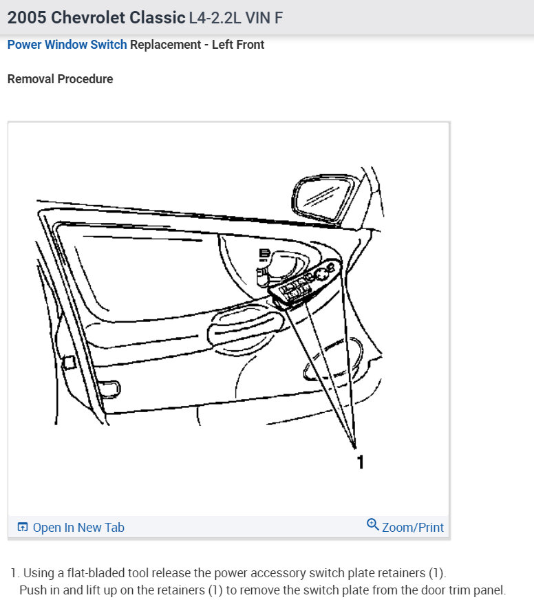

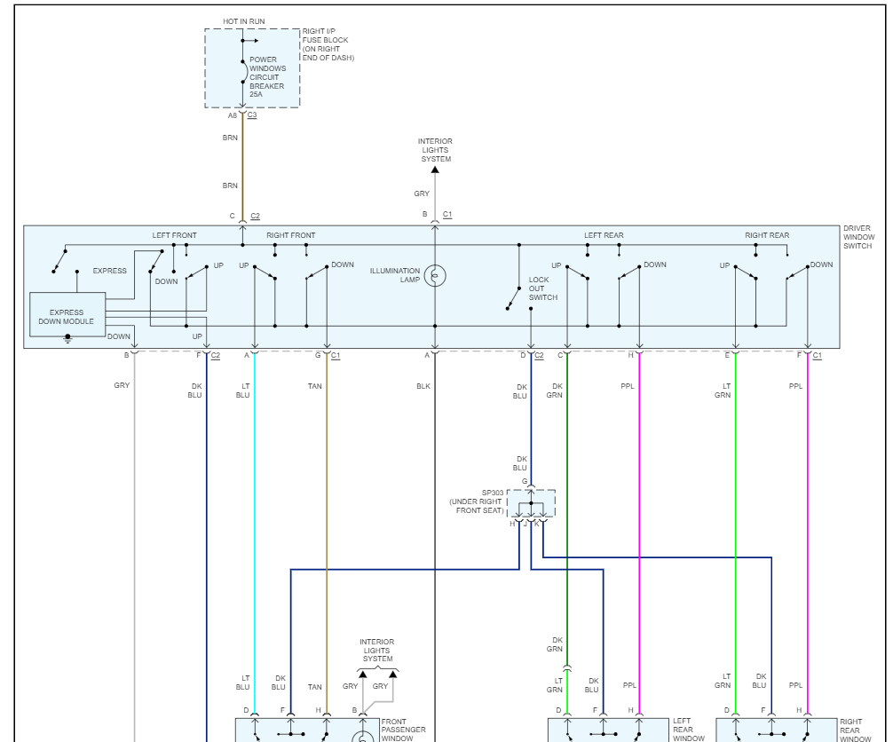

There is no easy way to hotwire the window system, if it is not working here are the window wiring diagrams and a guide to help you test for power and ground of the circuit:
and
https://www.2carpros.com/articles/electric-window-repair
If you have power and ground, it is common for the main window switch to go out. Here is the new window switch from Amazon in case you can use it for $22.00:
https://amzn.to/3EgafKk
Check out the images (below). Please let us know how it goes.
