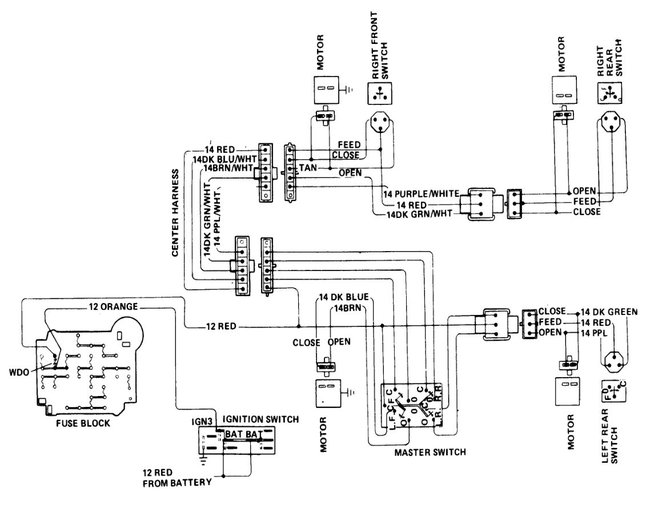

As for the wires, The wiring diagram is below it's a factory one so not as good as it should be. There will be a power and ground going to the master switch. From there it goes to the other doors. If either breaks before the master switch all the windows stop working.

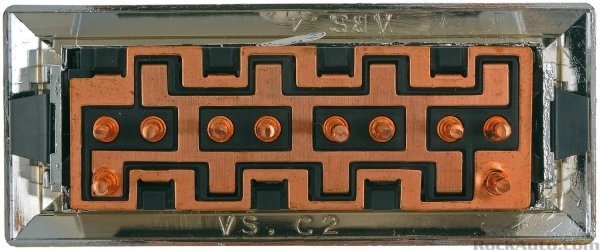

I would get a simple test light. First use it to test the window fuse. Hook it to ground, then touch the tab at each end of the fuse with the key on. You should have power at both ends. Then you test the Red wire at the master switch for power and you test the ground by hooking the test light to power and touching the ground wire. It will be the wire on the opposite side of the switch from the power feed below the 8 pins that feed the windows.
To get the master switch out use a plastic or wood tool to slide into one end and release the spring clip from the door panel. Then the opposite end.
