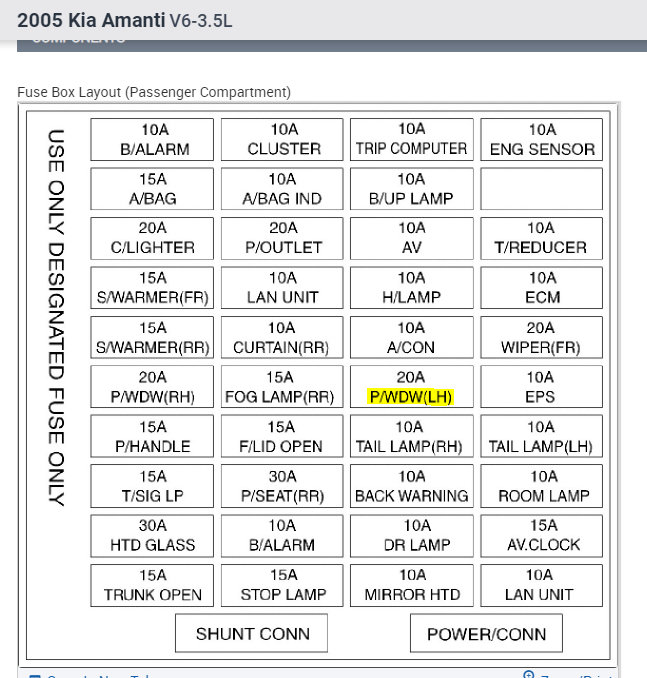

My passenger windows work but the driver side doesn't work. Where is the window fuse located and the relay? What number?
Mar 21, 2022 at 9:02 AM
SQM
Experienced Mechanic
6,383 POSTS

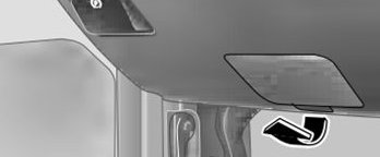

There is a fuse for the driver side window. It is located in the fuse box on the passenger compartment.
It should be a 20A fuse.
I have attached the diagram below for your reference.
If the fuse is good, it could be a faulty switch or motor.
Let me know what you find.
