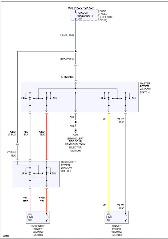

Need to find power relays.
Oct 6, 2019 at 5:00 AM
Experienced Mechanic
18,907 POSTS
I am attaching the wiring diagram below. However, there is no relay for these windows.
There is a fuse and then the switches.
Please use this guide to help with testing the fuse and then the wiring:
Please run through this info and let me know what other questions you have.
