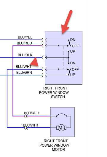

My drivers side power window quit workibg. I must have the window down for work tonight. How do i get it down manually?

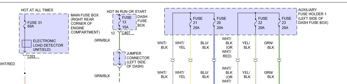

the only thing you can do is to try to power window, but to do that the door panel must come off to power window. try slamming door then try to lower window it sometimes jars motor if that is the problem and will go down or up wherever it is stuck. you can also take the switch out and try jumping form there. See pictures. Also, check all fuses.
