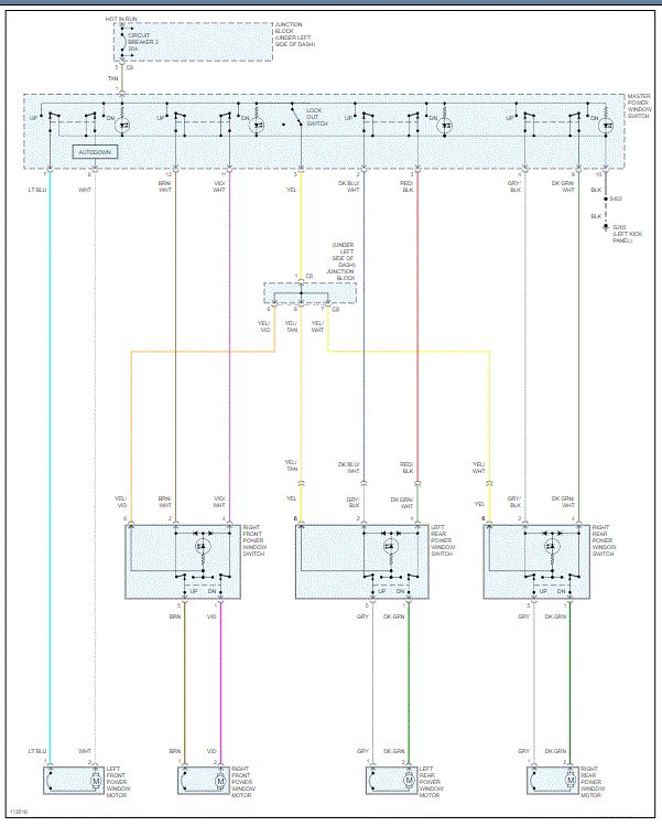

Our power windows all of a sudden stopped working all of them. we replaced the circuit breaker under the dash, but where is the relay for the windows as well as which one is it? Do you have diagram of relays for the car listed above?
Oct 9, 2020 at 2:16 AM
  • 110,240 POSTS
There isn't a relay. Power comes from the circuit breaker you replaced to the main switch on the driver's door and is distributed from there.
I attached the wiring schematic for you to review. See pic 1.

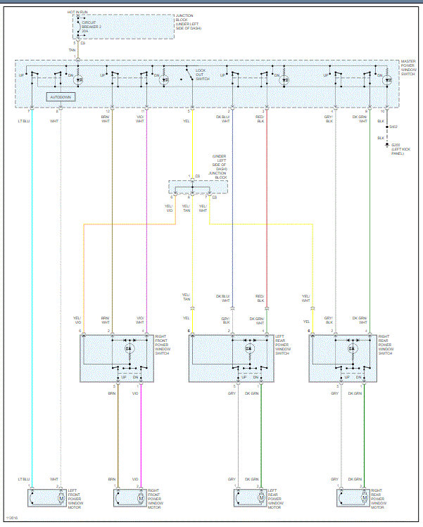

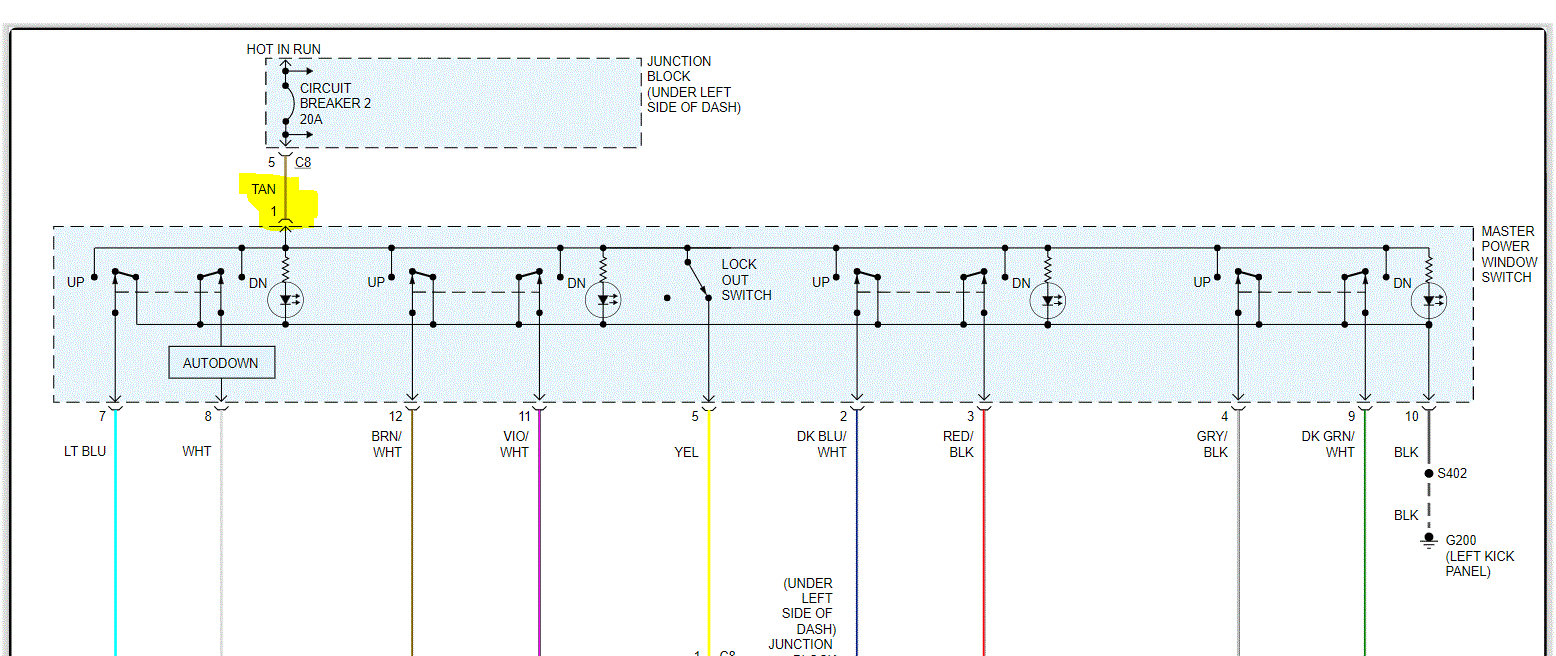

Also, if you look at pic 2, I highlighted the wire which provides power at the main switch (driver's door). The first thing I would check is if that has 12v power to it.
Do that and let me know what you find.
