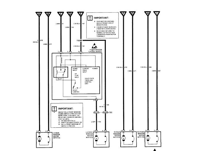

Fixed broken ground wire and have all but drivers door window working. Have power to switch and motor. Took motor off and wired direct and it works both ways. Assuming is has something to do with the auto down module but have no idea where it is.

Good afternoon.

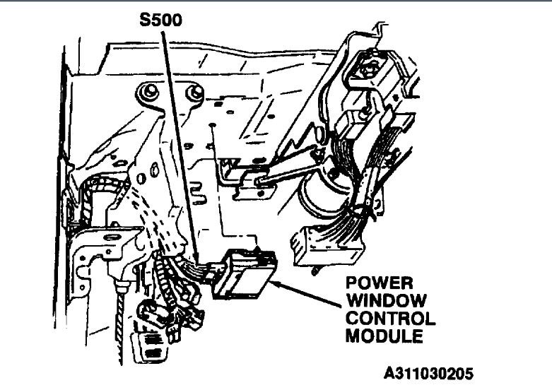

The Power Window Control Module is located behind the left hand side of the instrument panel, near the shroud.

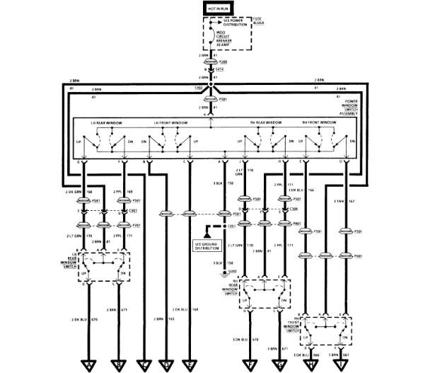

Below is the location. I also posted a wire diagram for you to view.
