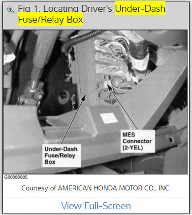

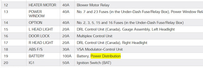

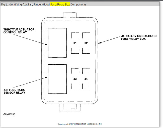

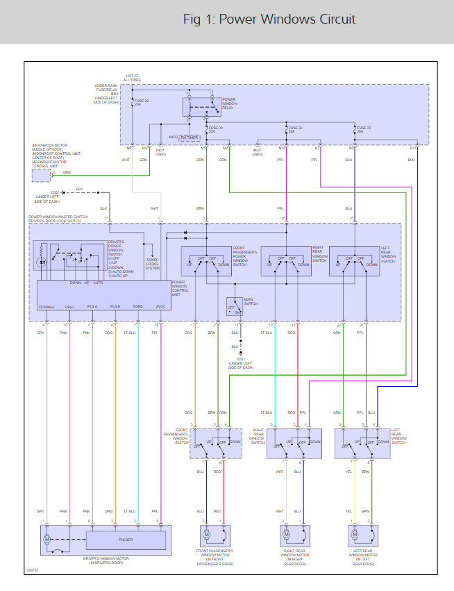

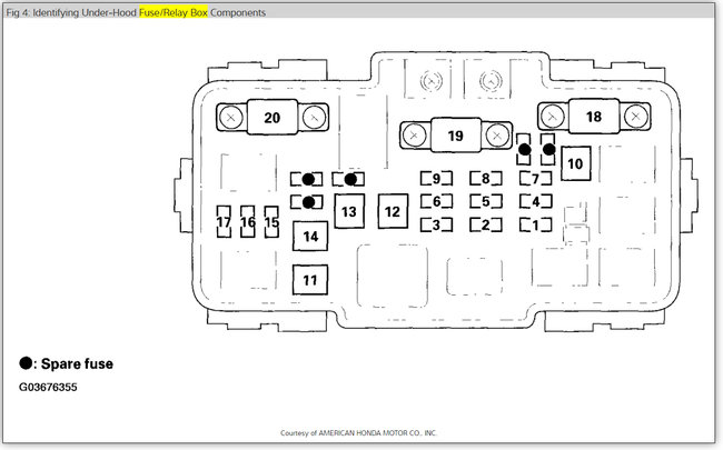

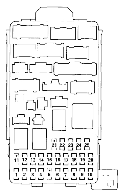

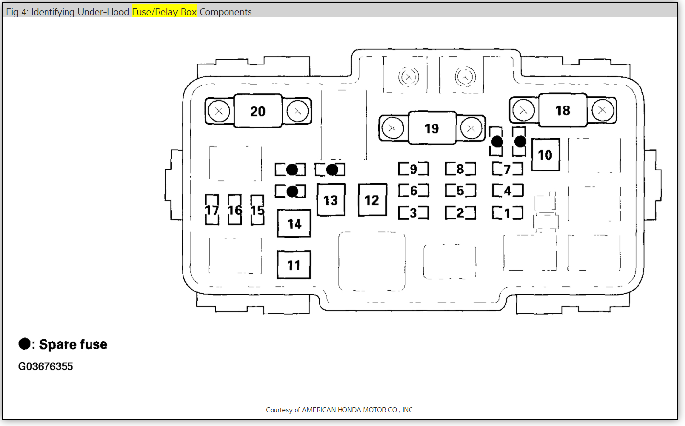

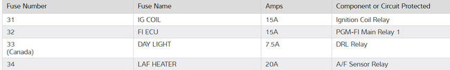

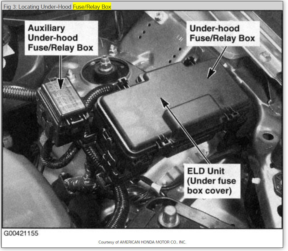

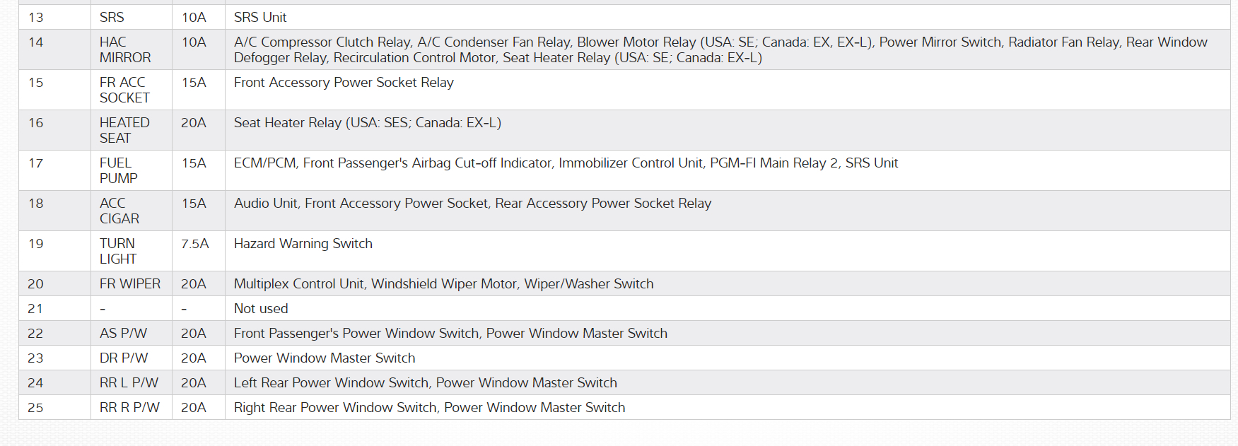

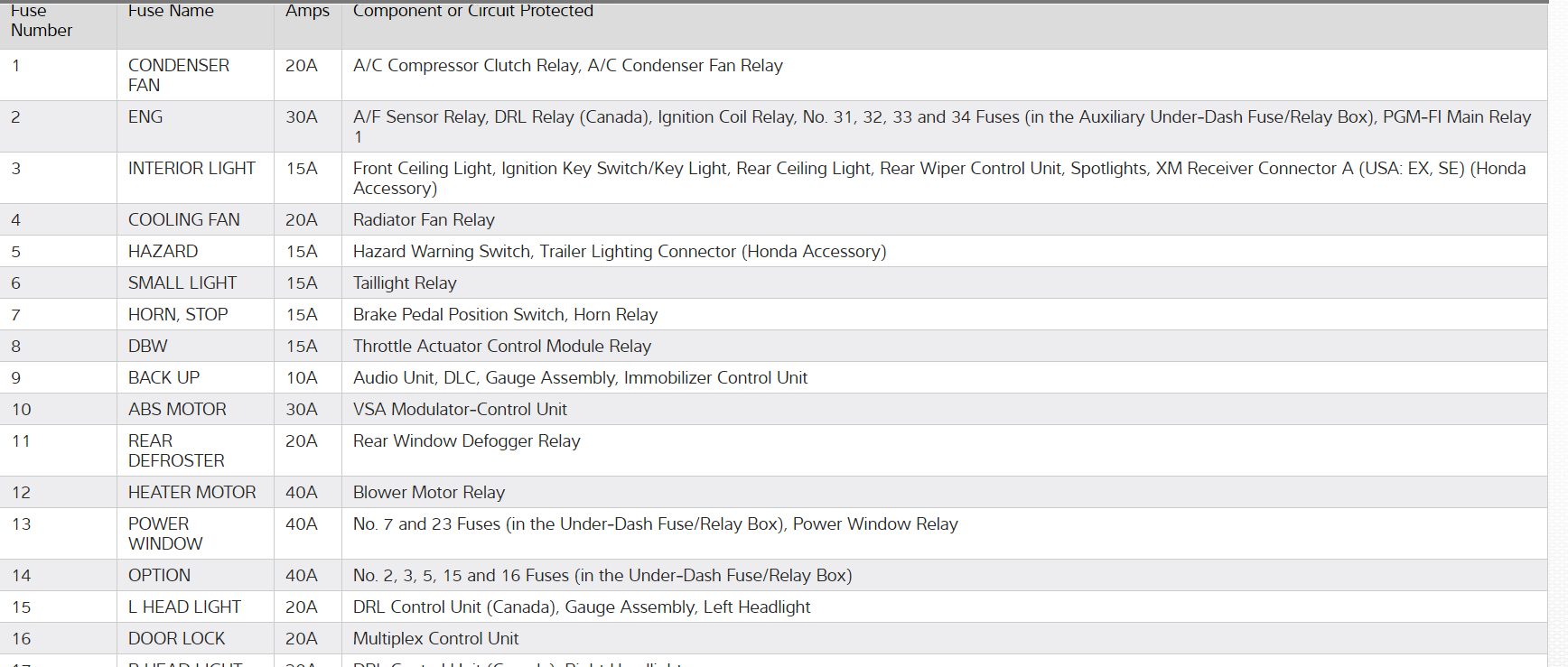

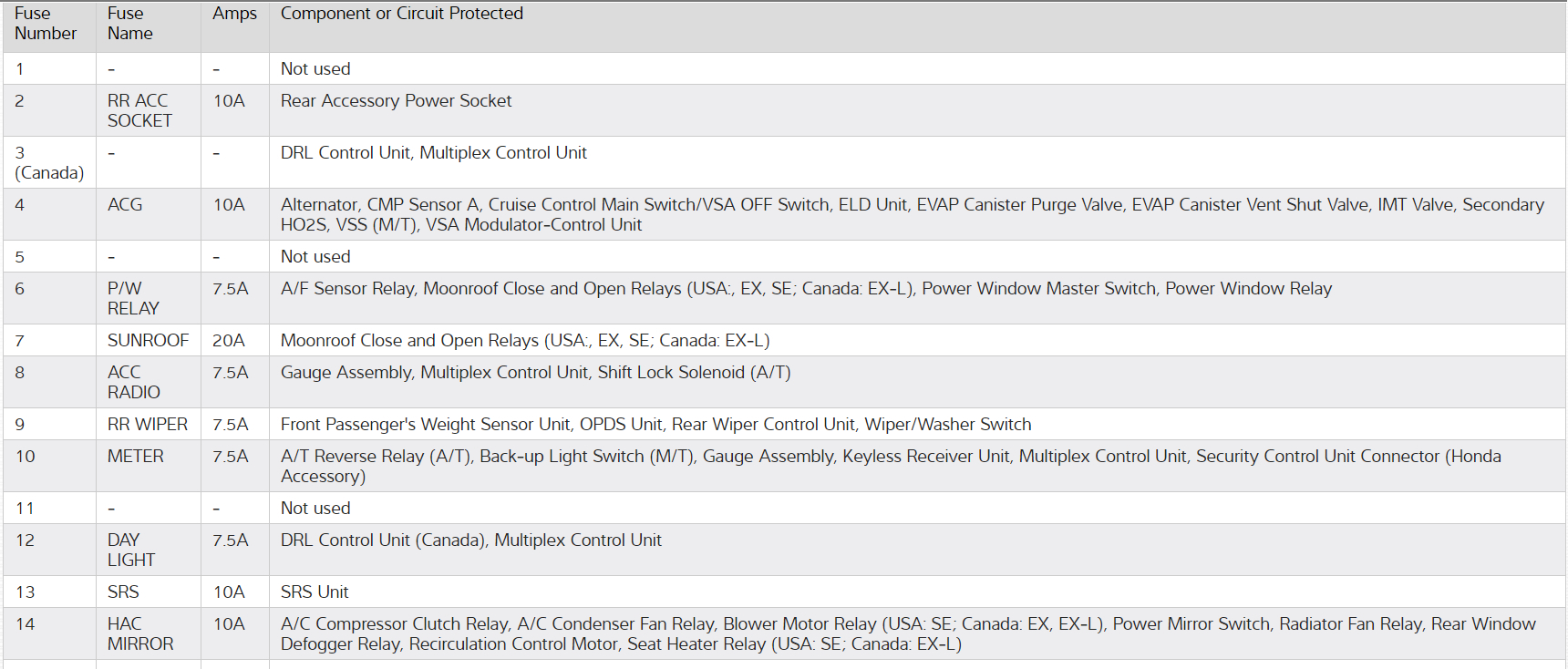

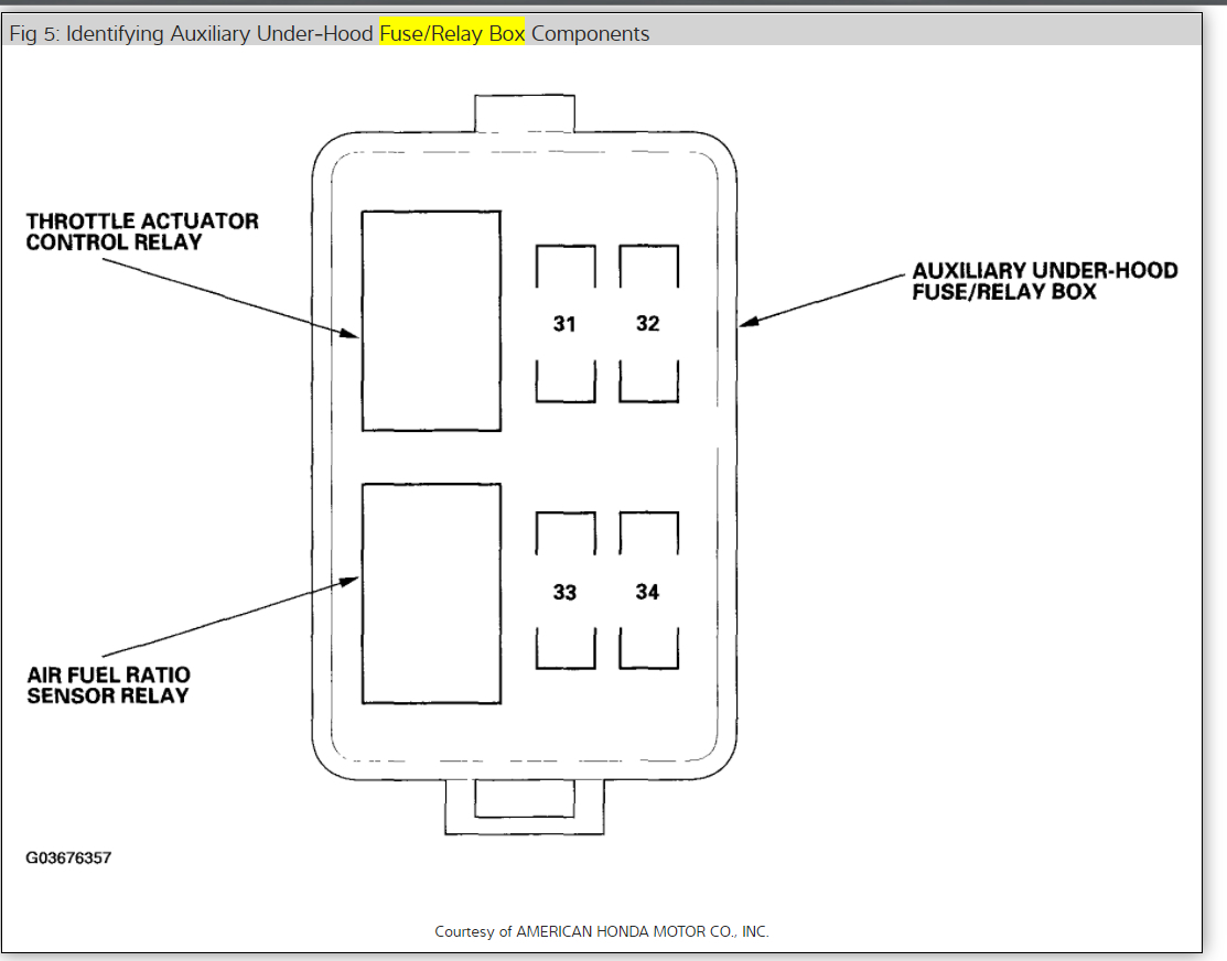

Drivers side window works but all others do not operate. Passenger window half way down but will not go up.
May 16, 2018 at 1:27 AM
  • 55,781 POSTS
This sounds like you have a main window switch or a power window relay that is out because all windows run through it. But to be sure lets run down this guide.
https://www.2carpros.com/articles/electric-window-repair
Here is more information to help you get the problem fixed including the window system wiring diagram so you can see how the system works:
Check out the diagrams (below). Please run this test and get back to us.
