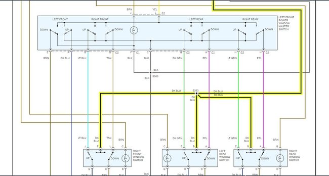

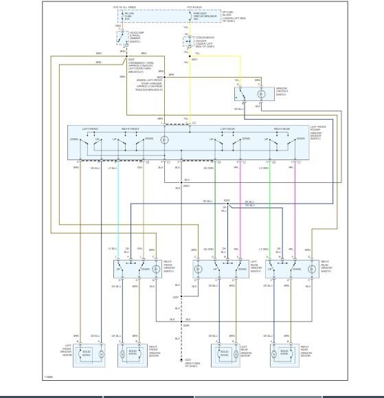

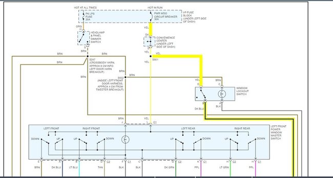

Power windows will only work from driver control.
Apr 20, 2019 at 10:09 AM
Experienced Mechanic
52,796 POSTS
Good morning,
I attached a wire diagram for you to view. Check the fuse listed for power on both sides.
You may still have a master switch issue since the power for the other switches goes through the lockout switch in the master switch.
