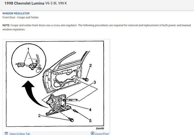

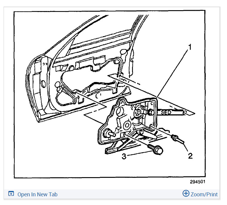

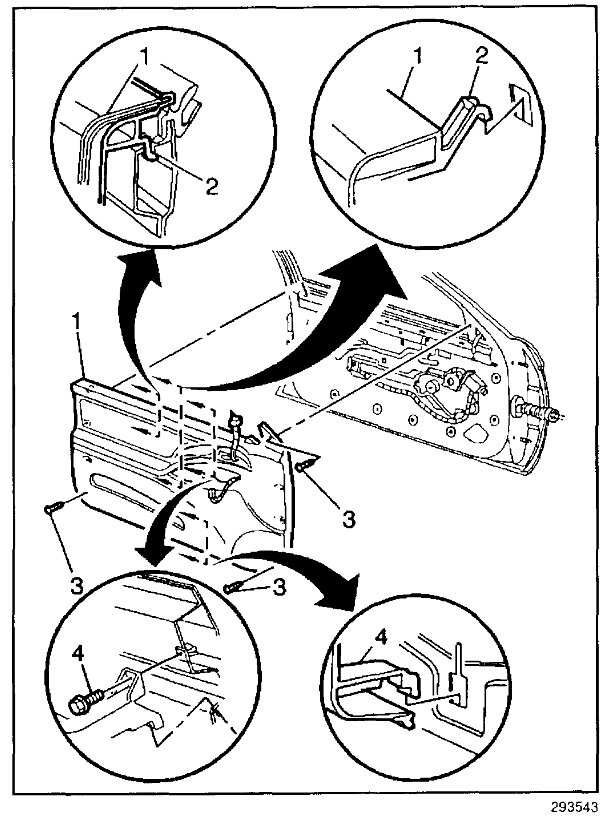

This is super common when the window regulator goes out because it is gear driven, we replace these all the time, here is how the job is done which you will need to remove the door panel to access the regulator. You can get a new one on Amazon, check out the images (below). Please upload pictures or videos in your response of any problems so we can see what to help you with.
