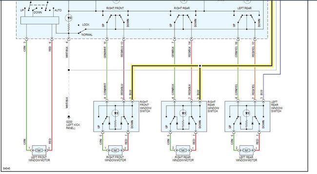

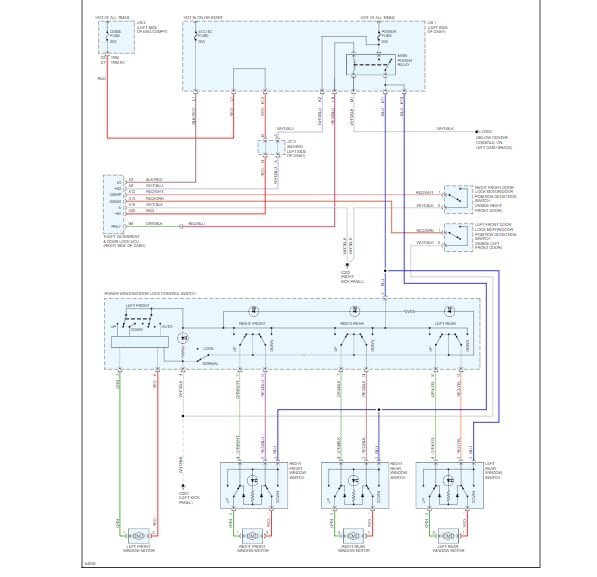

The windows on the drivers side work fine, front and back. However, all of the passenger side does not, from any switch. What might cause this?
Jun 23, 2019 at 3:30 PM
Good morning,
I attached a wiring diagram for you to view. Verify that there is power to the blue wire at the right side switches as shown in the diagram.
