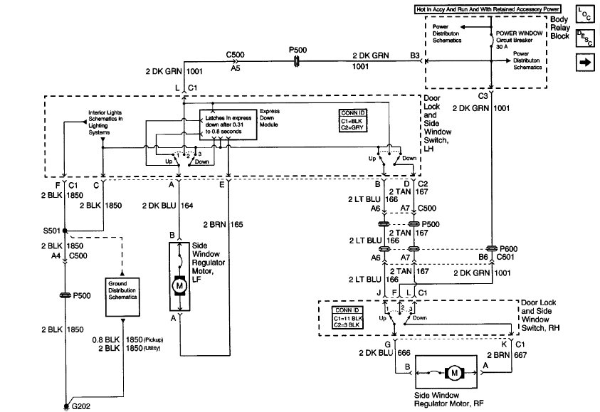

power windows all work from drivers side door only, where is the fuse for the windows and were is the dim relay?

Since all windows work from the drivers side, I assume none work with there own switches?? is that correct??
I will get a diagram for you.
Dim relay?? please explain.
Mar 3, 2018 at 1:15 PM
Diagram below. Do you have a voltmeter or test light to check for power at the passenger side switch??
