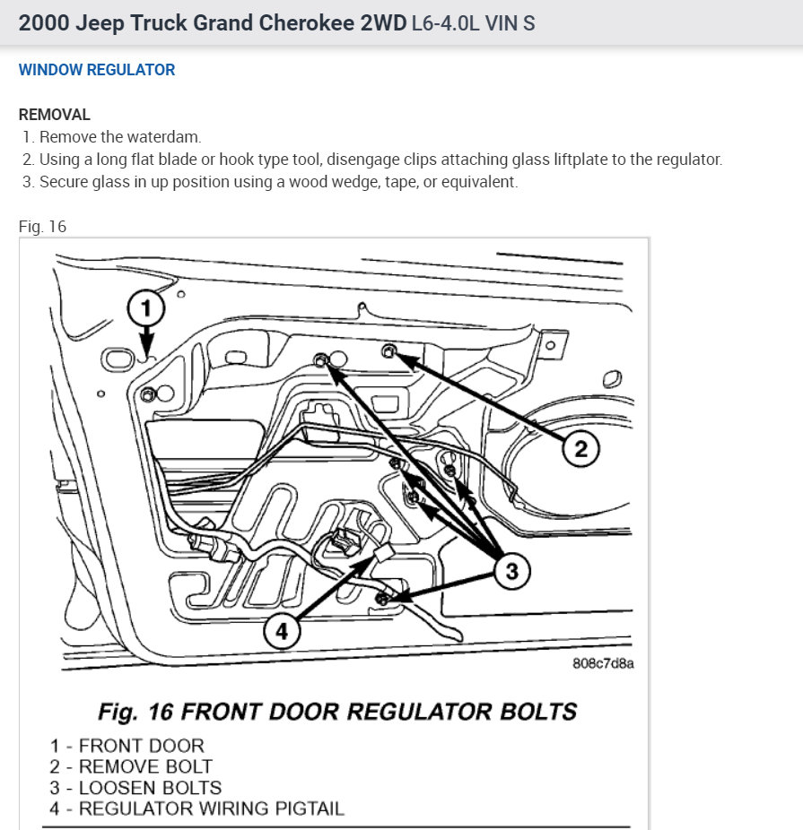

The passenger side rear window keeps sliding down, it will not stay up.
May 17, 2022 at 9:19 AM
  • 55,732 POSTS

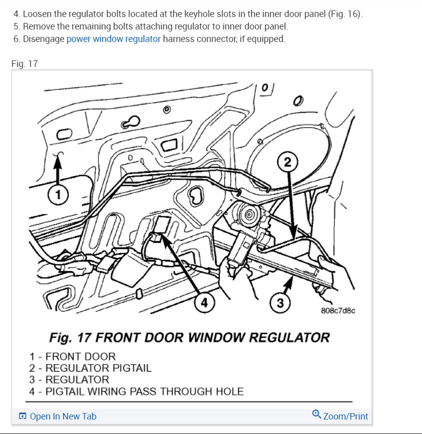

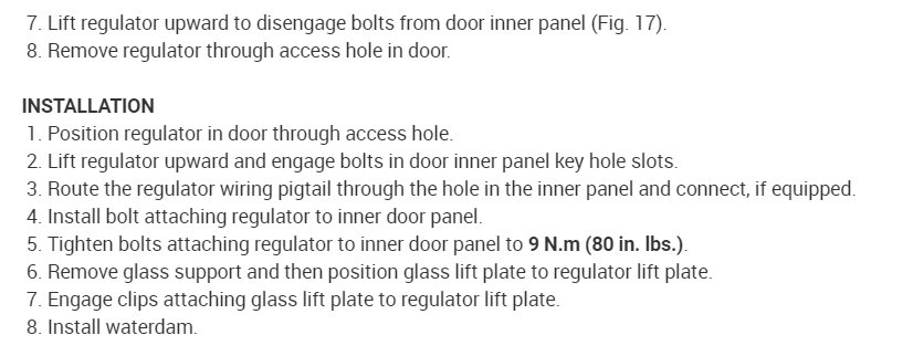

This happens when the window regulator needs to be replaced. There is a set of cables that go bad which a new window regulator will fix, this generic guide and video will help show you how to fix it with instructions for your car in the diagrams below. You can get the new window regulator from Amazon or Rockauto.com
https://www.2carpros.com/articles/how-to-check-and-replace-a-electric-power-window-motor
