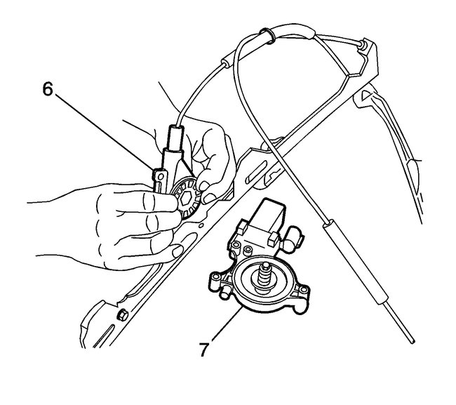

The passenger wide window won't work. The motor is good and so is the switch. The cables are in tact and the window is on track. Is sounds like a stripped gear. Where's the gear and what do I do to fix it?
Apr 27, 2020 at 11:36 AM
  • 110,194 POSTS
If you hear the motor running and making a sound like it's stripped. there is a gear that runs a cable that is likely broken. Have you removed the door panel to inspect?
Apr 27, 2020 at 11:57 AM
PACKERS27
  • 207 POSTS
I have taken the panel off and seen the motor and cables, but I can't see gears.
Apr 27, 2020 at 12:14 PM
  • 110,194 POSTS
I attached a pic for you to see. Number 6 in the pic is the gear spool and 7 is the motor.

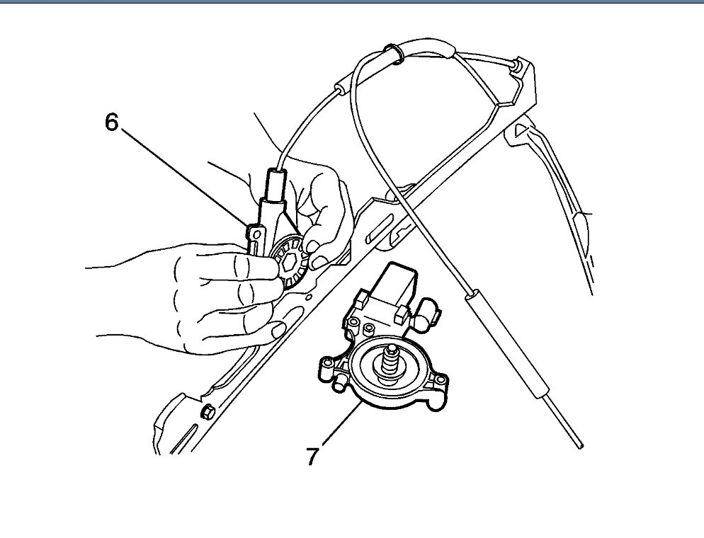

1. Raise the window.
If the window motor is inoperable, remove the window to gain access to the window motor retaining screws. See: Front Door Window Glass > Removal and Replacement
2. Remove the power window module. See: Front Door Window Regulator > Removal and Replacement

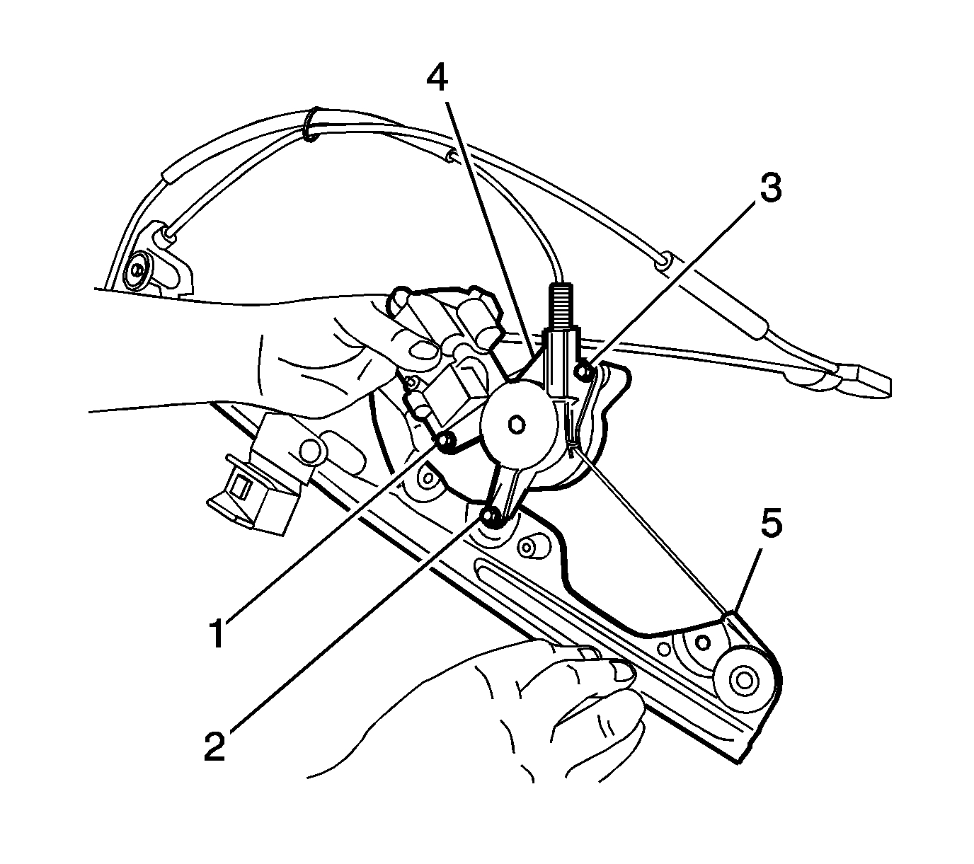

3. With the window regulator on the bench, remove fasteners one (1) and two (2) which will disconnect the drive housing and motor (4) from the rail (5).
pic 2
Important: Do not allow cable gear/spool to come out of the housing. As the motor slides out of the gear/spool, hold the gear/spool into the housing with your fingers. The spool will unwind if it comes out of the housing.
4. Holding the motor and housing together, remove fastener three (3).
pic 3
5. Slide the motor partially out of the gear/spool allowing finger access to the gear spool (6). Hold the gear/spool into the housing and remove the motor (7).

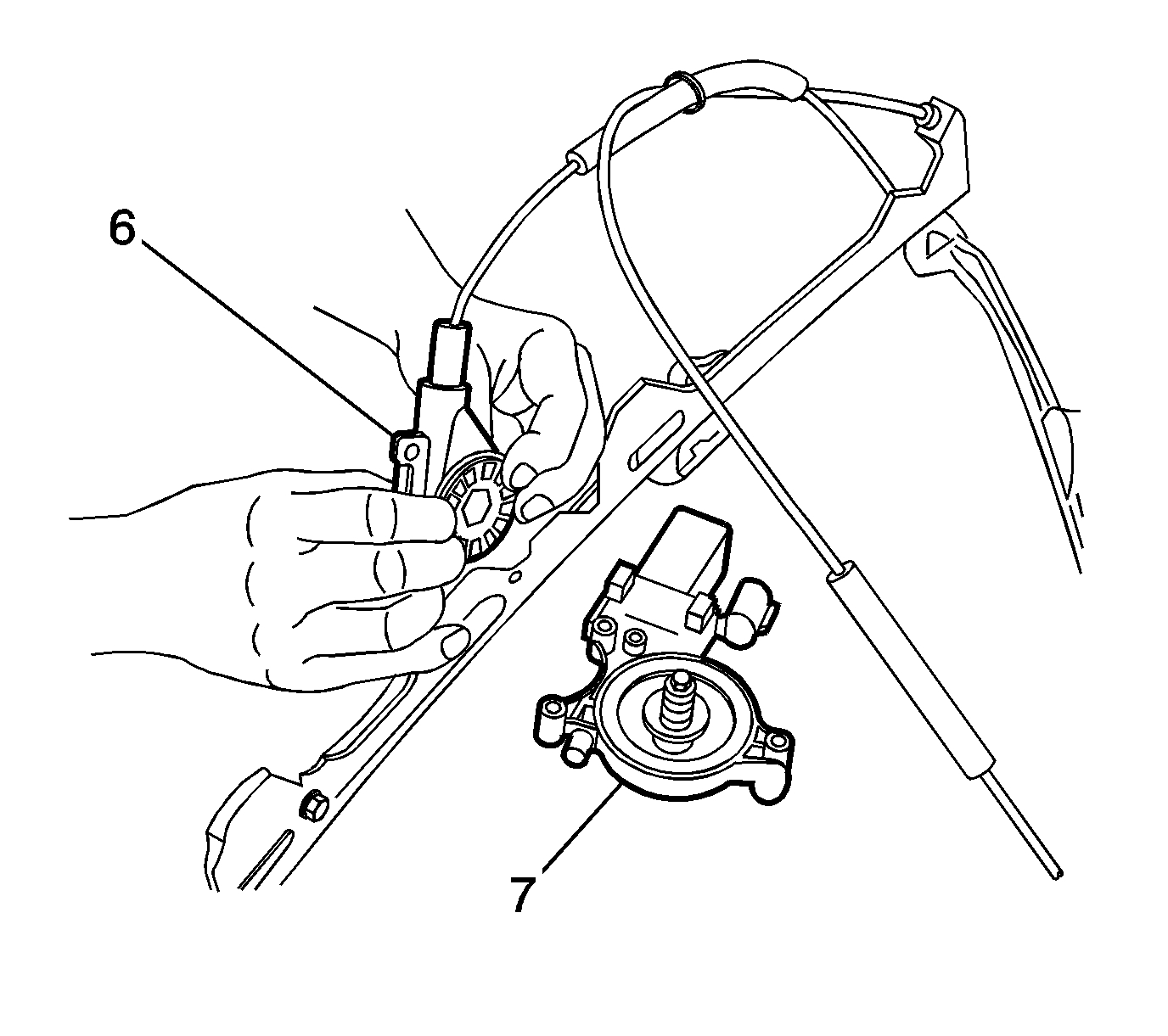

1. Install motor by aligning gear teeth and mounting points simultaneously, pushing the motor into the gear/spool and installing the motor to housing fastener first (3).
pic 4
2. Slide the motor and housing assembly (4) onto the rail (5) and install the fastener number two (2).
Notice: Refer to Fastener Notice. See: Windows > Vehicle Damage Warnings
3. Rotate the motor and housing assembly to align the attachment point for attachment number one (1) and install the fastener.
Tighten the bolts to 5 N.m (44 lb in).

So does this whole assembly have to come out of the door?
Apr 27, 2020 at 8:43 PM
  • 110,194 POSTS
If you plan to replace the motor, yes. Once it is out, you can separate the motor from the spool gear.
