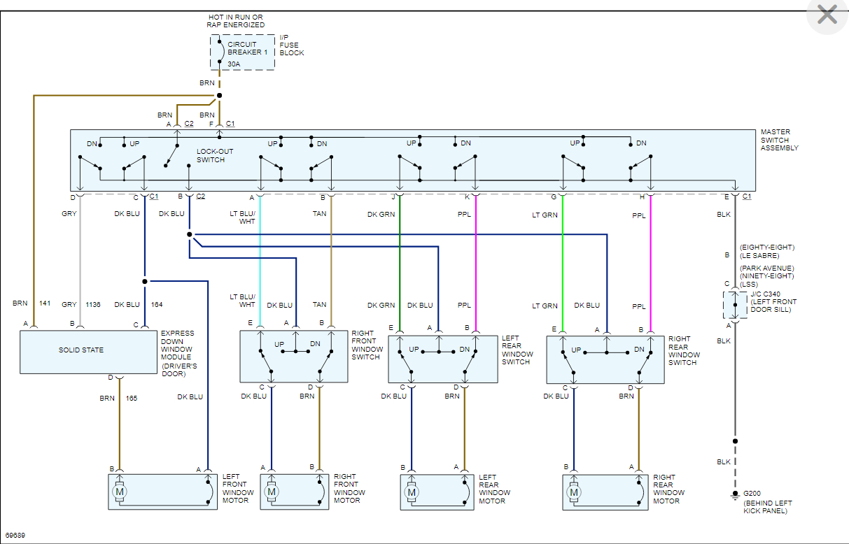

While trying to reinstall the passenger door window control panel the wires disconnected and I can’t figure out which order they go back in.

I have attached the wiring schematics for the power windows.
Let me know if you need any other info.

That was exactly what I needed. Thank you!!
