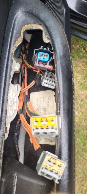

2011 dodge avenger drivers side window won't go down I think the guy I bought car from changed switch other 3 work not drivers when I took switch out they're is a black plug with a red tab that is not hooked up to anything and I can't see anywhere for it to plug into

I believ that plug is for the main power supply you need pull off the panel then you should see another connector right away unplugged it coming in with the Maine wiring from the body tward the front of the door and that might be the repair. Let us know what you find hope this helps good luck .

The driver side windo motor not getting power onece you take off tye panel youl see everything right awy reconnect anything unplgged should solve that problem
