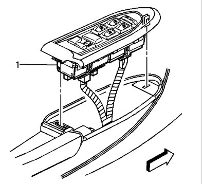

Drivers side front drivers power window switch started to stick when only putting window down. I want to replace the switch before it breaks. I was told that when installing switch you have to get it programed from the dealer. Is this true?

No, the window switch (drivers door module) will not need programming according to the manual, just replace the switch and everything works just fine without programming. Check out the images (below). Let us know if you need anything else. Ken
