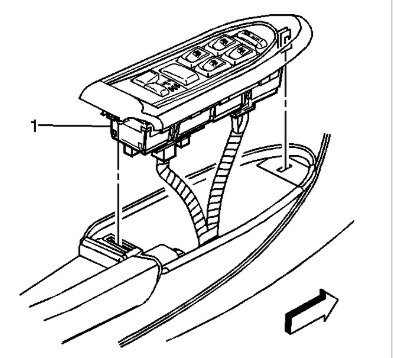

Power Window Switch get it programed?
2007 GMC ENVOY
136,549 MILES • 4.2L • V6 • 4WD • AUTOMATIC
STEVE620
  • 70 POSTS
Drivers side front drivers power window switch started to stick when only putting window down. I want to replace the switch before it breaks. I was told that when installing switch you have to get it programed from the dealer. Is this true?
Feb 11, 2026 at 6:53 AM
  • 55,433 POSTS
No, the window switch (drivers door module) will not need programming according to the manual, just replace the switch and everything works just fine without programming. Check out the images (below). Let us know if you need anything else. Ken
