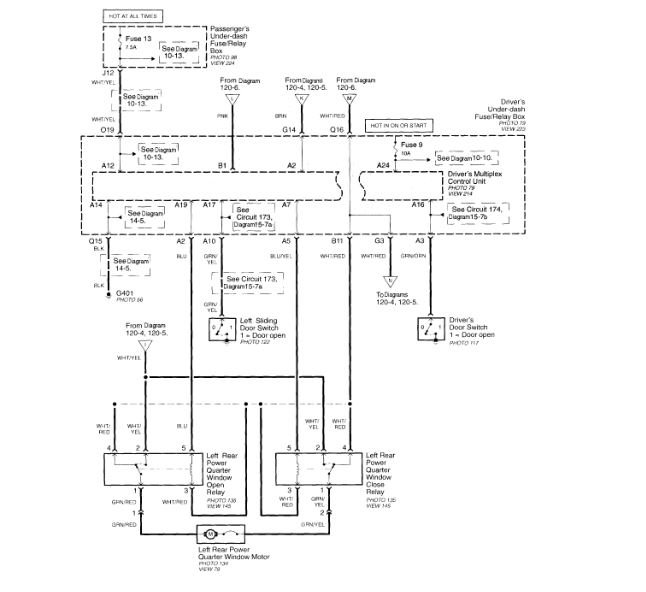

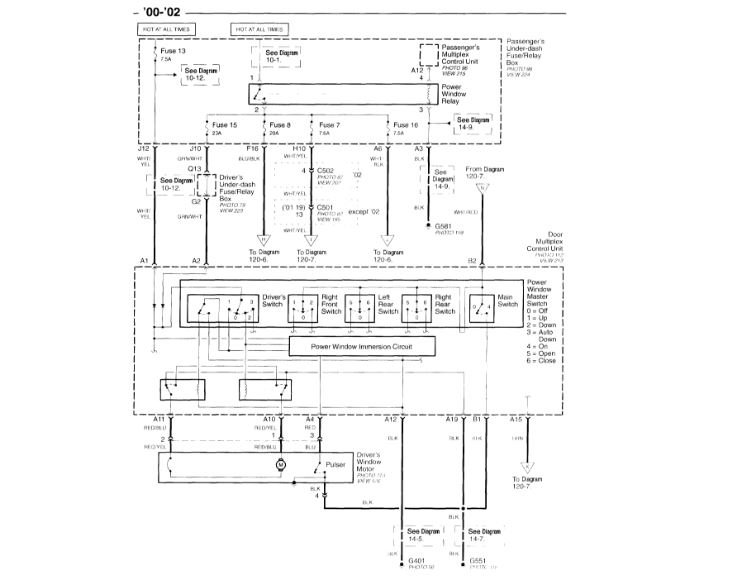

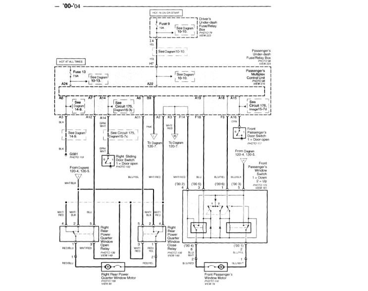

Can I get detail about master switch power window wiring. Where the positive and negative etc.,?

Good morning.
I attached all three wiring diagrams for you to view with pin identification of each part of the system.
Let me know if you have any follow up questions.
