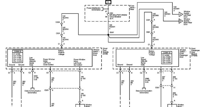

All other switches work on power switch but drivers window does not work.

Good afternoon.
The first thing you need to do is to check for power to the switch. I will attach a wiring diagram for you to view for the wiring to test.
Check the red/white tracer for power to the switch.
You need to pop up the switch from the panel and test with a voltmeter or test light.

The switch is now working, the connections were loose. Thank you very much!

Good find. Glad it works.
