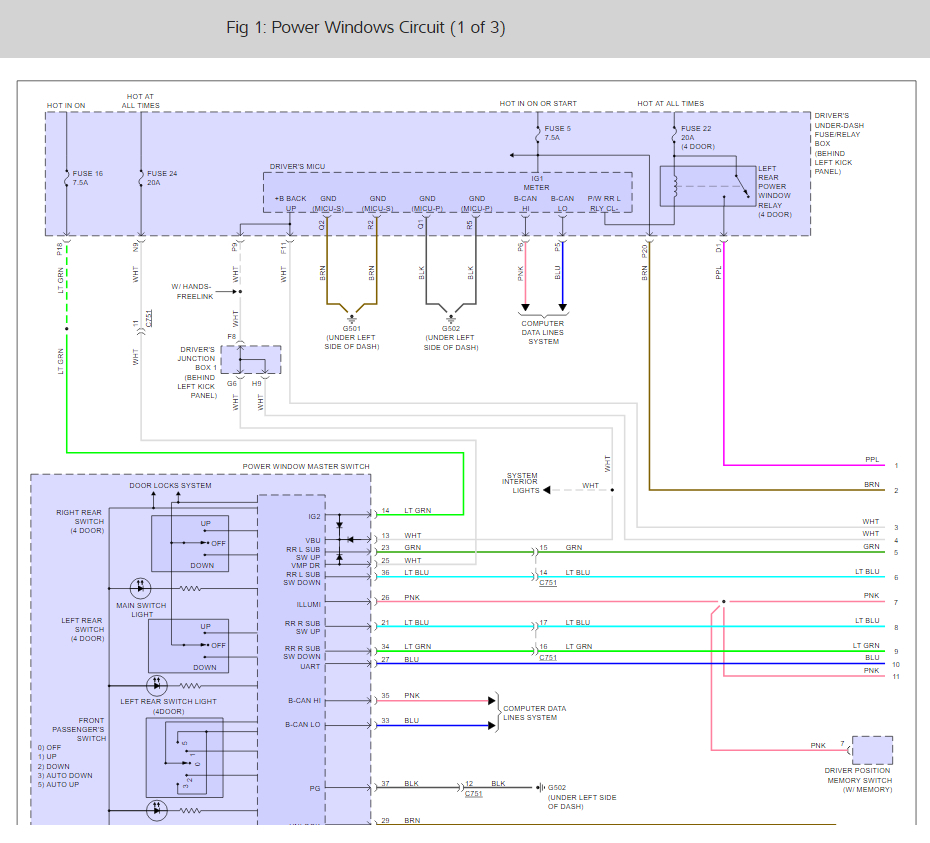

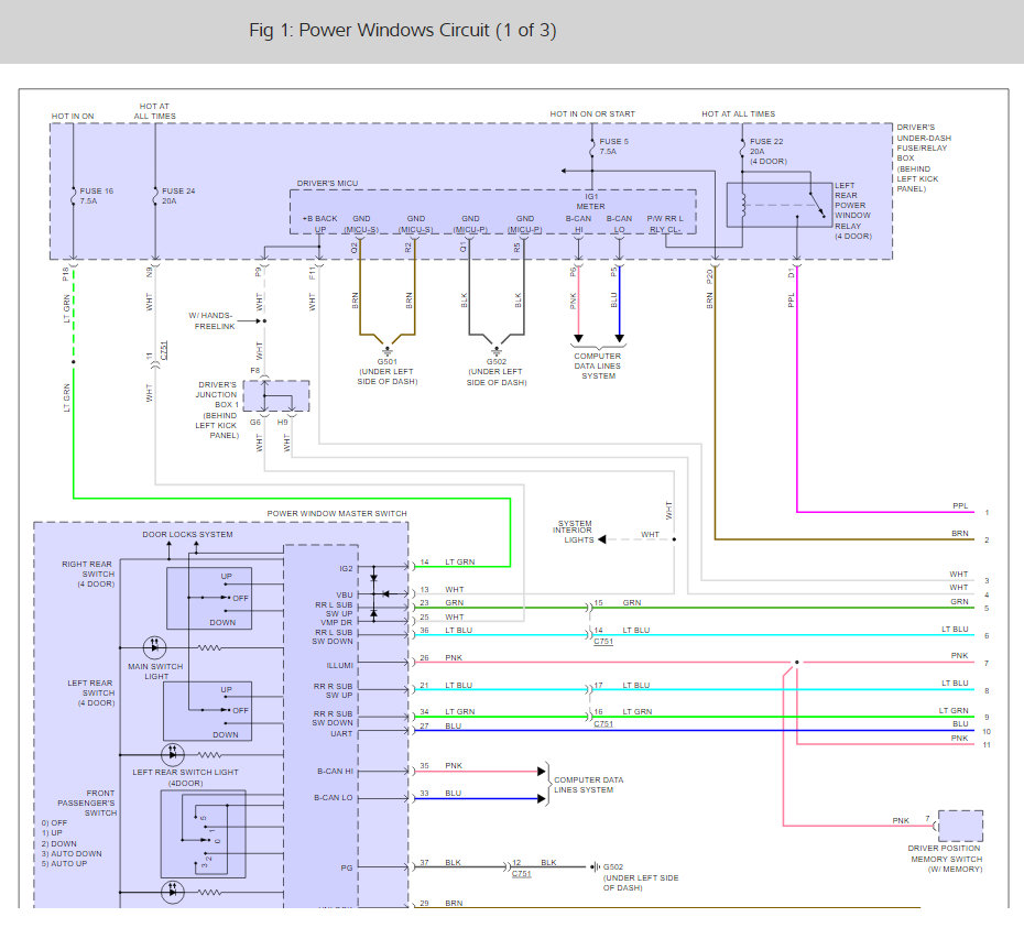

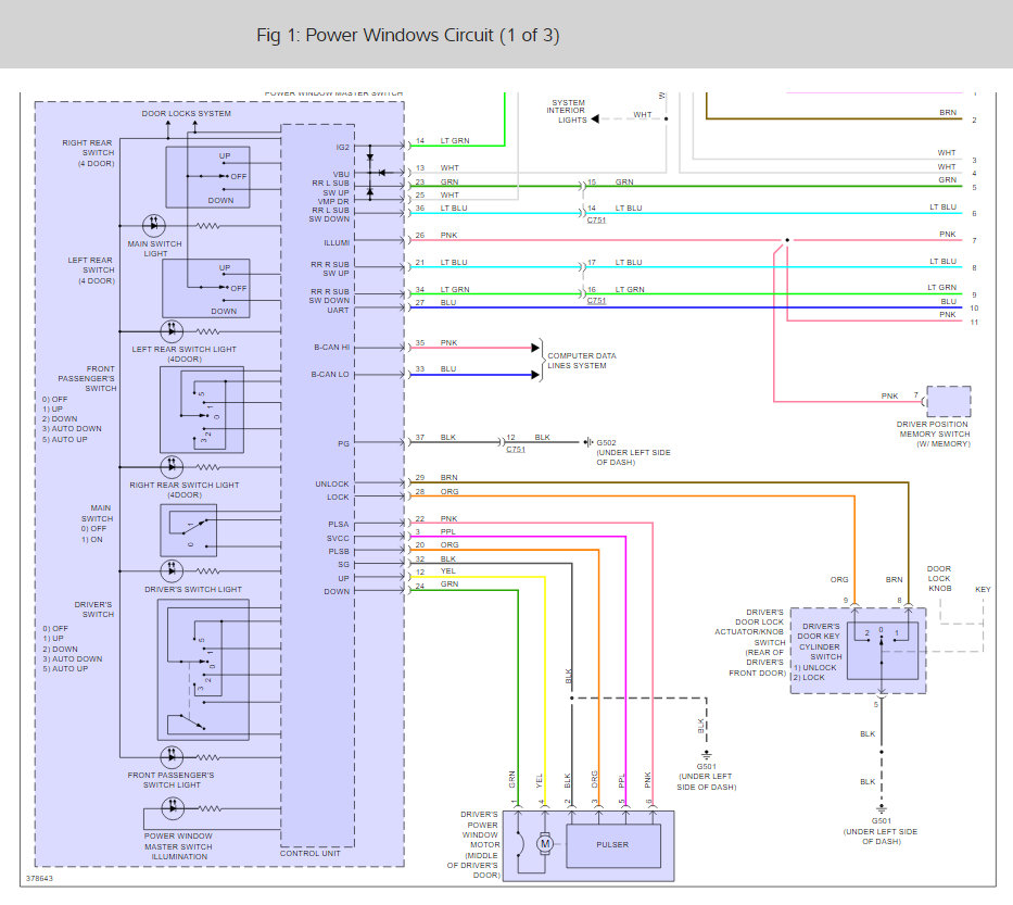

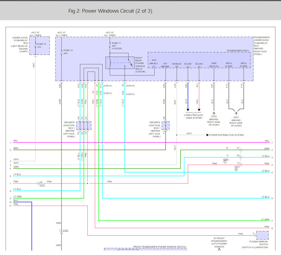

This is an Accord EX-L, V6. All power windows work from their seats and from the driver's seat. The remote locks and unlocks the doors. This car used to have the function to open the windows and sunroof by double click and hold the remote unlock button or by double-turn and hold the key in door. This function no longer works. There is no problem with travel. I have gone through the power window master reset process and that did not help. Is this a bad power window master switch?
Aug 3, 2017 at 2:01 AM
  • 55,673 POSTS

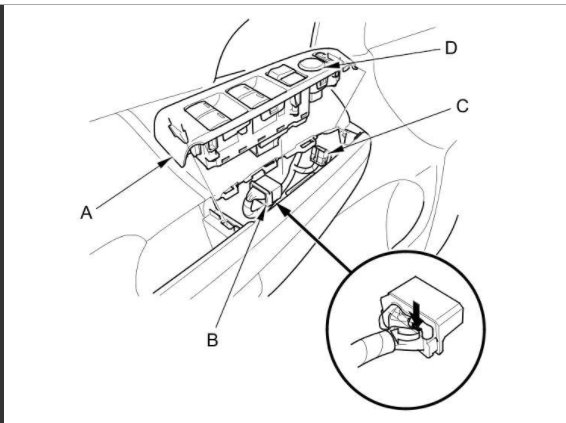

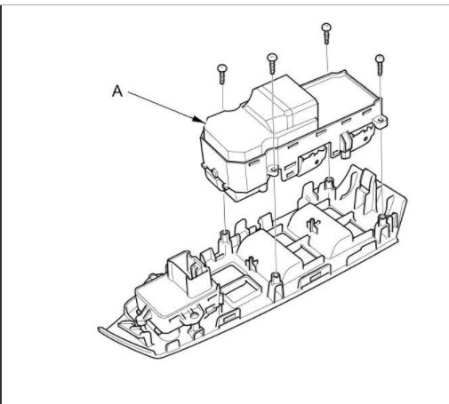

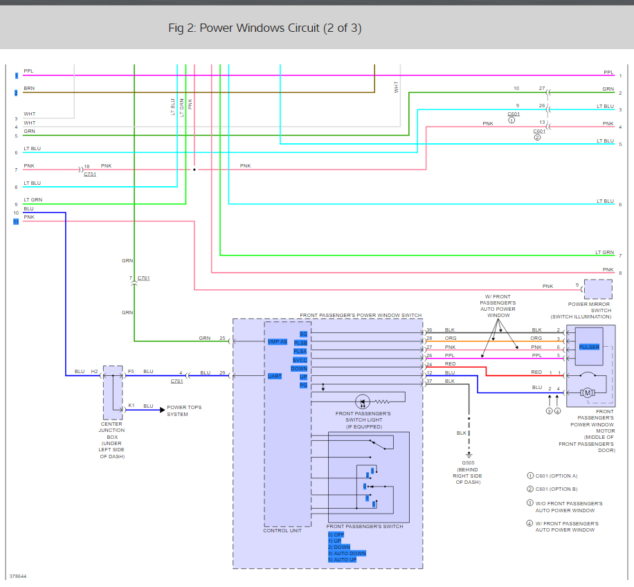

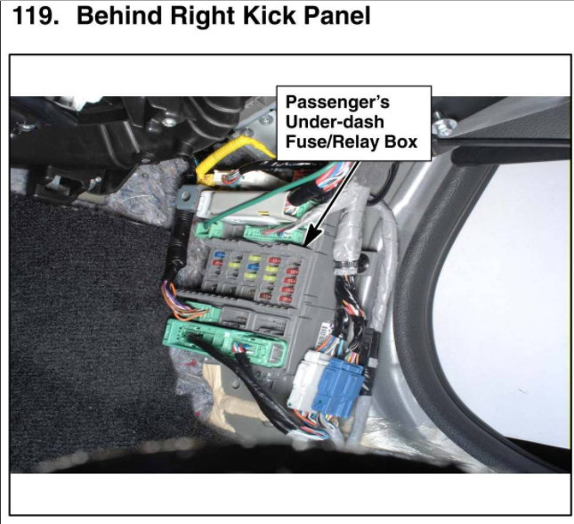

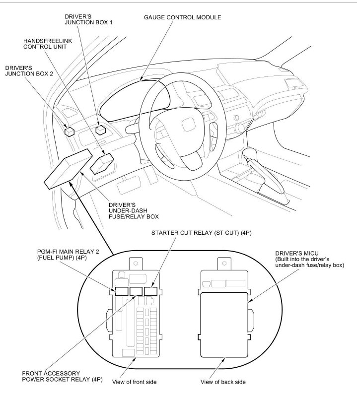

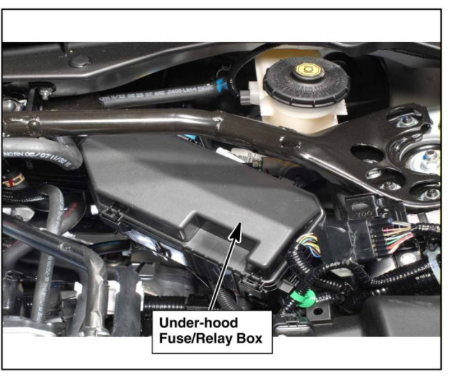

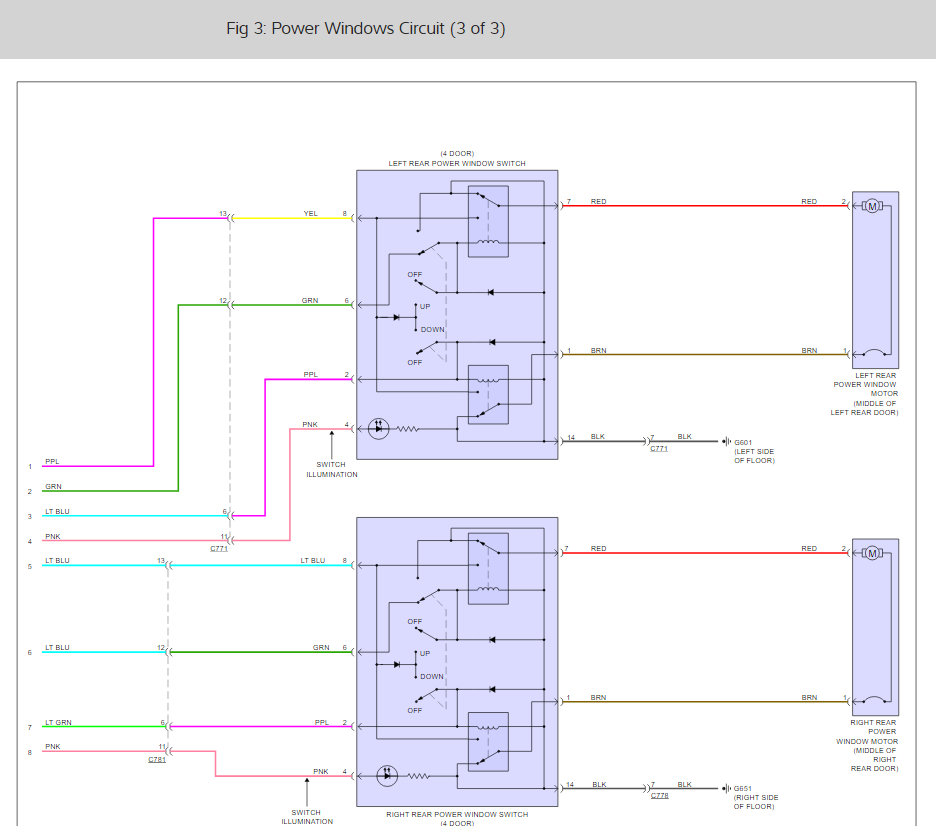

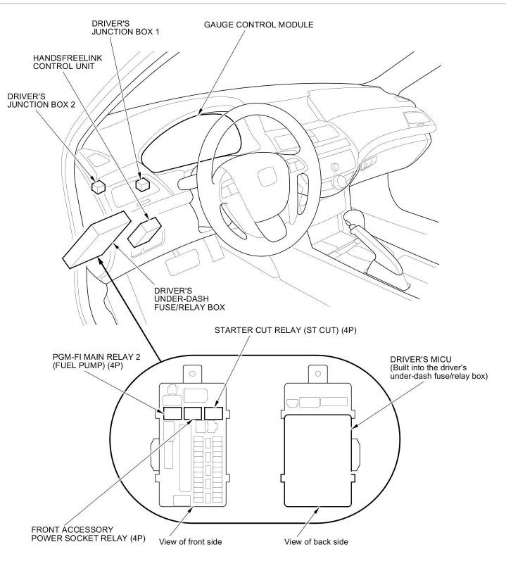

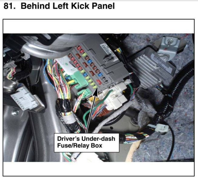

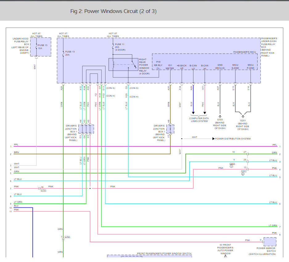

It does sounds like it is the main switch which is the control unit for the system but to be sure we should do some tests like check the fuses. Here are some guides that will help you confirm the problem along with some diagrams (below) to help with the repair.
and
and
https://www.2carpros.com/articles/electric-window-repair
Check out the diagrams below
Please let us know what happens, we are interested to see what it is.
