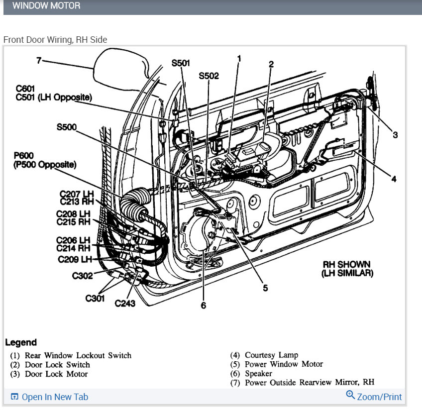

The passenger side and door locks still work. I replaced the switch that didn't fix the issue . If the passenger side window still works from drivers side control would it be in the window motor ? Or what may be my next option?

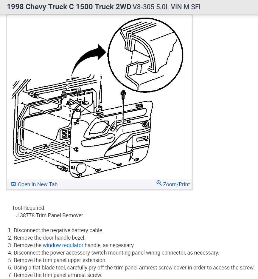

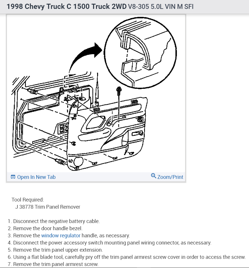

It does sounds like the window motor is out. To be sure here is a guide to show you how to test with diagrams below to show you how to replace the window motor below:
https://www.2carpros.com/articles/electric-window-repair
